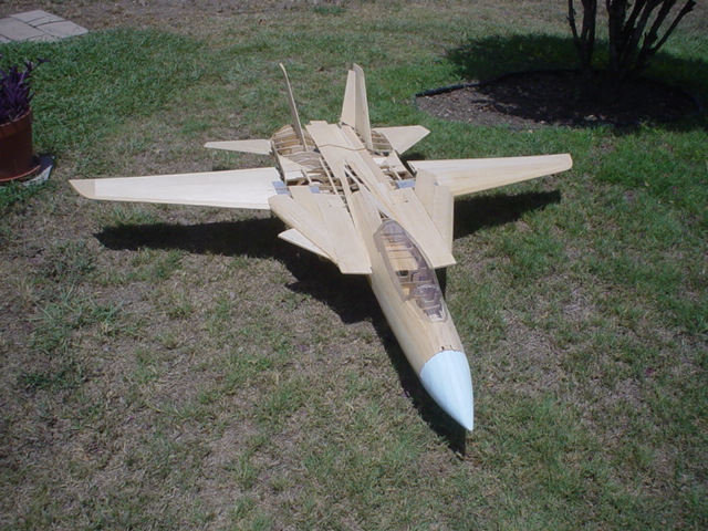

donnyman's Avatar
Joined: Jul 2008
Posts: 2,454
Received 204 Likes on 130 Posts
From: Manor, TX But my heart is in Brooklyn N.Y.
Default RE: 'Best' model for MW54?
My vote for best model, but you will need another engine.
DONNY
