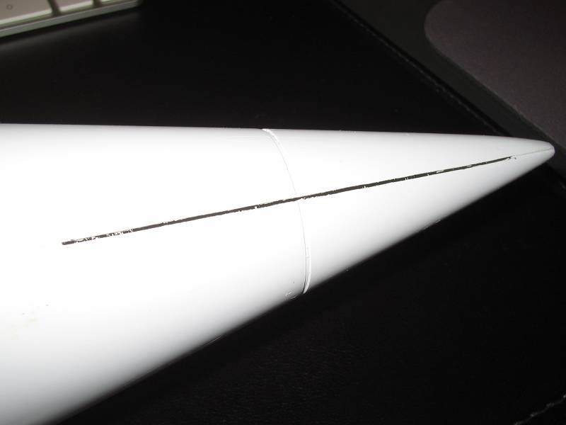

I know this method has been posted or suggested before, but just wanted to support its ease of use.
I have tried cutting nice straight lines in fuselage or composite items using diamond wheels on Dremel type power tools, fixing a straight edge to the item and then either taking chunks out of the straight edge or the workpiece - either way the slot is never really straight, and often wider in places than others......
So tasked with cutting two slots in some BVM drop tanks for a fin i used the 'hacksaw' blade method. Trim a junior hacksaw blade down to say half its length (makes two cutters then), make a handle to protect your hands from the teeth - I strap two wooden coffee stirers to the blade and wrap electrical tape around them, leaving about an inch of blade exposed. Using a Dremel and a cut-off disc cut the tip at an agle and then on the teeth edge grid a small angle sloping back towards the teeth making sure you leave a tooth exposed at the leading edge.
Depending on the blade a cut will occur on either the forward or backward stroke.
Using a piece of stiffish material, flexible ruler, or as I find best thin glass board, tape this to the workpiece to line up with the slot you want to cut. Mark your extremities of the cut and then using light stokes only run the blade up and down the surface keeping light pressure on the straight edge. The blade will slowly cut through the gel coat and cut into the material, sooner or later (later with carbon layups!) the blade will break through in a spot or two, if you widen the slot big enough to get the blade in you can then use a sawing action to cut the slot open along its length - the groove already made helps keep the slot straight. Each end can be cut to meet your end points without going too far.
Hope this helps some, and sorry if its bored others!
marcs.

In the BVM manuals I have built from they suggest the same but using a razor saw with the back removedinstead which give a really fine cut on things like gear doors on the Bandit. Good tip though. Thanks

Ehab, tried that and found it very slow going, really had to work the hot blade to make any progress. It certainly did not like anything with cf reinforcement which is often the case in areas where cut-outs are required.
Jason, found the blades blunted real quick on those razor saws, with the small hack saw blades just re grind the tip when it looses its bite and away you go.

Just to reinforce and clarify what Jason said, the razor saw method leaves a gap thinner than the Dremel cutoff wheel. Perfect for applications where the cutout piece is kept in place, such as with hatch covers and as Jason said, gear doors. Accurate to control as well.

Mmmm, Craig not having a go at Jason, I know the razor saw will produce a thinner cut than a Dremel cut off wheel, thats not really what I was getting at, more about a neat straight cut of equi-thickness all along. Incidentally you can get diamond tipped wheels which are the same thickness as a razor saw blade if the truth be known - just not easy to use! A razor saw blade looses its sharpness very quickly when using it on composites so where there is carbon reinforcement you can go through a fair few trying to cut the slot. The junior hack saw blades are cheap and the 'cutting' tip renewable with a quick grind off.

</p><div style="margin: 0cm 0cm 10pt"><span style="font-size: 9pt; line-height: 115%">marc s,
not sure what razor saw you have been using but the Exacto one I have been using since 2001 is still sharp enough to cut through composites and occasionally my finger too

Its an Exacto one too, but the blades don't seem to last long when cutting through fuselages
marcs
Very true. It's necesary to frequently snip off the end to have sharp cutting teeth.

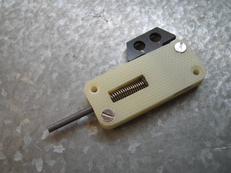

Did you finish your composite hatch latch system ?

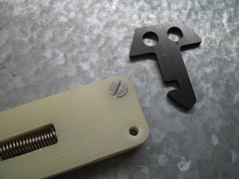

Olnico, the samples were made but yet to find a man with a cnc machine who can cut the pieces in bulk for me, I have tried seanrit but he has gone off the radar and is not returning my skype calls
If you need a few let me know and I will send them in the post.

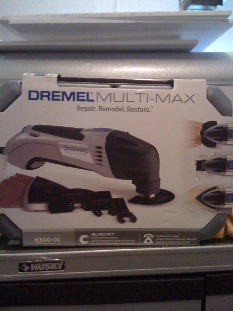

Maybe this is similar to what you were thinking. Dremel's version of a "Tommy Saw" . Ijust picked this up 2 days ago. 1/2 price so Icouldn't pass it up. Thenew stock ones had a bonus blade in them but I'll keep the $50.
( Home Depot if you guys are looking, Its clearance season and you never know what you may find. I also picked up a Makita grinder half price. Most of the stores have the arc welders and small air compressors on clearance. Other stuff are one of kind items. Istop at every Home Depot I see now LOL.)
I haven't tried it yet, but it sounds like it would be perfect for the job you describe. These normally are $99, at least for this kit combo (Dremel 6300-01) that also has a triangular sander attachment.
