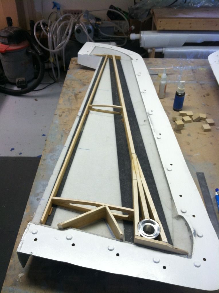

Then i began work in the internal structure for the wing.
First up the main spar shear webbing. You can also see how it is a 3 piece affair at the bearing holder location so it is sandwiched in position to keep it from moving.
Then the sub spar/flap hinge spar and two wing ribs were made up. I still have a few parts to make for wing root, which i plan to do tomorrow.
Here my cutting jig tool has been completed. The cut off bolt goes into the pivot point location (this location was designed into the molds so every wing will have it in a indentical position). The permagrit tool was then used to cut out the wing skin so the bearing holder can be put in place:
Then the bearing holder located donuts were bolted through the same point in the mold:
Then the bearing holder was test fit:
This was repeated for the top wing skin as well. I had to modifiy the dimensions on the bearing holder (good thing for having my own lathe now) so i will have to update the CAD files to reflect the correct size.

I finished up all of the parts for the internal wing structure. Due to my design of the carry teough spar in the fuselage, i will have to notch the wing root, i hoped i wouldnt have to, but oh well.
Then i realised i needed a hard point for the pivot actuator mount to attach. So some 1/4" aircraft ply was cut to fit between the wing root and the bearing holder. The main spar sheer webs were modified to allow for this ply plate to fit.
I then epoxied all of the main structural parts together (main sheer webs, sub spar, wing ribs). Then i rough cut a bunch of 1"x2" hard balsa blocks for the flap hinge mounts. Ill sand them to the proper shape and epoxy them to the sub spar later this evening.
All that is left to do to the internal structure after the hinge blocks is to drill the ply plate for the pivo actuator mount bolts and install the blind nuts. Once that is done, the wing molds can be closed together permanently. I hope to do that tomorrow!

Thomas, it looks beautiful, but I still question (and perhaps I'm not fully understanding how your spar works) the strength of it bearing pivot block. IMO you would benefit a huge amount from even just a 1/8" full depth aluminum spar tig welded to the bearing housing that extends a good 10" or so out into the wing. It could sandwich between the main spar with bolts and hysol. As it sits right now, your main spar is great, but there is still little more than your wing skin holding the bearing block. I am not questioning your skill, but after years as a machinist and die maker offering my thoughts on arguably the most critical structure piece of your wing.
#1118
My Feedback: (23)
RE: [Deleted]
Jeremy,
I understand where your concern is, and i agree whole heartedly. The pivot to wing spar junction is by far one if the most critical aspect of the model.
I do believe allot of peoe are getting confused about what they are thinking is the wing spar, so ill take some time to try and explain it better.
The primary wing spar is NOT the big piece of wood you see going around the aluminum bearing holder. Matter of fact, if you take one molded wing skin (just a top OR bottom), the primary wing spar is already in the wing skin.
There are over 300,000 individual strands of carbon fiber in each of the Integral primary main spar. This spar is sandwiched between the unidirectional carbon fiber and glass cloths. The unidirectional carbon is also part of that primary spar.
The hole for the bearing holder in the skin is surrounded about 60% of its circumference with carbon fiber tow, when the hole is cut to the correct size, the bearing holder is a snug fit and should not move at all, if ever.
The big chunk of wood you see is a secondary spar to the integral carbon spar. Its primary purpose is to act as a shear web to keep the upper and lower wing skin in correct location to each other. Its secondary purpose is to assist in preventing bending moments. I tested this component separately by hanging 30lbs of lead from the end of it (roughly 1/2 of the models flying weight). It deflected roughly 1/16".
The way it Y'a off is theoretically going to lock the aluminum piece into position.
Hopefully all that makes sense. Again, i fully expect this wing to not last through the stress testing, but it it does, that will be even better and is why i am building it as if it were to be a flying part. Because if it does survive, it will be a flying part!

If my pseudo cad testing of the wing spar is correct, it should support 300lbs.
Again, we will find out soon enough. I need to make the slat plug using this wing before i stress test it, but that should only take a day or four. But work is also beginning to get busy, so it may be awhile before i get to testing he wing.
Exactly my thoughts. As far as the G loading, i plan as a minimum of 10G's, that should suffice. The fuselage contributes to about 3o-40% of the lift. Lots of things to decide when i get to that point of the project. But at a 65lb flying weight and 10G load factor, that works out to roughly 210lbs of weight per wing panel, assuming a 35% lift support from the fuselage.
