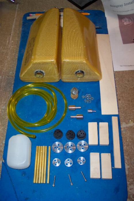

Can one of you kind chaps please give me a detailed description of how you plumb your turbine tanks.
The system I am using is 2 large tanks in series and a hopper/header tank.
How do you connect them all up? i.e
How many tubes per tank and what does each one do?
Where do the tubes go inside the tanks?
What tube thickness?
Detailed help will be very much appreciated
Old 06-22-2003 | 05:50 PM
Posts: 993
From: Otis Orchards, WA
Default tank installation

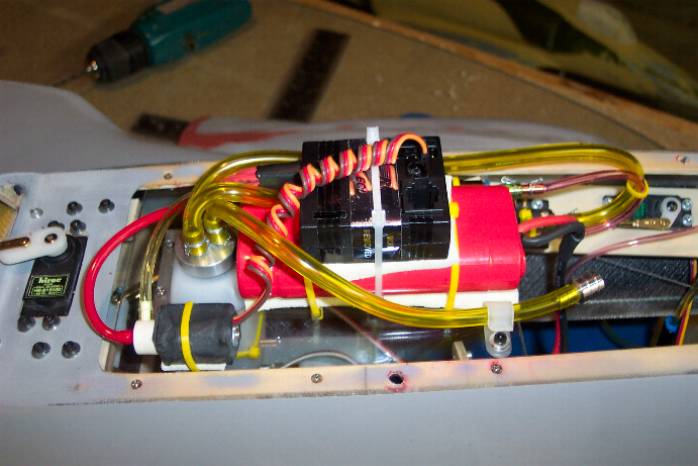

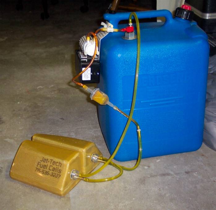

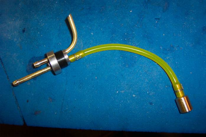

Each main tank is going to have two lines and the hopper will have three. I use 3/16 brass with the next size up in 1/4'' lengths to make a retaining nipple on the ends so the tubing cannot slide off. Each main tank will be set up as normal with a clunk and a vent that reaches the top of the tank to allow full capacity of the tank to be used. The hopper will have a center pickup or filter clunk that goes to the pump, a fill line and a feed line from the mains, these two lines should be short in the tank so that you again get full capacity. going from the hopper back this is the way it should work. the feed line of the hopper will go to the clunk of one main tank and the vent of that tank will go to the clunk of the second main tank and its vent will go overboard. I left a small amount of brass hanging out to hook up an overflow tank. I used tygon tubing and safety wired all connections just to be sure they stay put. Hope this helps. Here is a few pics of the stingray tanks that should clear everything up for you.
Chris

Old 06-22-2003 | 05:52 PM
Posts: 993
Default Tank installation
another
Old 06-22-2003 | 05:53 PM
Posts: 993
and another
Old 06-22-2003 | 06:04 PM
Posts: 993
you can kind of see the lines on the header tank here.
