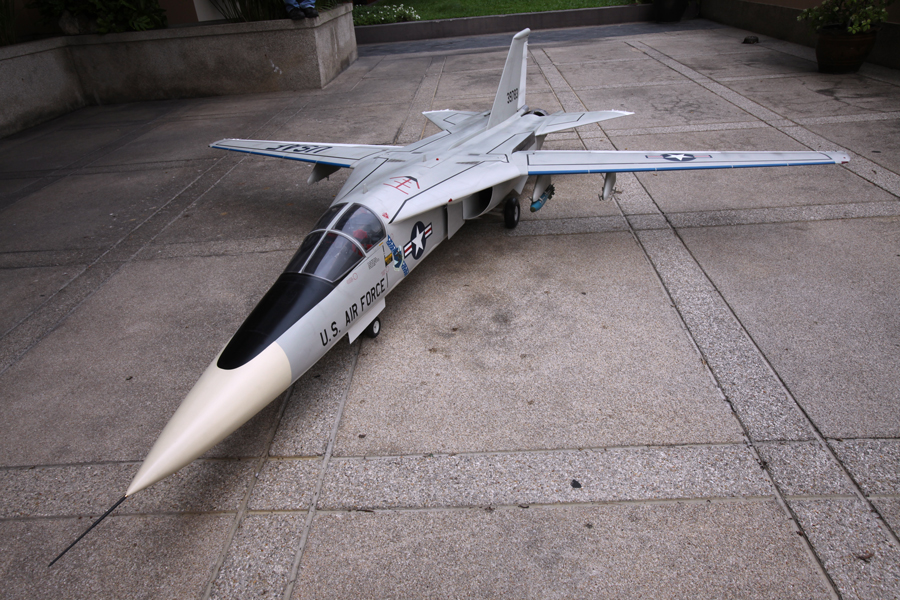

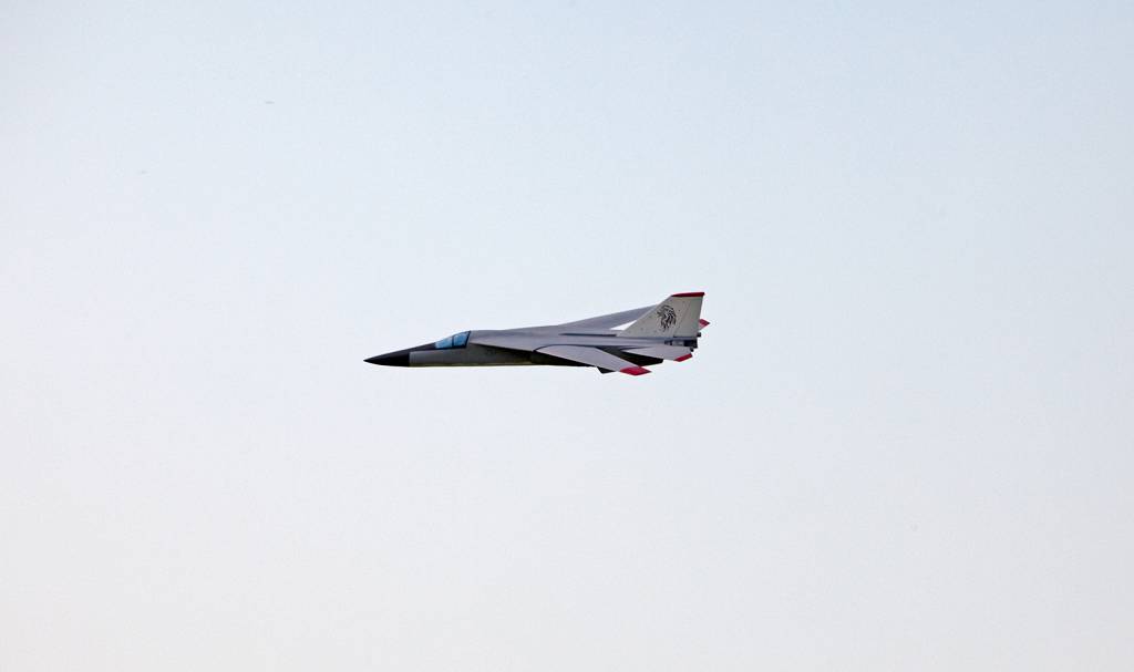

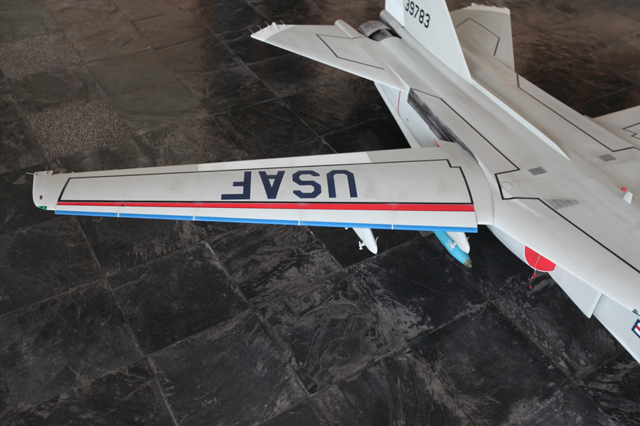

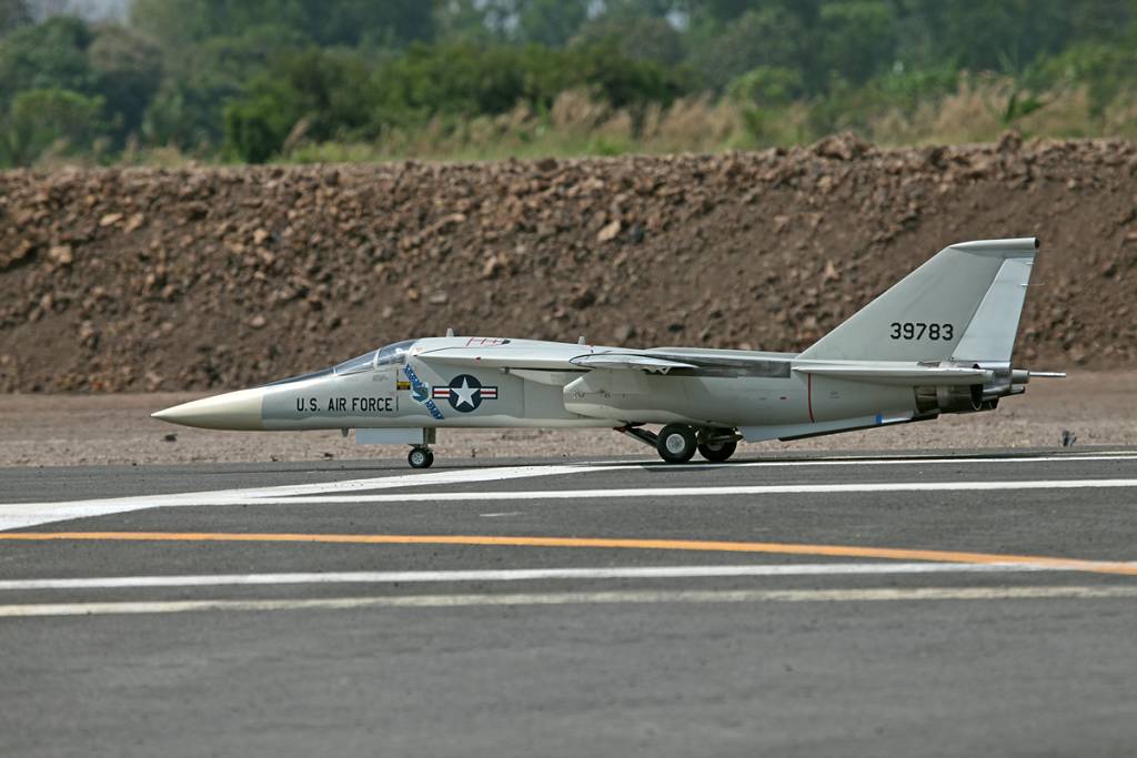

final test flights were completed this month on the MIBO FB-111 which will be at Top Gun next month. Attached are a few photos of both the practice and competition planes. The aircraft has fairly complicated programming on a 14 MZ, I really need to thank Duke Chung for some coaching on the programming.

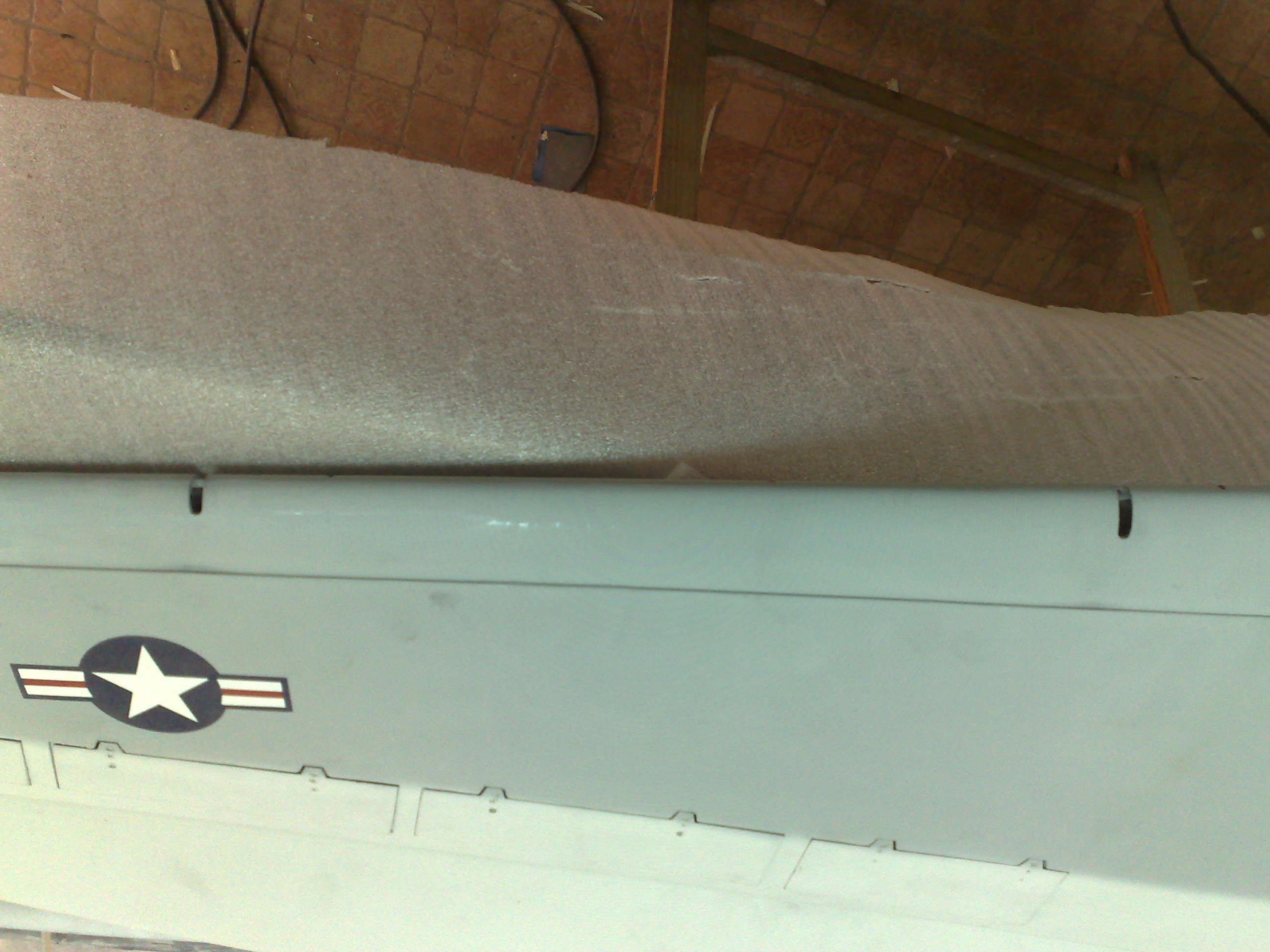

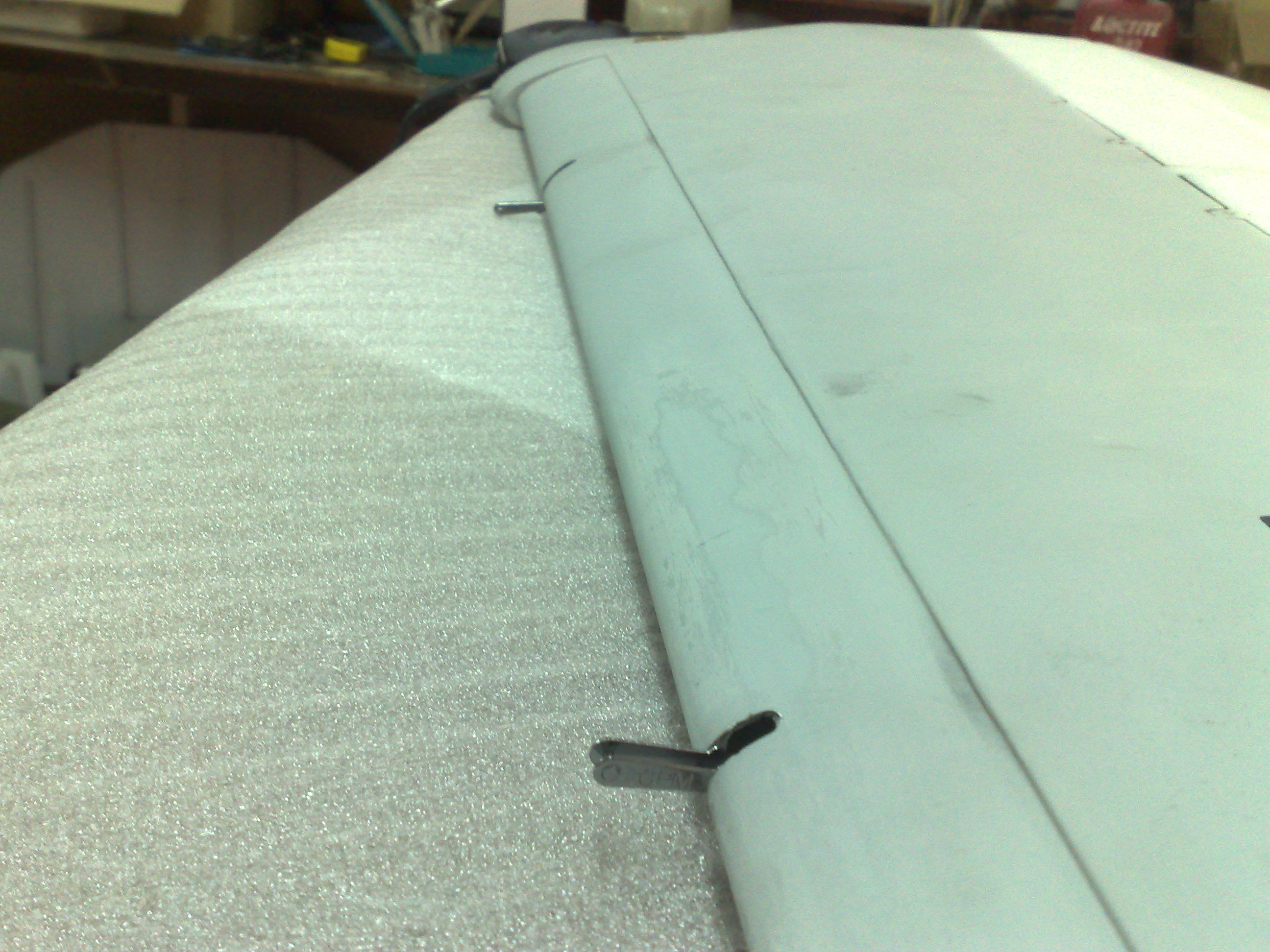

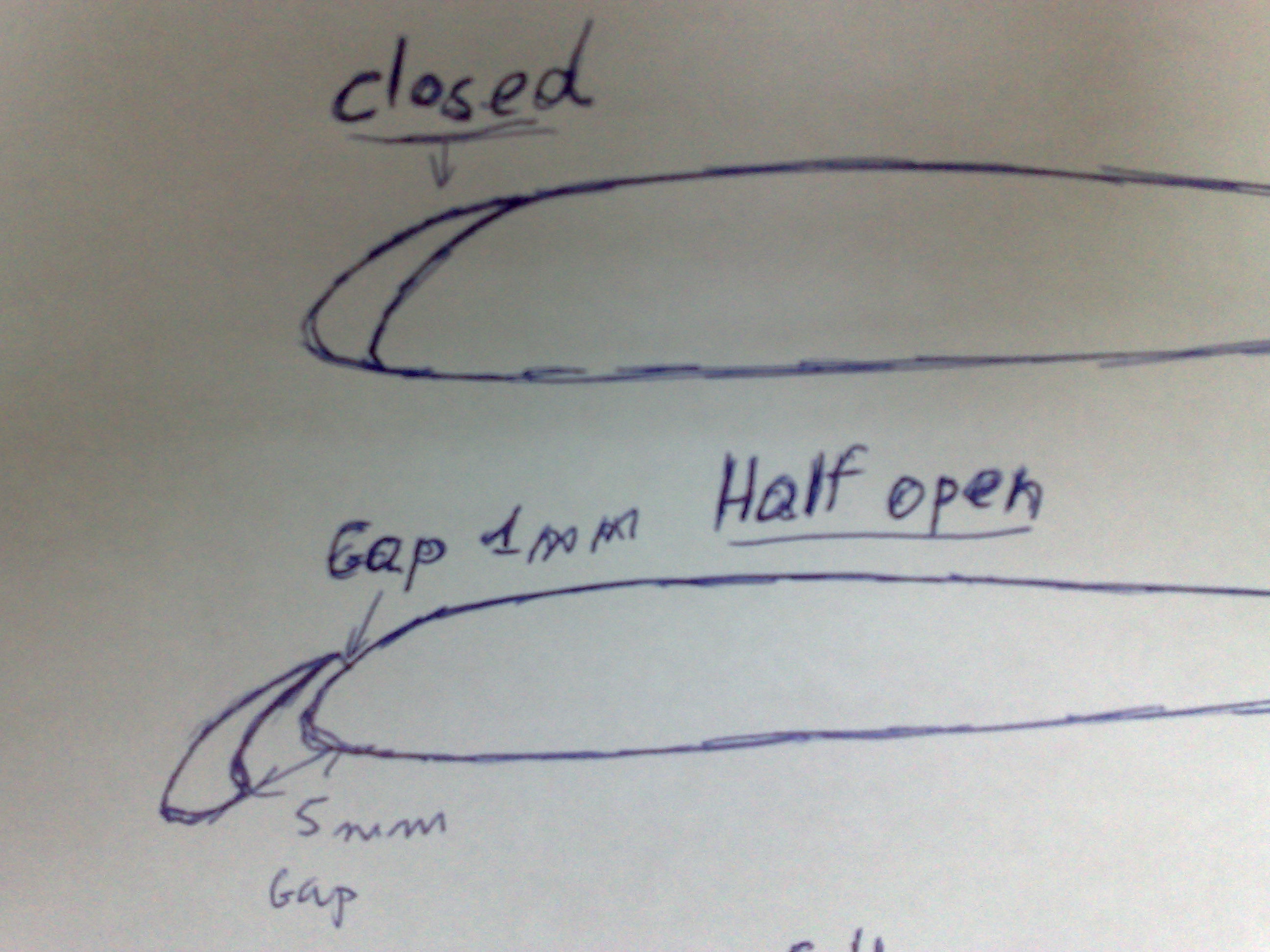

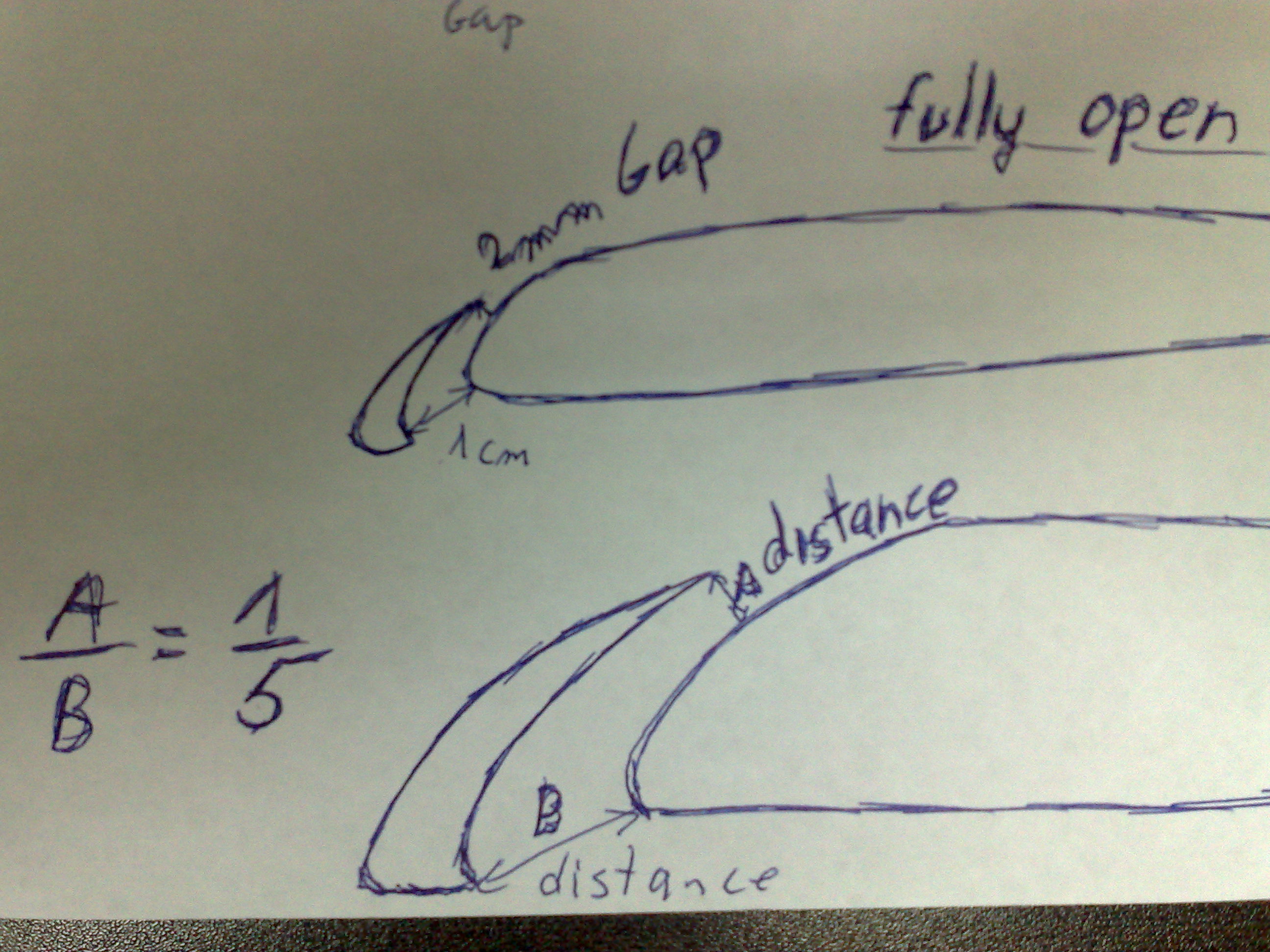

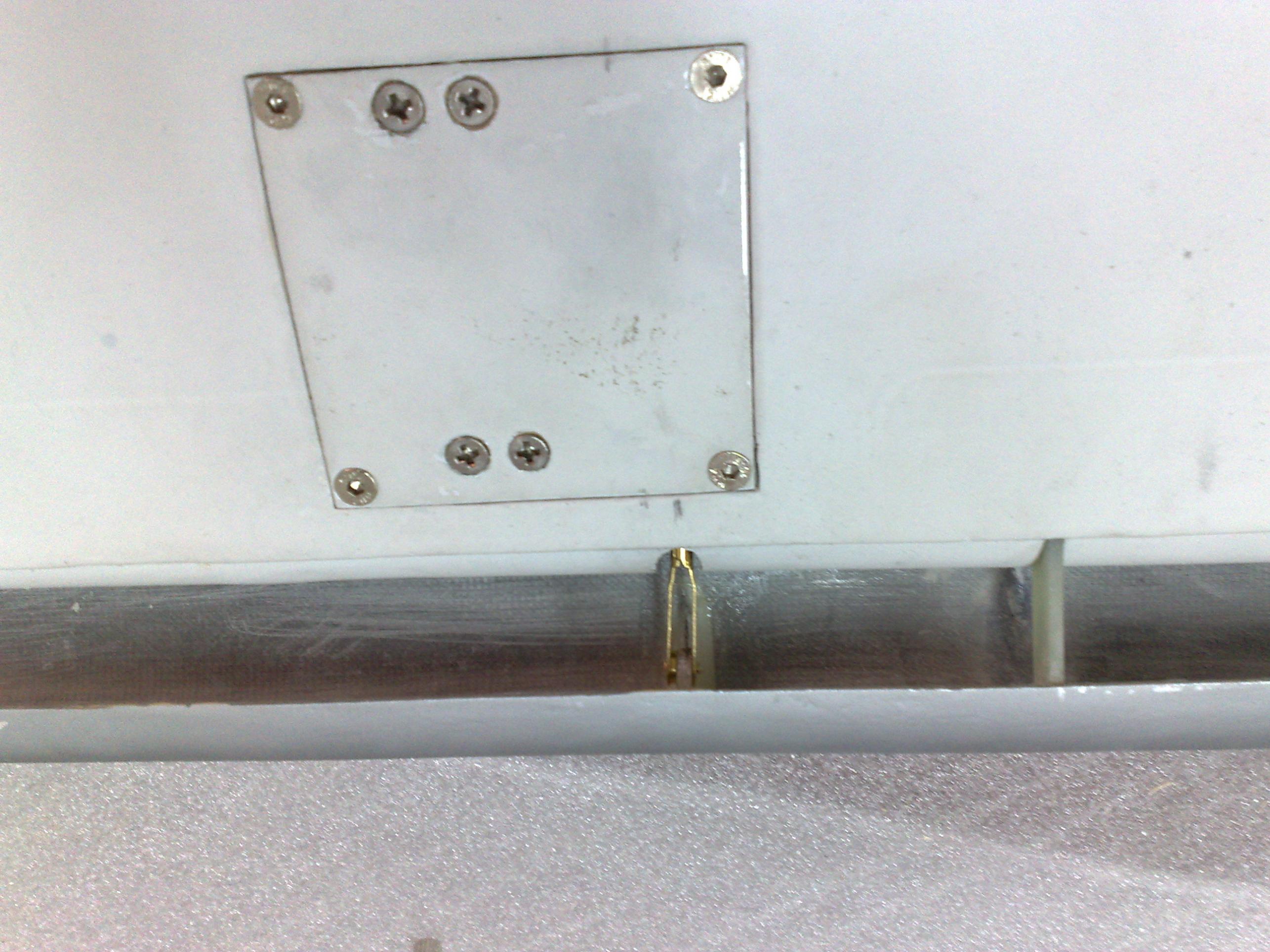

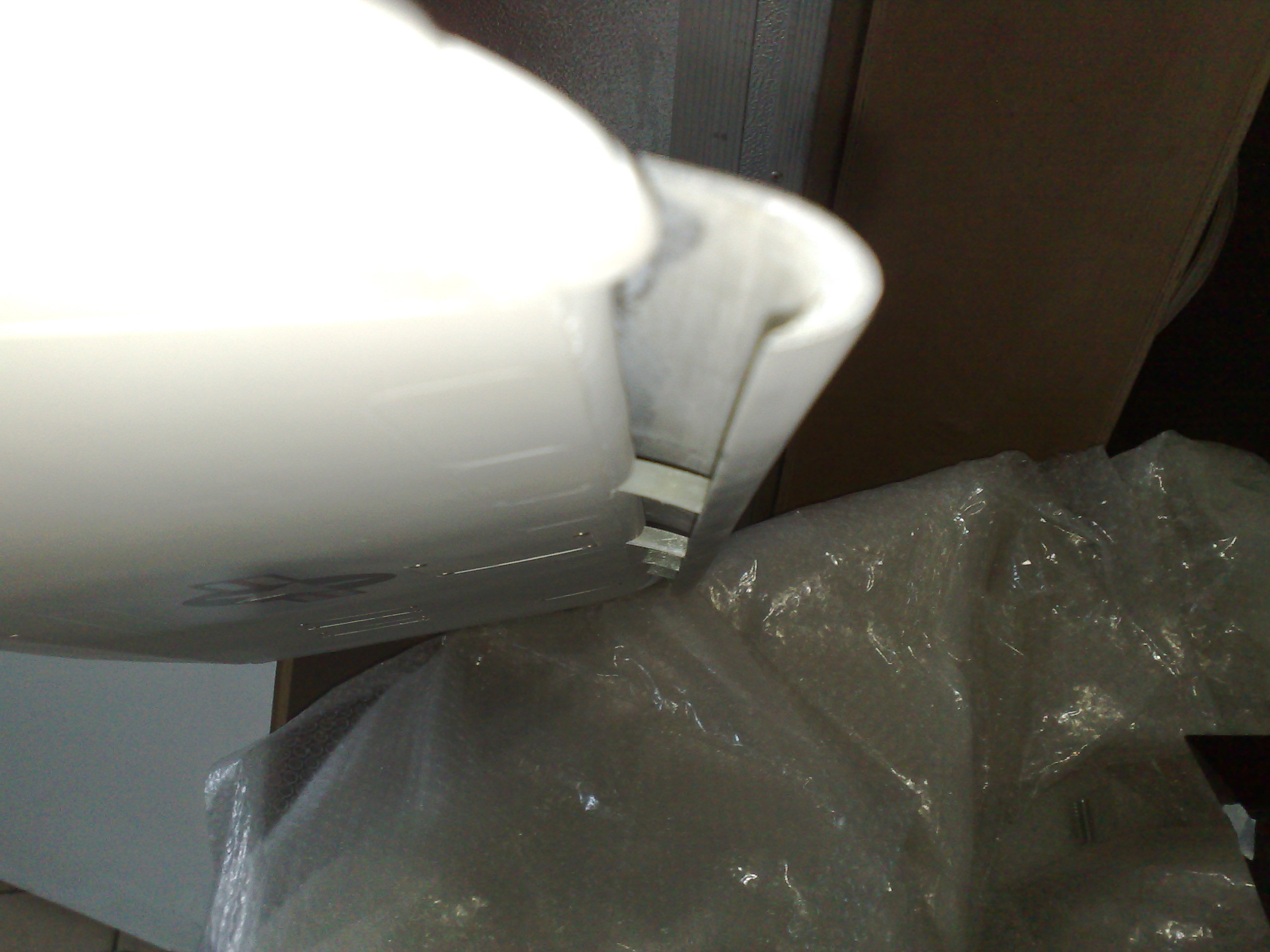

Hi ,
I have designed some of the new FB F-14D systems among them the wing slat sys so here are some pictures that can throw some light on your question...

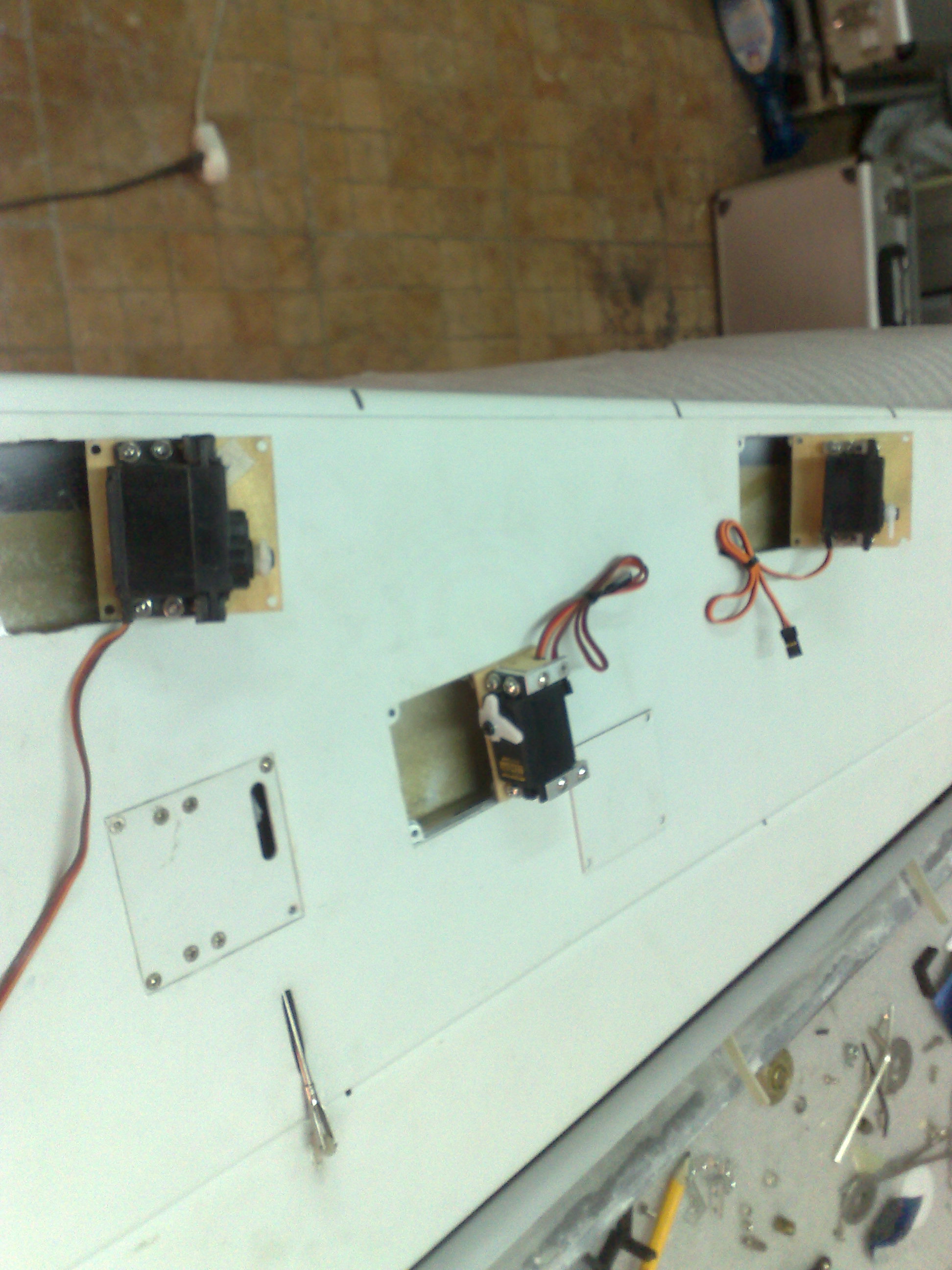

more..

I just want to add that the actual max movement of the slat forward is 18mm at root and 14mm at tip.

more..
