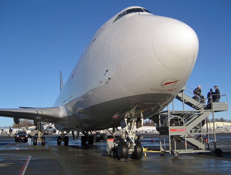

Didn't know you were a former load planner. I flew 747 clasic freighters for a while with a routine max takeoff weitght around 830,000 lbs. Always trusted you guys to get it right and you always did!
Still amazes me these monsters ever made it off the ground.
