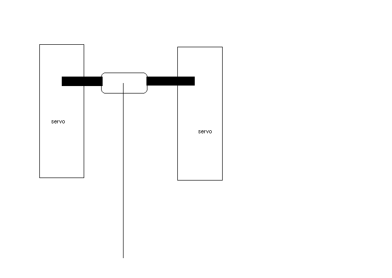

I have made a skecth, a quite bad one I'm afraid but it hopefully will give you an idea of what I mean. It is really quite simple.
Very interesting, Matt, I'll certainly take a closer look at this system, probably order one, as ONE locked up servo on a dual servo Hawk stab. for example, locks up the whole thing, meaning very little redundancy.

On a quick glance over the system, seems that you are adding three aditional points of failure:
The two extra critical linkages on the servo bridge and the posibility of one servo failing and going at one end of his travel arc.
As this is not resolving the problem of retaining the same amount of travel even in case of a optimal servo failure, the plane will probably turn incontrolable too... and having a dual rate switch to quickly overcame this will imply in having half the amount of the force applied on the surface on standard operation mode wich is a bad idea. Another built in disadvantage is the greater amount of slop on this system.
As far as I have seen, the best way to give safety redundancy on a single air surface is installing two brutally strong servos on it, wich in case of failure of one of them will still have enough torque to move the surface with all the flight loads and a dead servo thru the full travel.

Does NOT work. Try rotating a servo with a burnt out motor, impossible, they lock SOLID and the torque of another servo will never overcome one. If you use very strong servos with a system such as the SWB or similar geometric system , you can easily use only half the torque, using a dual rate switch uses also half which SHOULD be MORE than adequate, if you choose your servos carefully (JR8711, 6311) and balance the stab. Of course there is no problem in overcoming a passively failed servo.
The other two points of failure are mechanical. 99.999% reliabilty should be eaily obtainable and slop should also be easily eliminated by careful manufacture and tensioning of the cables !
This SWB system is the best I have seen so far for creating a most reasonable degee of servo redundancy on a twin servo stab. Its not perfect but it goes LONG way to solving the problem.

Yes it works, not all the fail modes of a servo includes a locked burnt out motor.
About applying half the torque of a servo with mechanical disadvantage is unfortunately just plain wrong and a safety issue in r/c jet models. In fact, this can led to burning out motors, no matter how carefully you choose them. Not to mention about the pointless extra load in the electrical system.
About the extra mechanical points of failure doesn´t matter how careful you can tension a pulley, pivot, slider, whatever.. it is has two extra rotating points wich multiplies the slop on all the system, that could led to flutter wich is a major safety in r/c jets too.

The SWB system is not the one I'm lookin for. It takes to much space and is to complex. No comment on my sketch? You must click on the picture to see it. I think it is a German company that's making it but I may be wrong.

Ela, I think you system does approximately the same as the SWB version: one locked servo gives half the travel.
I saw your sketch in the last issue of FMT magazine (german). They also explained it works even with one stalled/burnt servo. Burnt servo poses no load on the working servo. You have half of the travel left if it is stalled in the center position.
If otoh a servo breaks at full deflection, you need full deflection from the remaining servo to get back to neutral. Though it is better than no control at all, i doubt that will save your plane if a servo breaks at full down on an elevator...
I like the system though if you have two servos on one control surface. (eg elevator half)
