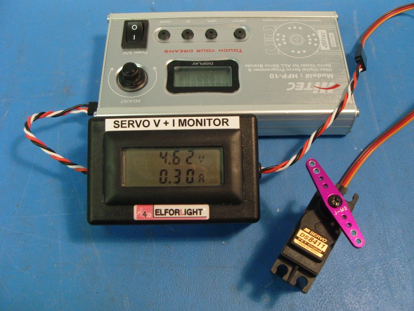

Here's one I made earlier......
Servo tester needs charging up and then I can calibrate the meters properly.
