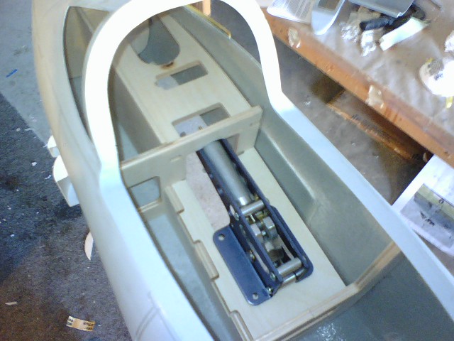

Some pics where they sit. You will also notice that the retract will sit on top of the mounting plate instead of coming up from the bottom. Before gluing these in you may want to check and see if the gear doors are sitting good in there openings and make sure your gear are retracting properly.

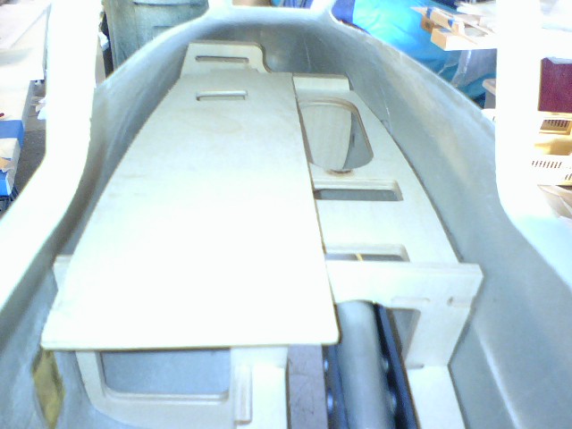

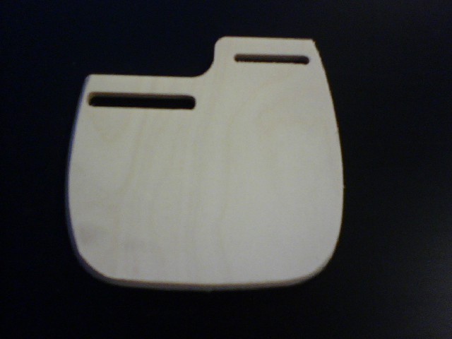

This former will not be glued in. It slides into the slot in the nose former and it used for the air valve, servo etc.
chris

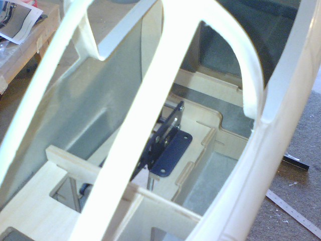

The former that connects the first 2 formers has a cutout for the nosewheel. Behind that cutout there is another cutout for a servo for the steering. I used a extra long aluminum T servo control horn that would clear the strut on each side. I used all thread on each end of the control horn to drop down the angle of the cable pull pull setup. The second picture shows a small hole outside the opening where the strut retracts into. There is actually a hole on each side and these are used to keep the cables away from the strut. The all thread when put in the control horn will strattle the strut when in the up position and the cables will connect to the bottom of the all thread. You will also need to cut down the horn for the steering mechanism for clearance at the formers. I do not have any good pictures of this setup because Tam did not want me to glue the nose formers in and he wanted to install the retracts. I guess we will see what he has up his sleeve. I will try and post some pics as soon as i can.
chris

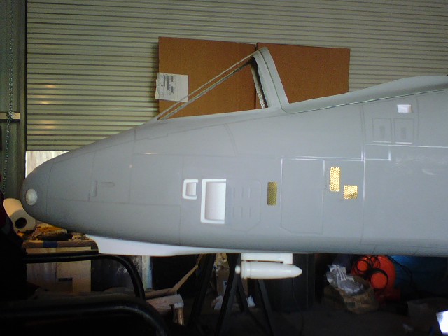

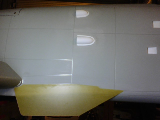

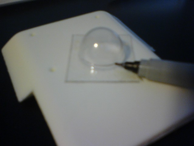

Pave penny laser tracker
-I used some all thread to attach the tracker to the pylon
-Marked a line on the lens by spinning it on a flat surface, cutting it out with scissors and then sanding it on the table to make it look pretty
-Here is the location. Right up against that panel line. Make sure front gear door is able to clear it.
chris

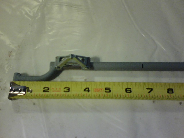

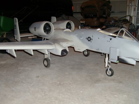

I was unable to finish the install of the front strut on Tams A10 because he did not want me to glue in the nosegear formers. The front strut on Ty's A10 was cut down to a 6.5" over all length.
chris

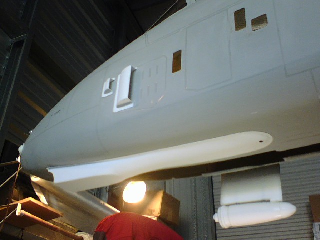

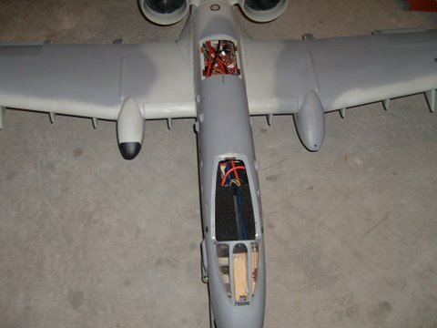

Ty's installed pylons
chris

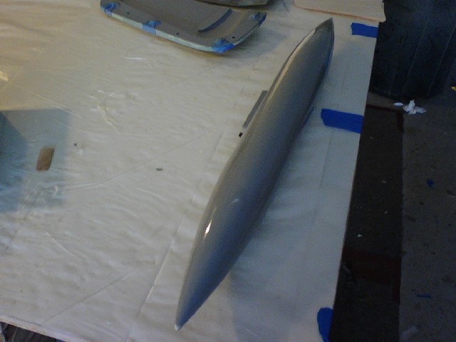

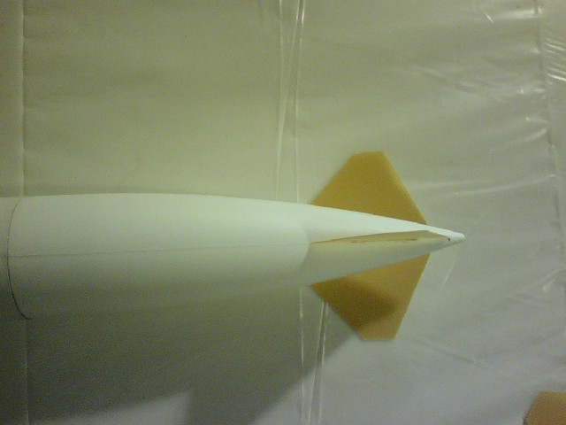

First drop tank pulled from mold weighed less than half that of the rocket tube and nose cones and is very stout. Weight came in at .26 lbs. I think i can lose a little bit more weight by dropping down from the 3.7oz. cloth i used but i think at this weight i would not lose much more.
chris

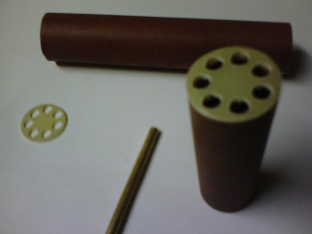

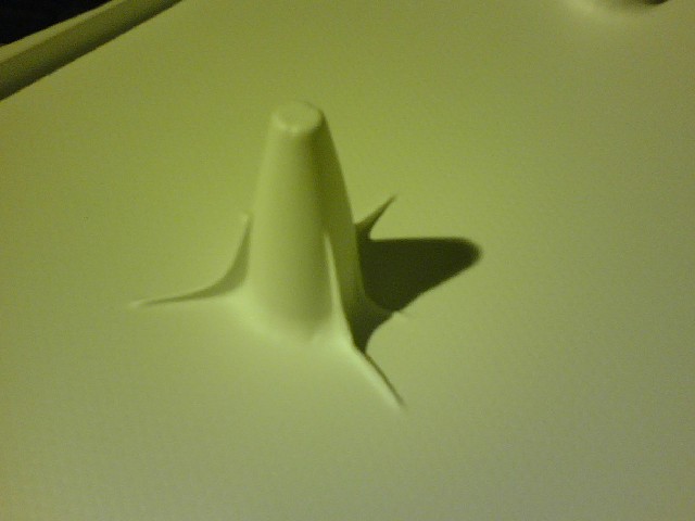

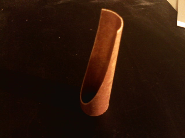

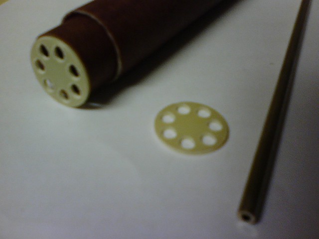

For ordnance, i decided to go with phenolic tubing with vacuum form nose cones. The phenolic tubing is a slight bit heavier than the paper rocket tubes but have excellent strength to weight ratio compared to the paper tubes plus they do not have the spiral to fill. Just sand them down and paint.
I have never had much problem vacuum forming until doing the nose cones. The high steep angle of the nose cone stretches out the plastic only to suck back into itself. I have been expiromenting with different methods but still come up short. If anyone has any suggestions or experience with this, your input would be greatly appreciated. I do not want to do these in separate halfs. Below is a picture of the problem.
thanks
chris
