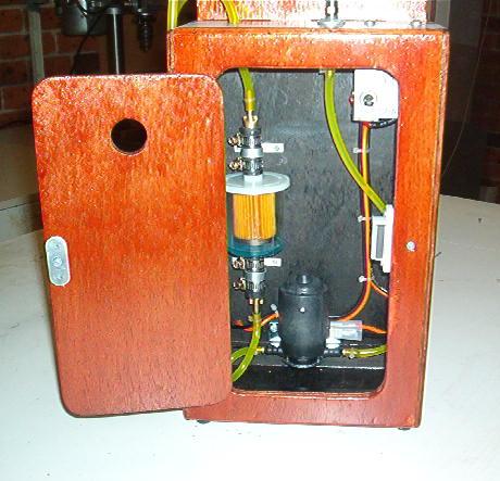

Hello, please help, I want your help how i can buy or build a field box very small and include battery,air pump, and fuel pump.Thank you for answers and photos of your own.
Old 08-27-2009 | 04:40 AM
Boomerang1's Avatar
Joined: Jun 2005
Posts: 2,991
Received 25 Likes on 15 Posts
From: Sydney, AUSTRALIA
Default RE: Field box

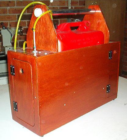

I use this. The compressor mounts above the power panel. 10 litres of fuel (enough for a day's flying), pump & filter, battery with enough capacity to charge between flights, fuel, defuel & pump up retracts mounted in base. - John.

Jonh. nice setup. How heavy is it?
With 10 litres of fuel it weighs 18Kg. Not light, but some jets weigh more than that!
I have since modified it so the handle swings to one side to change the fuel container rather than sliding the handle out. - John.

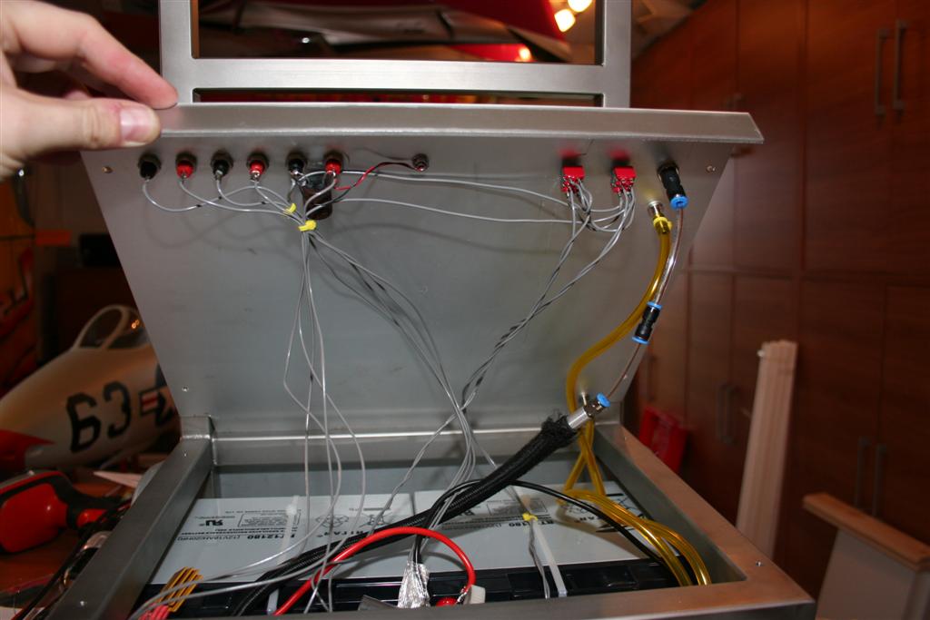

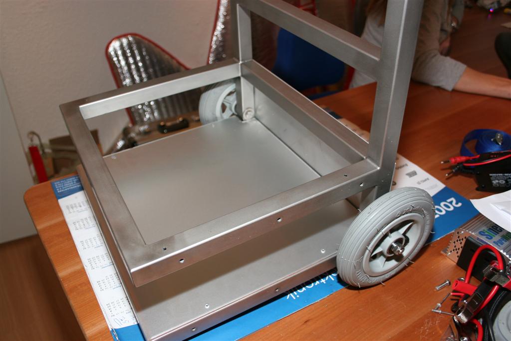

A friend (which is both a jetpilot and a CAD guy [8D]) and me, made these, they are heavy, but very nice to have everything in "one box", air and fuelpump are located in the bottom of the trolley together with two 28 amp/h Gel batteries. On top is 20 ltr's of kero
I charge my planes from the trolley at the field (so does some of my flying buddies )
drawings in pdf: www.moonbounce.dk/trolley/Trolley-PDF_2D.zip
Autocad: www.moonbounce.dk/trolley/Trolley_AC2000_2D.zip
