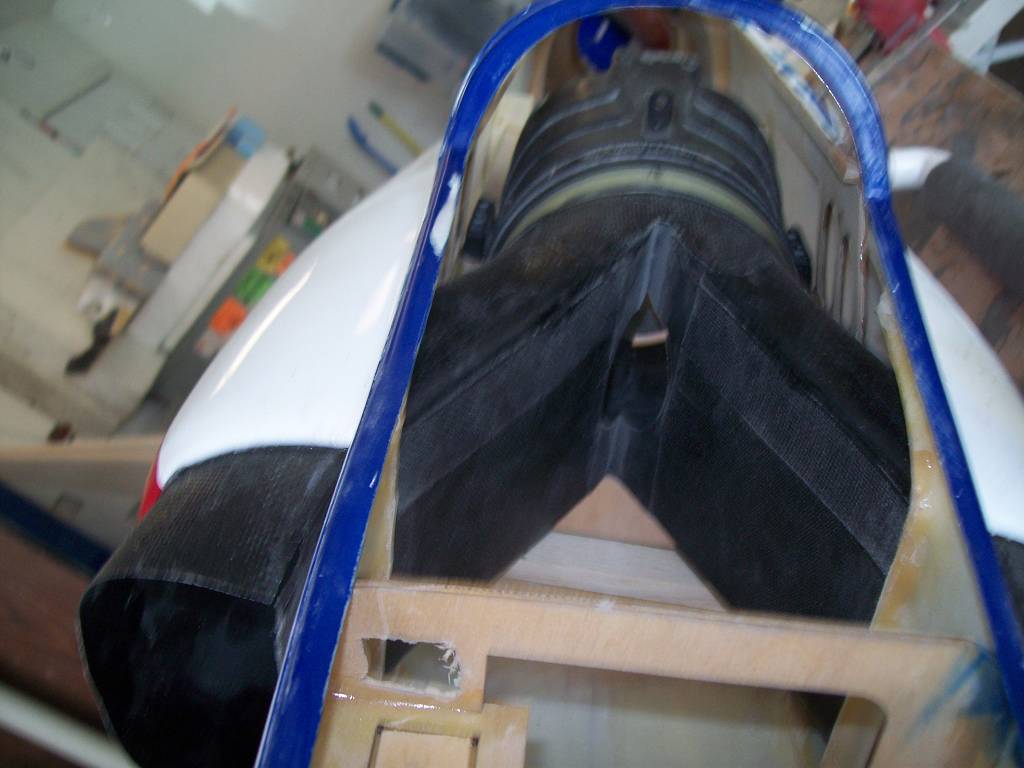

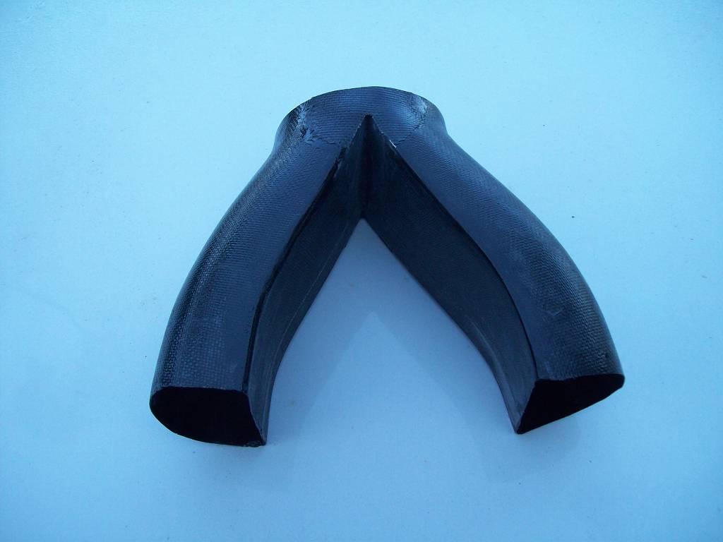

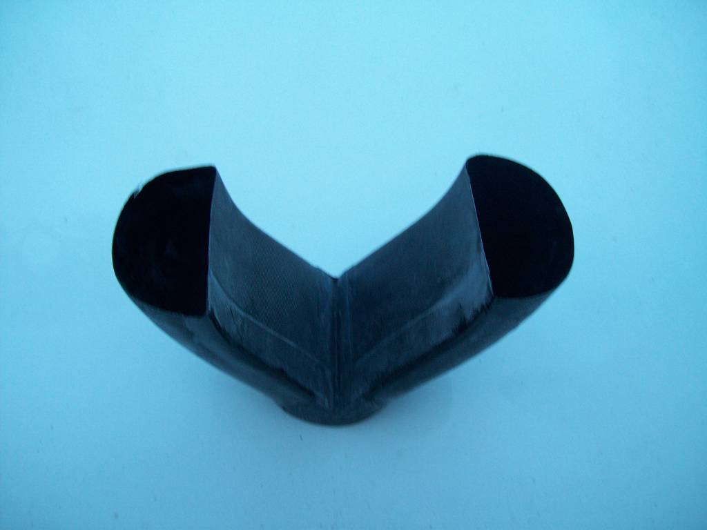

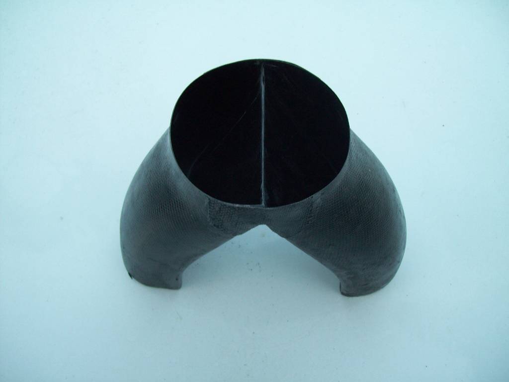

made some plugs and molds for" cad design "intake ducting.. look like bandit intakes...now bvm in hawks
ID:	1269038   Click image for larger version
ID:	1269039   Click image for larger version
ID:	1269040   Click image for larger version
ID:	1269041   Click image for larger version

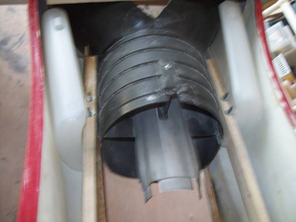

Inlets look great. YOU NEED TO TAKE THE SPINNER area out the inlets though for best performance.
Old 09-05-2009 | 06:32 PM
My Feedback: (41)
Posts: 1,773
From: WEST PALM BEACH, FL
Default RE: HAWK INTAKES BVM

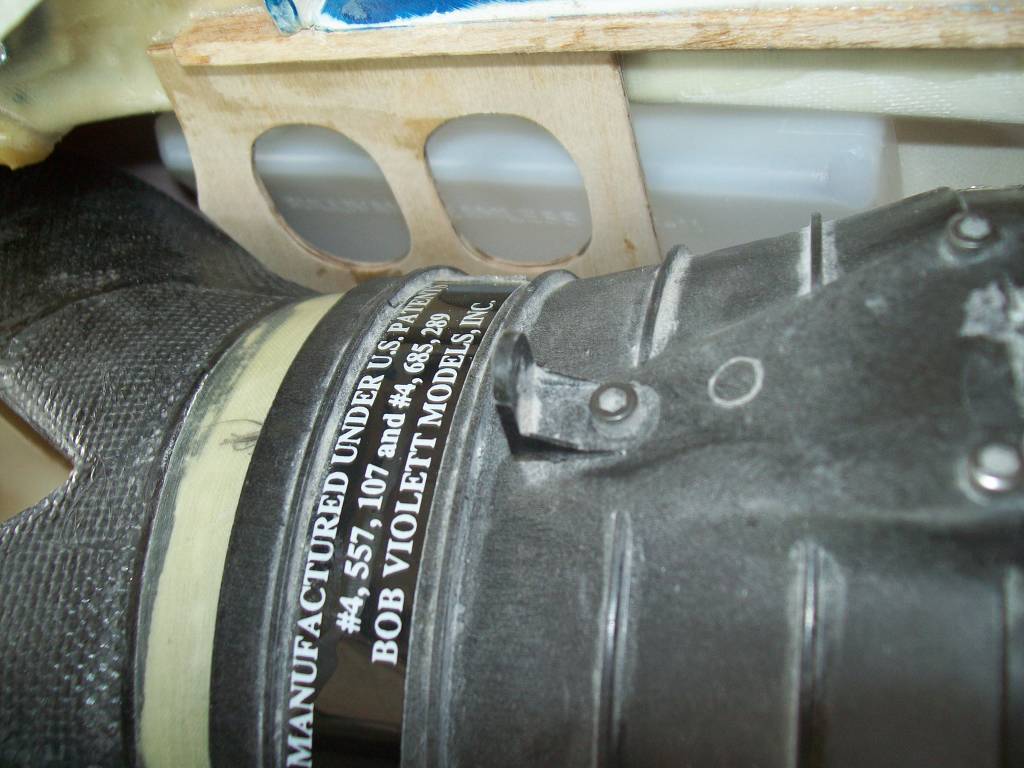

thanks .. i did cut out for spinner after test fit and flow tests.. will some more pics sunday bee cool and thanks for interest.

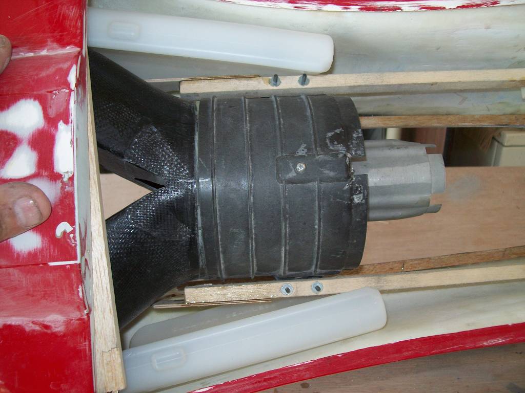

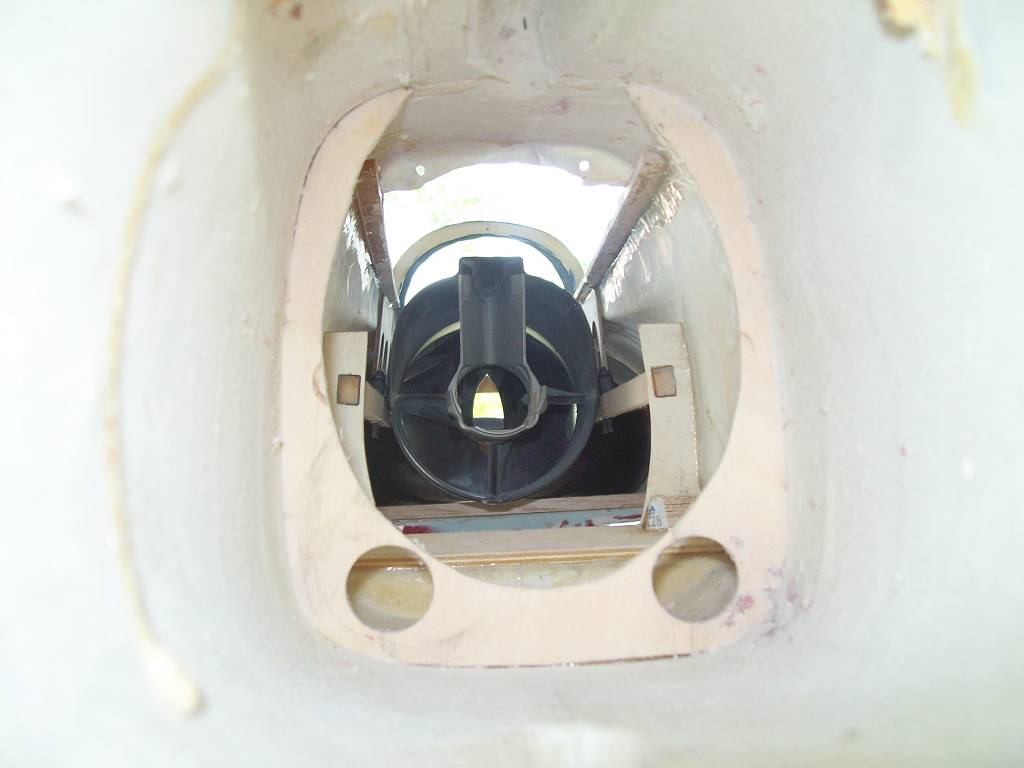

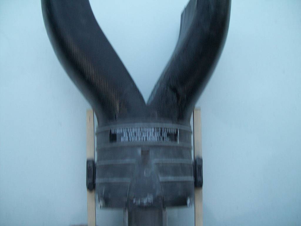

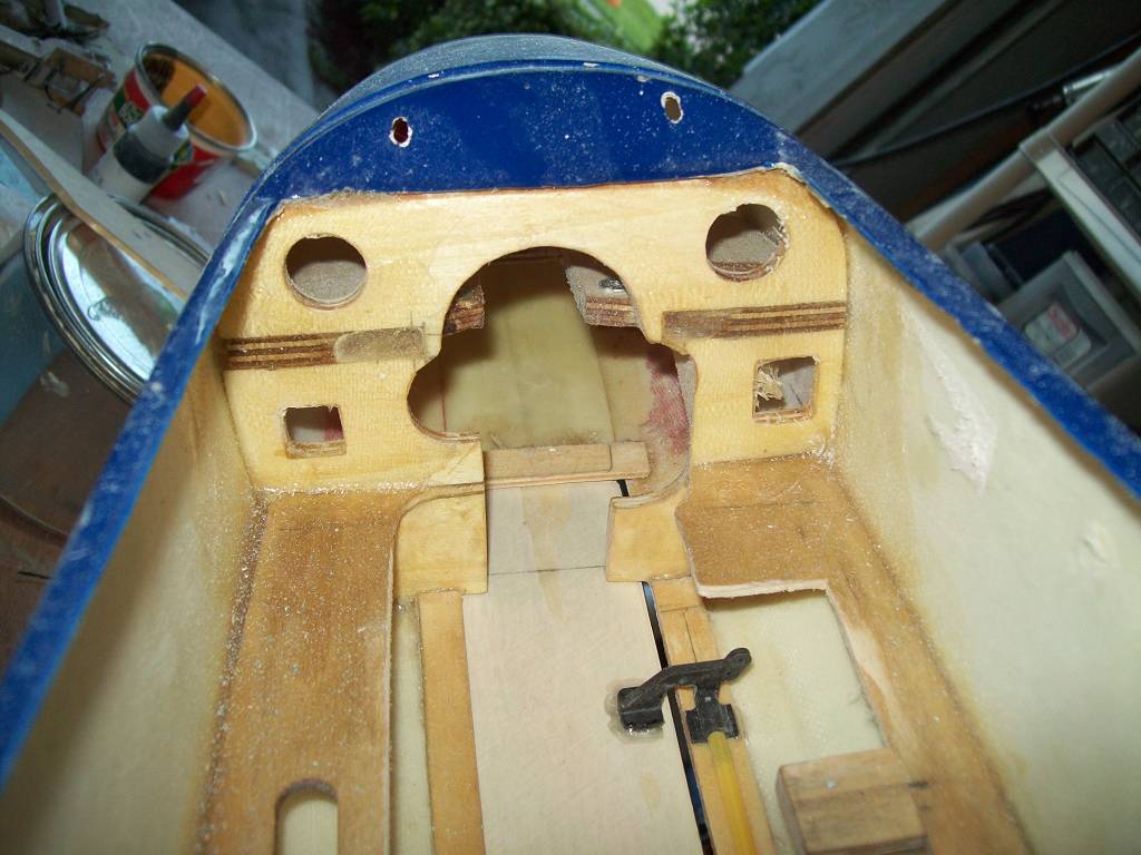

installed pics.. fuel tanks on c/g and perfect carb height///
ID:	1269633   Click image for larger version
ID:	1269634   Click image for larger version
ID:	1269635   Click image for larger version
ID:	1269636   Click image for larger version
ID:	1269637   Click image for larger version
