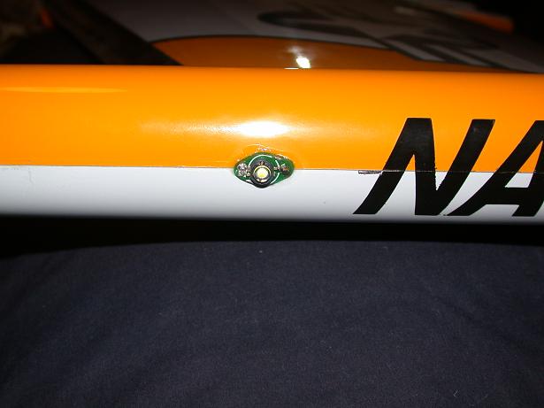

I've got 3 watt strobes (Luxeon Emitters) on mine, the two wing tips are white and I've got a red on the belly just in front of the wing saddle. when i get a chance i plan to add another to the top of the fin. the current flash pattern is 3 flashes on the wings, then 1 flash on the belly then a 1 sec pause.

i had intended to stick a landing light in my nose door but the emitters get damn hot in a full on state and if you add the cooler on the back then they get too bulky to make a neat install on the door. if you're just looking for improved visibility the leading edge alum tape worked great on my Jolly Roger scheme
