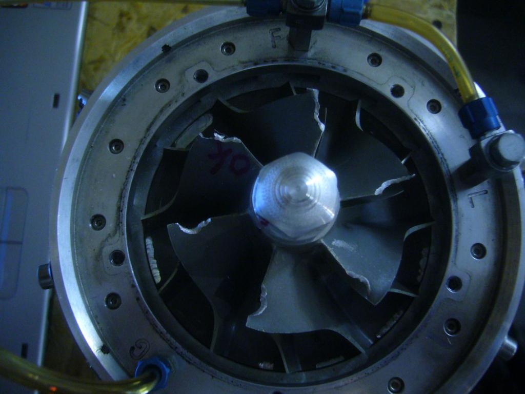

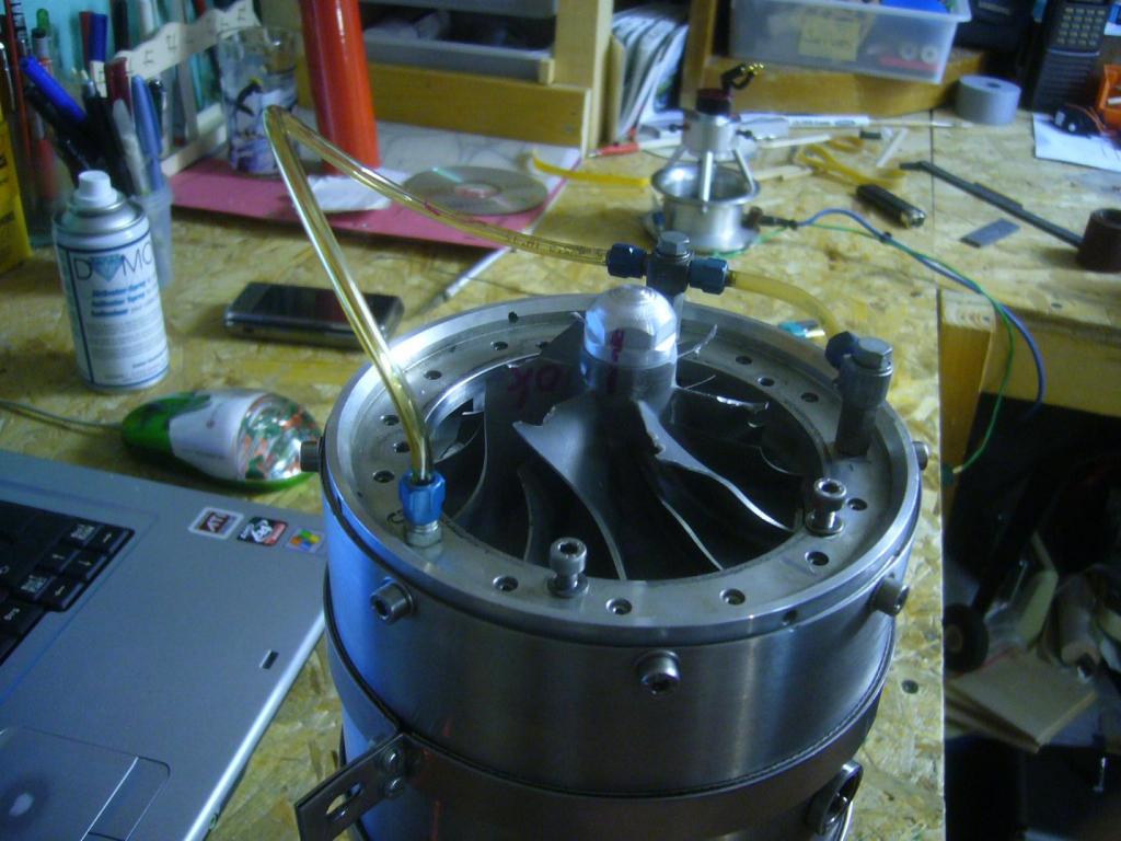

If the Compressor looks like the one on my pics, then you have a damage. This is a Olympus- but it still runs. Just a little slow acceleration @low rpm.
brosi

Normal compressor condition for 12 hours.
The P-60 compressor blades are a bit "soft" and this wear scheme is normal.
