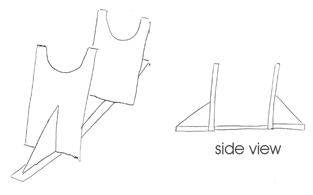

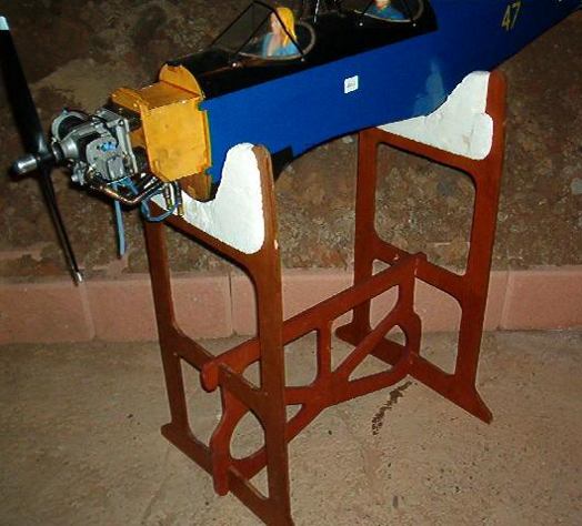

The pics show my current stand (oops, prop driven plane - how embarrasing! ) and a mod I would do if I want to have the provision to roll the model over. Basically, just removing the centre brace so the wing can swing. Obviously, the height of the stand would depend on the span of the model you wish to roll over. I would make the bottom rail so I could adjust the distance between the two uprights & removable to make transport a little easier.
I would still go with the foam inserts to support the model. It's easy to cut new ones to suit different sizes of fuselages.
To roll the model just pick the tail up & swing it over, the front support would act as a bearing on the front of the fuselage. I suppose you could make a top/bottom clamp gismo to hold the the fuselage but I don't think it would be needed. - John.
