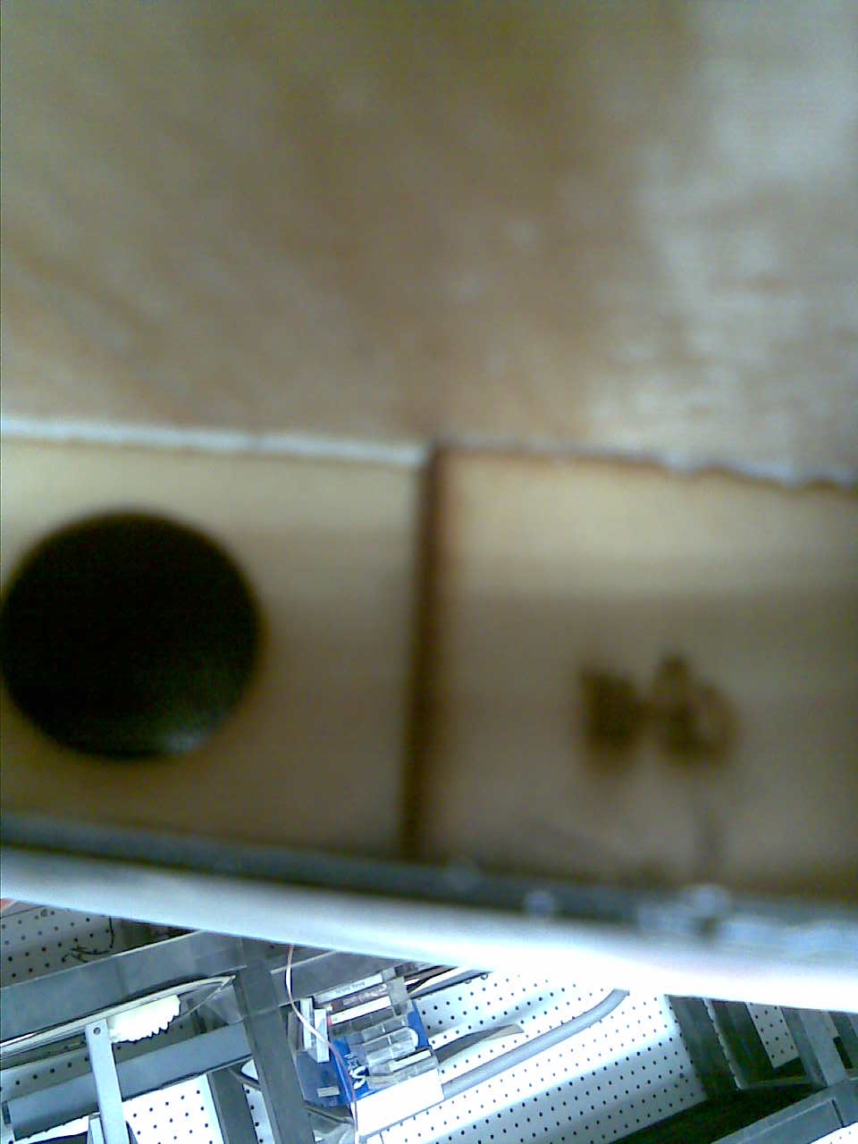

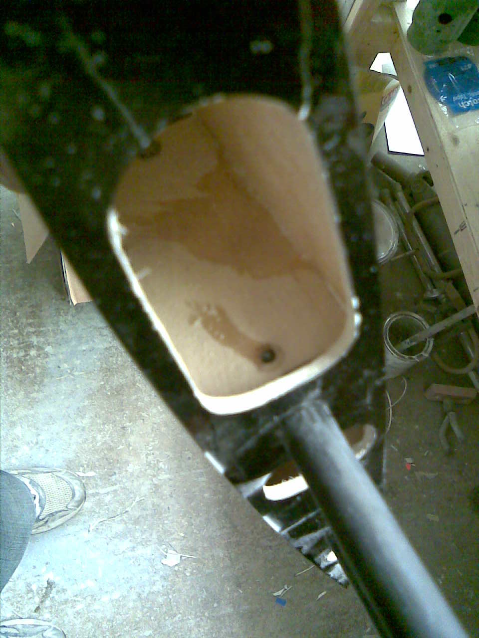

Hello guys,
After the recent thread regarding the F15, I decided to really inspect the wing construction of my Liberty. I plan to fly this jet fast and hard, as such I am checking everything as I build the airplane.
So today, I cut some holes in the wing root (or rather enlarged them) to see what was in there.
Well, I was pleasantly surprised.
First of all, BOTH wing spar boxes are plywood. Further to that, the wing root, the outer spar rib, and the next rib I can see are all plywood. There is what appears to be carbon fiber tow laid up into the main wing spar through the wing, parts fit is good, and the wing looks to be VERY strong.
There is one issue that I have addressed with James, it is an easy fix for the factory and was an easy fix for myself.

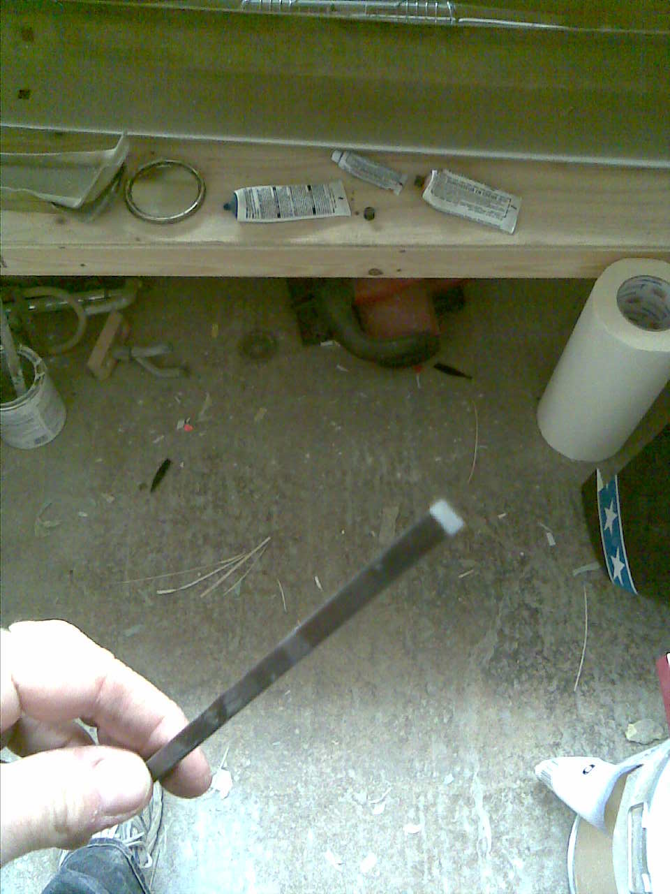

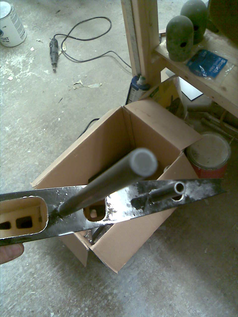

The wing tubes are bolted into the wing through the plywood spar box. That is fine except that they have put a bolt clear through the spar right at the wing root, perhaps with a carbon tube this isn't that big of an issue, but I have seen many aluminum tubes fail with holes in that area.
I fixed it by removing that bolt and gluing in a solid carbon rod inside the wing tube, it will never break there now, and I have no fear that the wing spar box isn't strong enough.
The carbon rod I put in the spar was a .250 X .200 solid shaft, since that obviously doesn't fit in a round hole perfectly, I glued balsa to the 4 sides and sanded it round to fit in the spar. I then filled the spar with polyester resin mixed with carbon fiber dust, and pressed the new shaft into the spar. The solid shaft did touch the original spar on all 4 corners, so the balsa is simply there to fill in the space.
The following pictures were taken with my camera phone so they aren't great, but the spar box and ribs are definitely all plywood.
It appears FEJ's is listening, it's unfortunate that the F15 in the other thread was lost, but from reading the end of the thread, FEJ's has made good with Uwe.
Enjoy the pictures.

Anyways.. i got to thinking about your both thru the wing tube last night. personally, i would probably replace the entire tube. Mostly b/c over time (with your mods it would probably last forever) what flexing it does get, it will slowly put stress fissures where the holes were (especially if they were not deburred, which is probably a very high possibility they were not). Just something that kinda lingered in my head all day after reading your post.

I thought about replacing the entire tube, but with the inside filled solid with resin and a solid carbon shaft, I know my tube is not going to be the failure point. I also made sure the holes that were drilled for that bolt were completely filled with the resin as well. I think that the carbon tube is probably not as critical as if it was an aluminum tube being that the carbon tube is multiple layers or strands of fiber, where an aluminum tube once it begins to fracture it will not stop at the next fiber, it will continue around like glass. I'd venture a guess that the wing would fail long before my modified tube does, glad the spar boxes in this wing are strong
