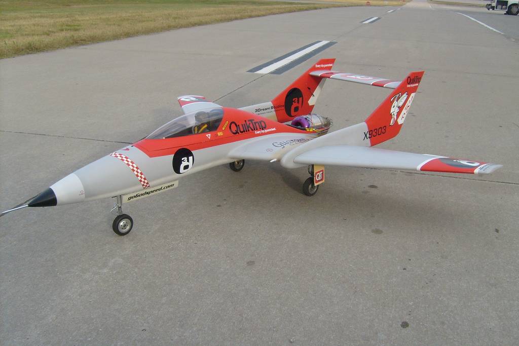

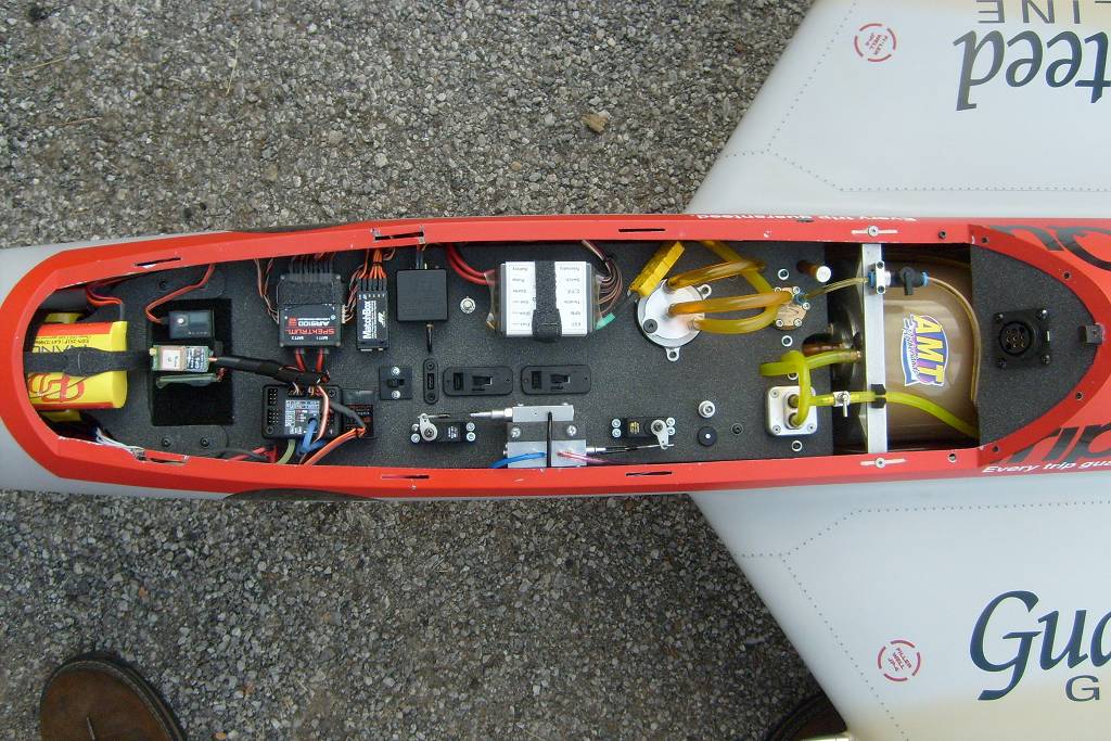

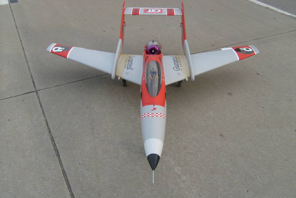

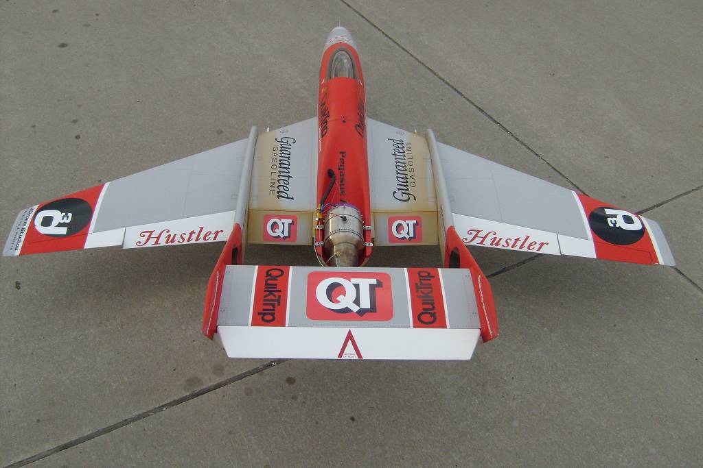

Here are some pictures of my new JMP Hustler, (new to me) I totally renevated the systems and graphics of this well used JMP Hustler. Jet is powered by the Legendary AMT Netherlands Pegasus HP turbine and is guided by my trusty JR X9303 radio with the Spektrum AR9100RX using all A123 Batteries. I updated the fuel system to carry 185oz of fuel and 60oz of smoke fluid. Also equiped the jet with the EagleTree Telemetry which gives me Airspeed, Groundspeed, Altitude and G-loads. We have seen speeds of 252mph in level flight at our secret non- AMA facility. The airplane is rock solid and a blast to fly. This is one of the strongest well built airplanes available. The empty weight is 38lb and around 52lb at take off. The airplane jumps off the ground with very little effort. I hope to have it on the jet meet circut soon..
Dennis
p.s.. maybe now I can keep up with the bandit.......
