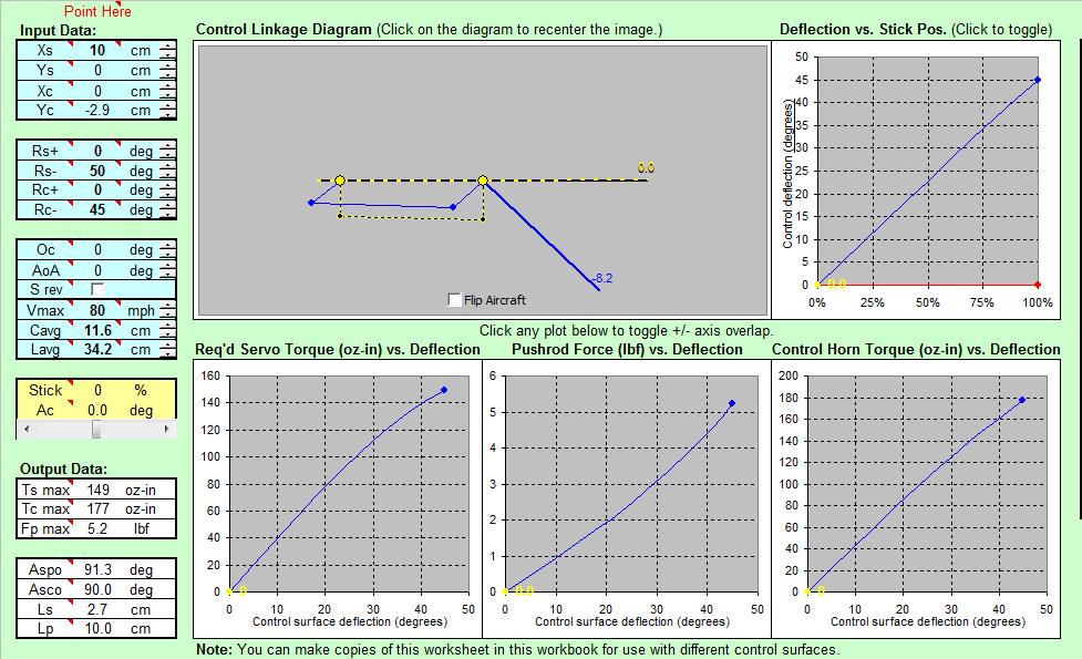

Or maybe this for flaps is better.....
I set Rs+ to 0 since there is only one side the flaps deflect to
Tassos
Tassos

Hi Tassos,
The aileron computation is OK.
You might want to input the correct distance of the servo arm axis to control axis ( input Xs ). This will get you closer to your real configuration.
For the flap computation I doubt that your servo only has 50° of rotation for the whole flap deflection. You have correctly entered the control geometry ( Rc+=0, Rc-=45 ) however the servo might move from 40 to 40 degrees for example ( in that case you would have Rs+=40, RS-=40 )
Look at what you get on your plane and copy the geometry into the spreadsheet.

The important output data for this computation is Fp max. This gives you the weight that the system is seeing at the control horn distance given in Yc.
On your example, for the aileron we have 7,6 lbs for Yc= 5,9 cm.
This means that at 200 mph, a full deflection of the control surface ( the aileron here ) will generate an effort of 3,44 kg at 5,9 cm from the surface rotation axis.
So for the torture test you will have to put 3,44 kg of weight at 6 cm from the control axis of the ailerons.
For the endurance test, you'll have to put 1 kg at 6 cm from the control axis ( corresponds to 20% aileron deflection at full speed )

Then send me the following information for each flight control:
Average chord, span and horn distance to the control axis in cm, distance from the servo axis to the control axis in cm.
I will compute the data and post it here.
Average chord: 11cm
Span: 60cm
Horn distance (control axis to ball link): 4.2cm
Distance from servo axis to control axis: 9.5cm
If you can run these numbers and let me know I will also use the spreadsheet and see how you got there. Remember, I'm trying to evaluate use of a single 8611A servo per elevon, rather than the two I have now. I would think 120 mph average and 140mph max is realistic for my flying style.
Many Thanks, Andy

I computed my numbers for the Comp-arf Eurosport's elevon(s) on the spreadsheet: Xs=9.5cm, Yc=-4.5cm, Rs=+/-40, Rc=+/-20, Vmax=150, Cavg=11cm, Lavg=60cm.
Now, the 8611 servo has 220oz/in of torque, and my figures produce a Tsmax of 211oz/in, so there isn't much safety factor at max speed and throw, but then these conditions seem unlikely for smooth, conservative flight.
At a stick deflection of 30%, the torque needed is only 80 oz/in, so do you think this setup is realistic? I haven't yet measured static servo currents at these torques.
Cheers, Andy
#50
Andy, using the metric version I get servo torque required 15kgcm, plus safety factor say 30% takes you up to needing 20kgcm. That is pretty hefty. Can you double check and confirm the average chord of the elevon is 11cm?
