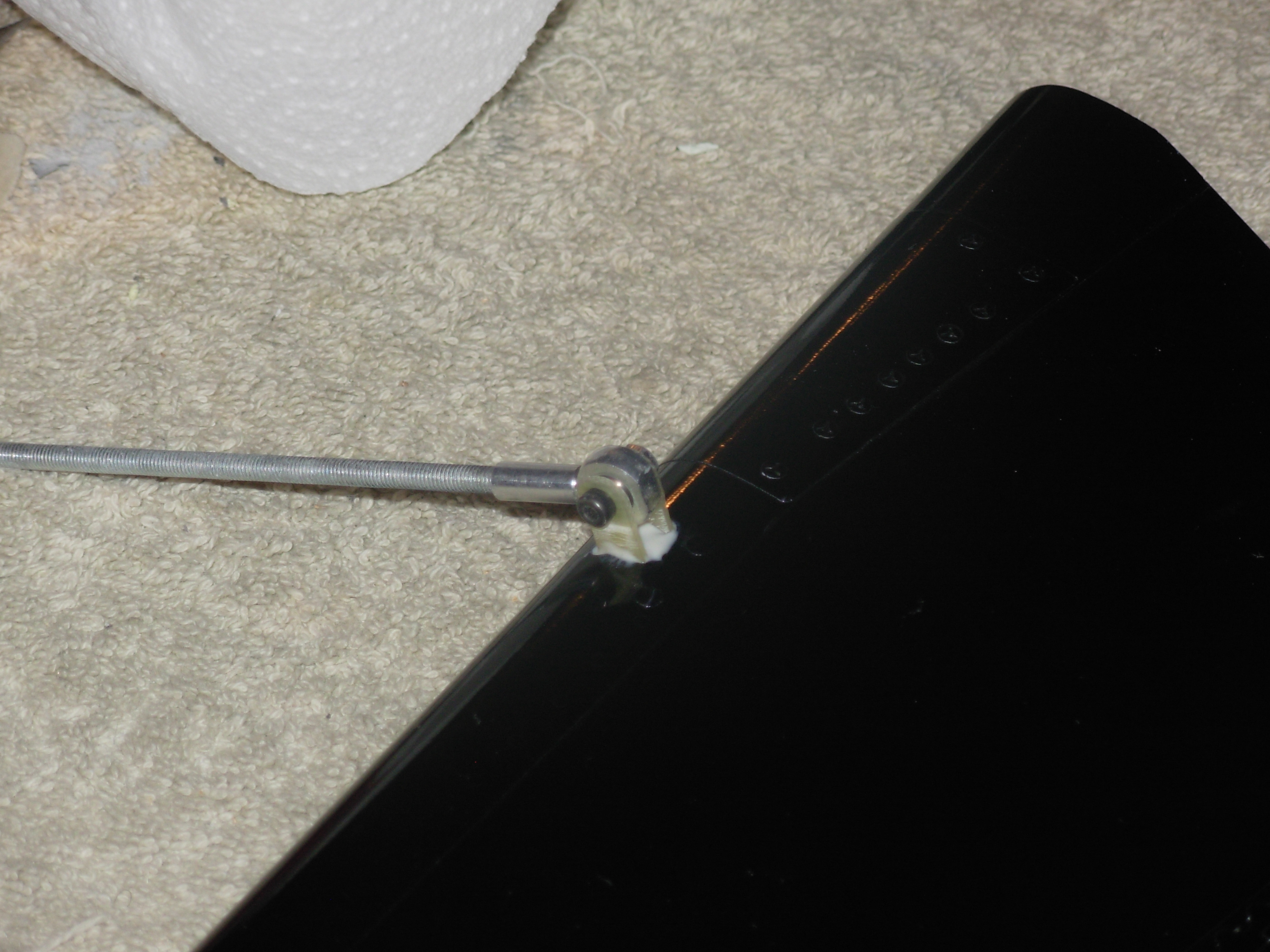

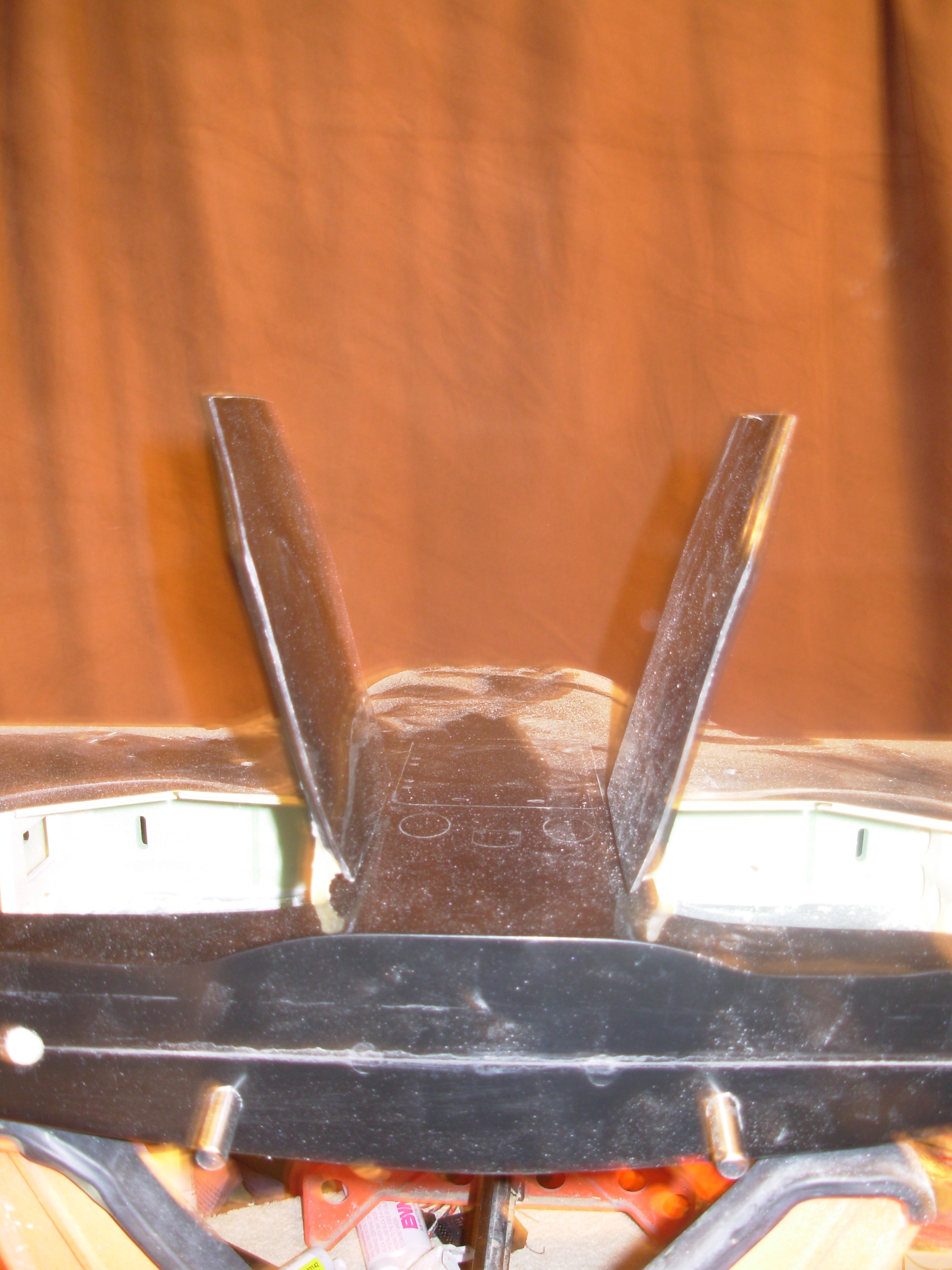

Well after having built & flown one of these Graupner Hawks and Simon bending it [sm=cry_smile.gif],it was decided to build another. Simon asked if I would do a build thread on this one, probrably so he can keep an eye on the progress of it and give me the hurry up!
This is another pre-production kit so the production kit may differ. Also this model has come with no manual or accessories so I'll be making that bit up as I go along
The kit, retracts, turbine, radio equipment & all of the accessories were through Dave @ Motors & Rotors.
I decided to start on the fin so that I can put it safley to one side.
The servo is fitted into the fin with the output arm facing upwards with an internal linkage. Its not possible to get to the output arm once the servo is installed even to connect the clevis, so I had to screw the pushrod into the clevis which was already fitted to the servo after the servo had been fitted. I hope that the pictures will explain! The control horn was aeropoxy'd into the rudder and uses a Graupner aluminium ball link to connect it to the pushrod.

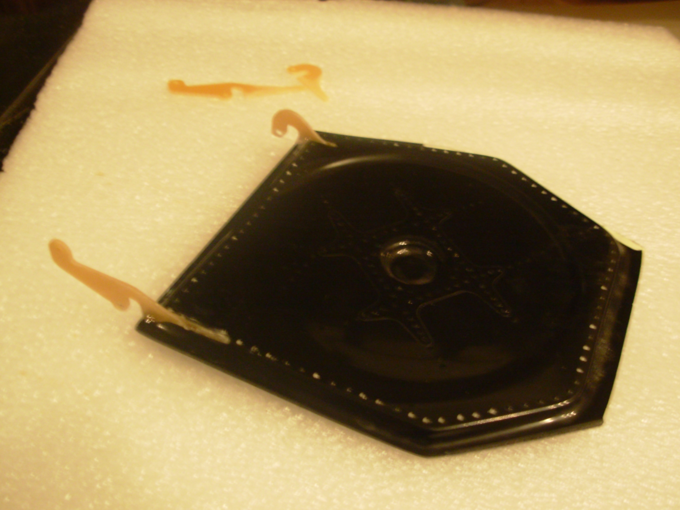

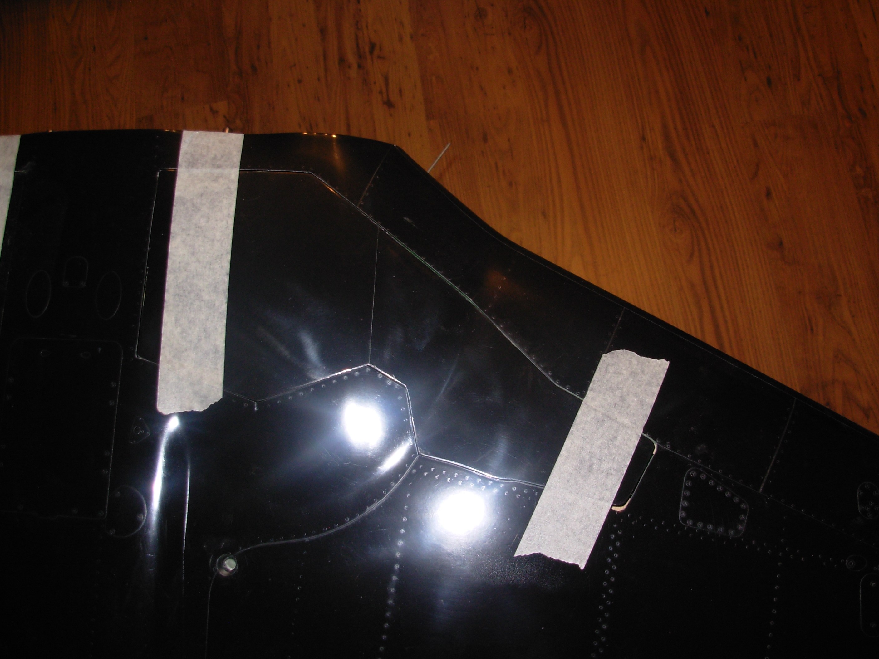

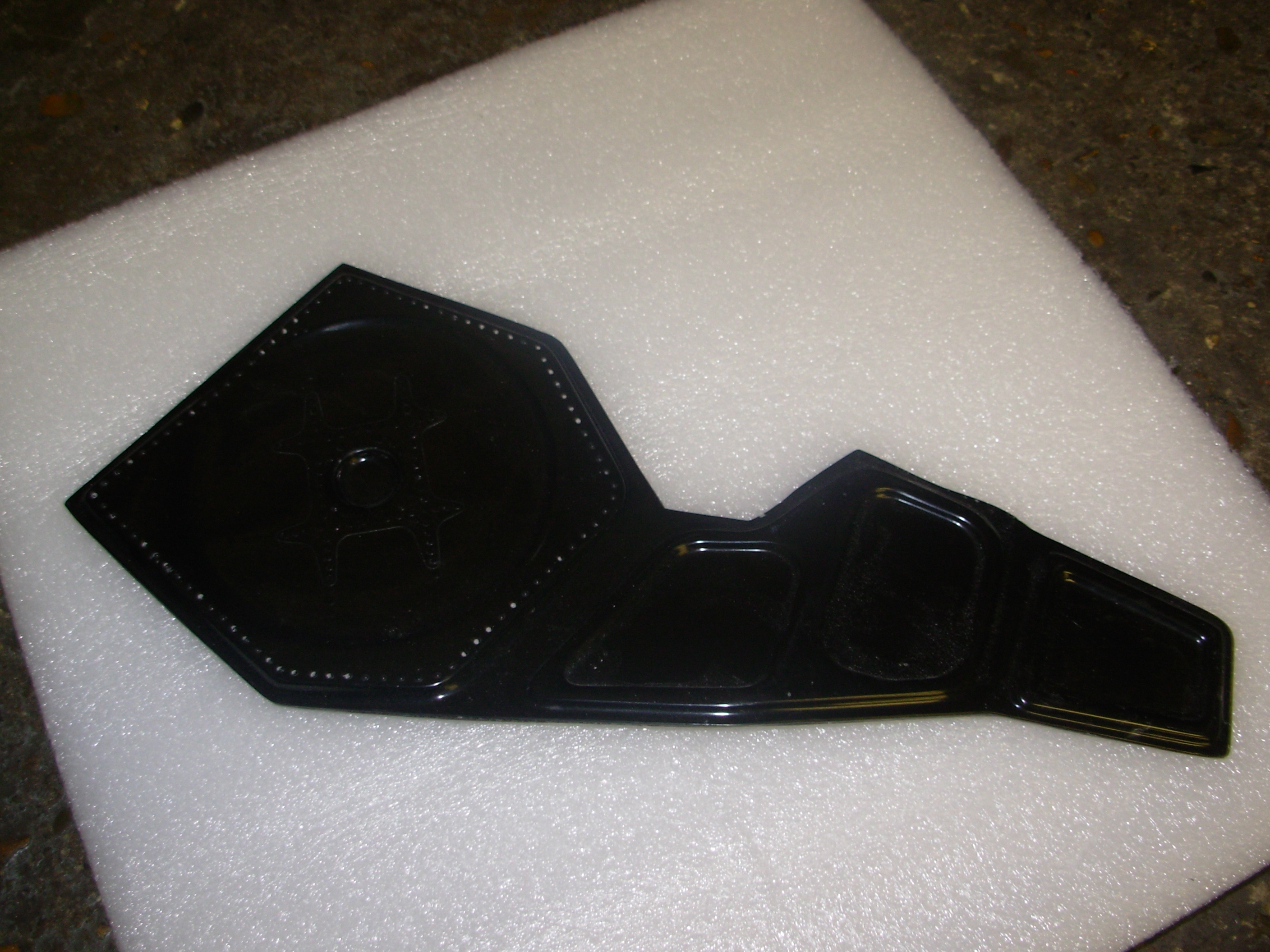

Got some more done now. I have started on the wings and the first job is to open up the wheel well opening. This is supplied as a 'lolly pop' style opening presumably so that the model can be built as a sports jet without gear doors fitted.
I left the gear doors in one peice until I was happy with fit in the wing. The wing does have moulded in guide lines for the doors but this is a little over size. I then razor sawed the gear door into 3 peices.
A door shut has to now be fabricated as a stop for the door when shut. The gear doors are double skinned so a packer has to be installed first to pack the shut away from the wing skin. I used some epoxy board for this job which was glued in flush with the opening. The gear door does vary in thickness so thinner glass board had to be glued in as well in places to shim the door shut. Thin glass board was used for the door shut which was left to protude into the wheel well by a few mm's.
Your'll also be able to see the flap servo mount in the photo.

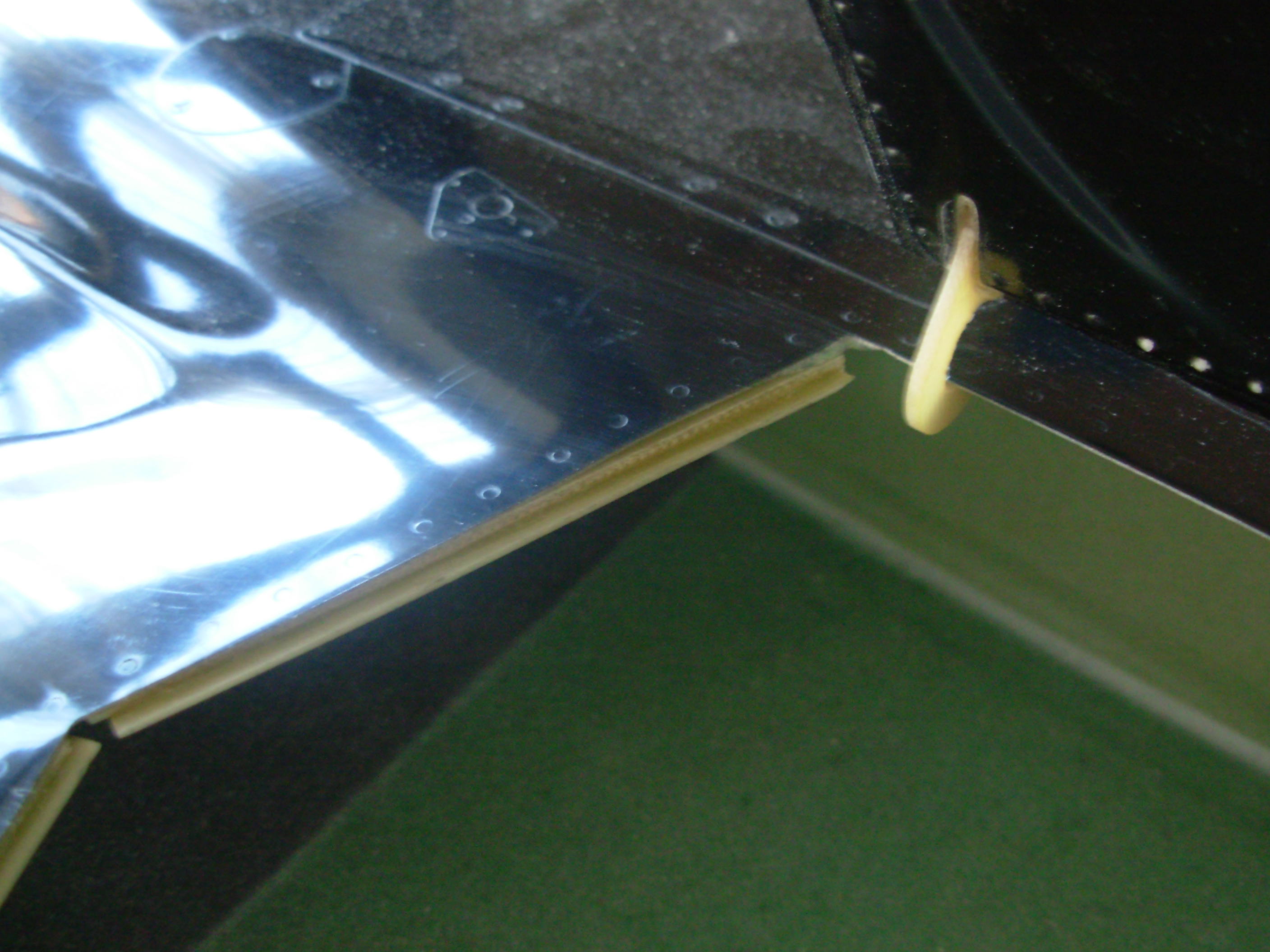

Ok gear doors are now hinged. The kit only contains one half of the hinge which is cut from epoxy glass. These are glued to the gear door after cutting a slot into the second skin of the door. A hinge now had to be made.
I used a piece of 5mm dia carbon rod with a 3mm pushrod up the middle. A slight flat was sanded onto this until a good fit was achieved (height wise) in the gear door area. This was aeropoxied to the wing skin and left to set.
I have also no fitted the air rams. The work horizontally and the supplied door hinge is designed to work with this setup. A Ultra Precision 1.5 inch ram was used.
I machined up a standoff from nylon bar which I glued into the leading edge of the wing and then screwed the air ram to this. A JR ball link was fitted to the ram door hinge and adjusted so that a minimum ram stroke the door was opened to the correct angle. The ram will not fully open but the pressure from this will hopefully keep the door shut in operation.
