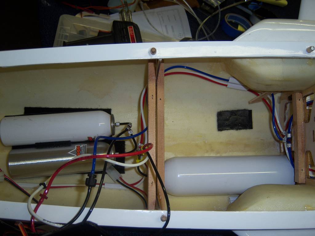

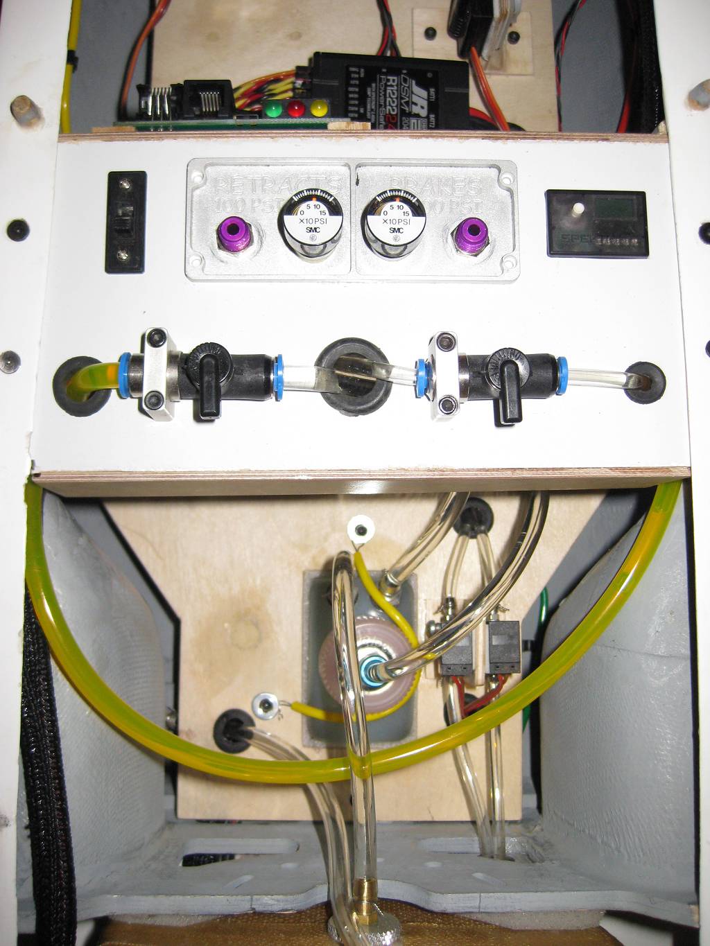

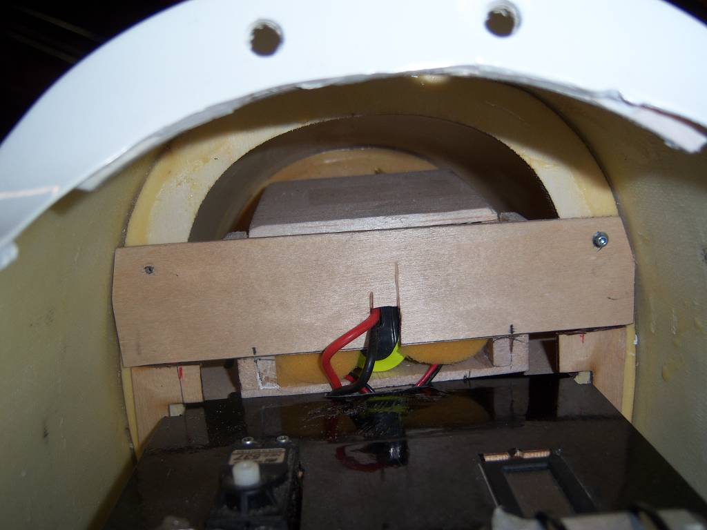

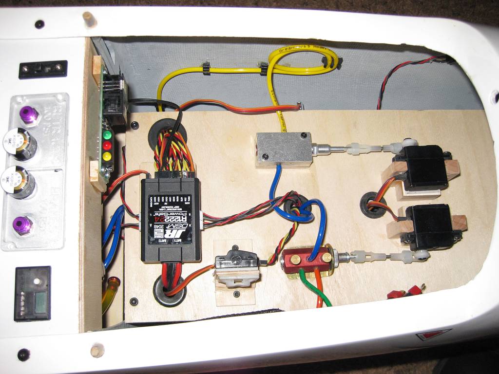

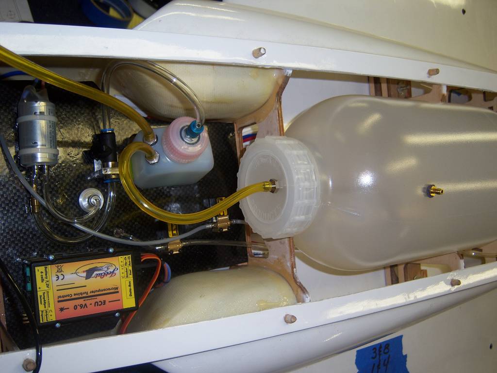

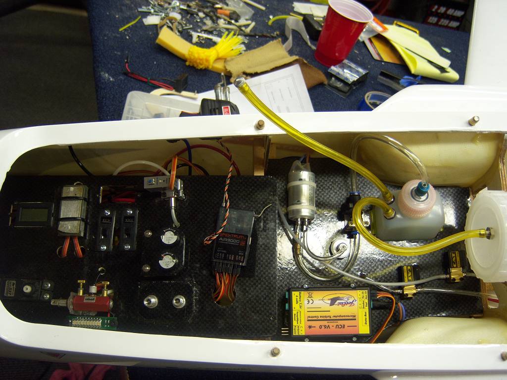

Default RE: boomerang
I use the same servos as CarsII in my Boomer XL and powered with a P-120......
hope these pics help, also I built a battery box and put all 3 batteries above the nose gear and that helped alot with the balance. you will enjoy flying the jet.
Mark
