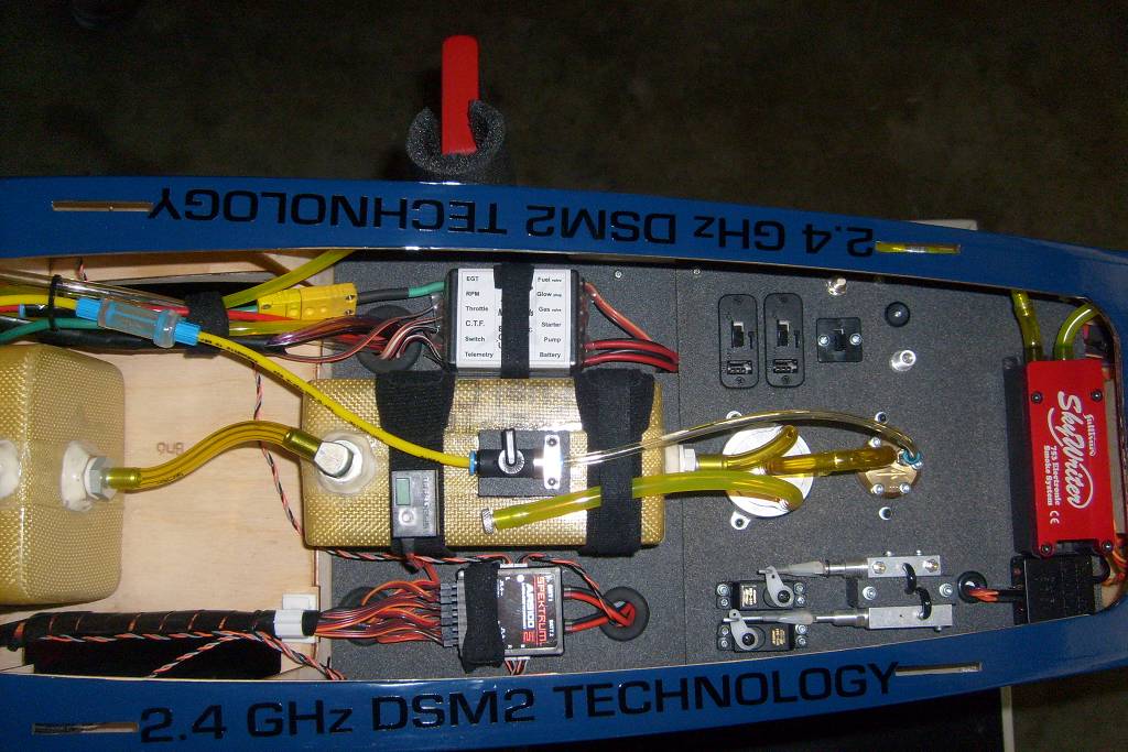

What we are using currently when done right works perfectly. It is easly to do PM on the system as well as the install is pretty straight forward. I have over 200 flights and never a hickup from fuel delivery. Don't need to re-invent the wheel here. A clean install really makes the differance.

They are different until you have that 'runaway pump' or other problem and you shut the valve. With the proposed idea the valve must go on the pressure side of the pump which is usually just before the engine as shown in Mike's (lovely) install.
Then there's no 'relief', the pump would be pushing against the second tank & the UAT if fitted. The first (main?) tank is, of course, vented. - John.
