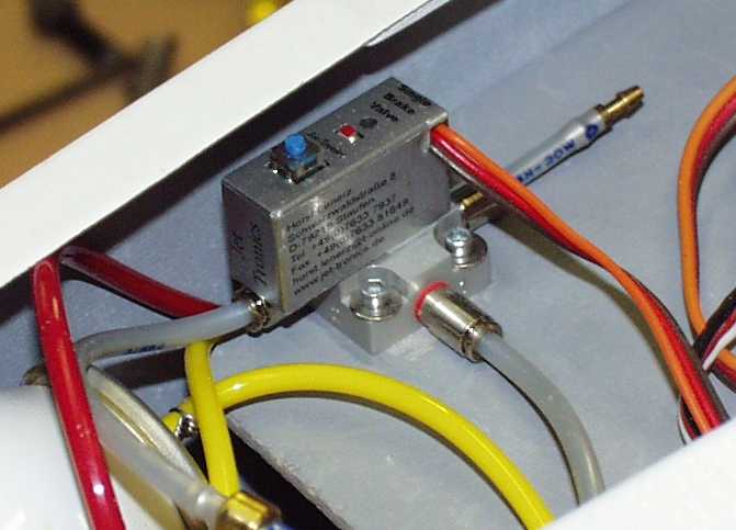

by any chance does anyone have a picture of the new Jettronic brake and retract valves next to something for size comparison?
I have yet to see the new valves in person and was just wondering how small they actually are.

I thought there might be a pic of the laest valve on the Jetcat web site - but unfortunately their we site is not working properly right now - you get an internal server error of you try to access the pages for the brake valves.
If no-one else posts a pic today, I'll try to take a photo of my Jettronic brake valve when I get home. Ballpark estimate going from a frequently fault memory - main body of the valve is maybe 1.25" square and 1/4" thick, then it has a "foot" at the bottom for mounting, plus festo-style connectors sticking out in 3 directions. You do need special 3mm airline for it though - "regular" airline will not fit.

Gordon,
A pic would be great. I already have some of the black valves in my planes and wondered how big the new ones were in comparison. I am planning the installation of all my equipment in my bobcat and just wanted some idea of sizes.

It's definitely smaller than the black one.
Pic attached. Measurements of the rectangular "body" is just over 1" ; height is just under 1" ; thickness 3/8". The base sticks out just over 1/8" extra. Total footprint including the Festo-type connectors is 1 1/2" x 1". To that you must allow some room for access for the airlines (for the next generation valve, it might he handy if they were to to put all 3 connectors on one side, so that you don't need to account for some room on 3 sides of the valve).
