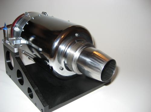

Do the Hawks have screw on tailpipes? Looks like they are threaded at the end.
Andy don't think so, just the way its manufactured - interesting the fuel feeds are via Festo's mounted into the machined mounting brackets, so no feeding fuel pie through bypass cases
marcs
