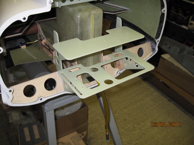

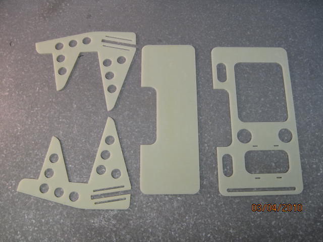

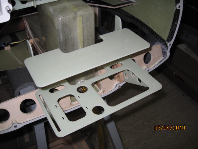

Today I have picked up some revised equipment trays form the cnc shop, my original hand milled ones were not quite right and made it difficult to remove them with the smoke tank in place, so I redesigned them.
I had them drawn in DXF so the items could be cut from any material required, I use FR4 or glass board as they need to be strong as they replace the wooden towers the gear door cylinders mount to as well as holding all the key equipment.
The two trays will hold air valves and sequencer, powerbox/Rx's and ECU, together with connection to most of the air supplied hardware. It fits to the wood rail which runs across the front of the rear fuselage section so keeps the electronics with this section when split
resulting in less connection to remove when the plane is split for transport or storage. Individuals can further lighten the decks as they require.
These fit the Skygate Hawk, if there is sufficient demand I will do the same for the Tomahawk Hawk.
If anyone would like a set in ply or FR4 please let Ali know, he will be able to give you the details.
marcs

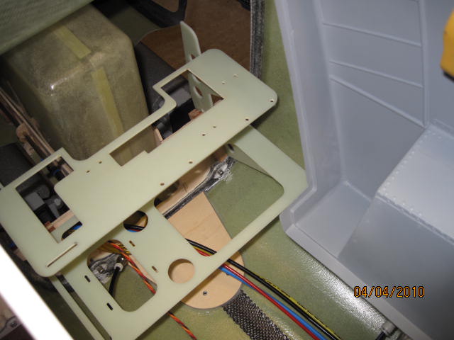

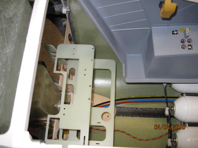

Marc,
Will these clear the rear cockpit ejection seat?
David S

Default RE: Skygate Hawk & Tomahawk Hawk ducting
David, they sit in the space behind the rear angled cockpit panel so do not interfere.
marcs
