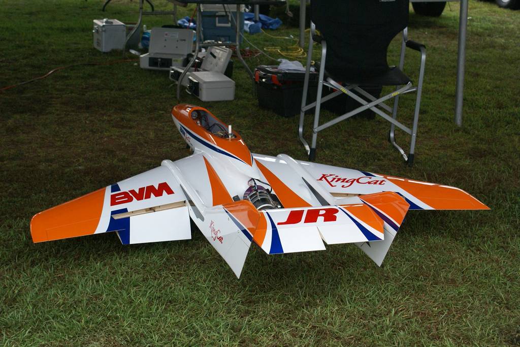

Some of the very early production KingCats had some boom problems...ask me how I know.
I cracked one boom almost in half one day *(about 2004), and was very lucky to have landed the airplane without further incedent. I replaced the booms, and later repaired the damaged one.
BVM came out with an A.D. that added the carbon fiber patches to the exterior of the boom skins, which solved the problem.
The current production booms are strong enough to be used as crowbars, but there is no sense in subjecting the airframe to high stresses....keep the speed down to a respectable level, and hold the "G's" down.
Buck has good advise on the topic, and I would listen to it and observe it to have a long and happy airframe life.

I bought the kit in 2007 but i think its probably the early generation KCs which had issues with the wing alignment/ phenolic tubes and the kit came with a AD from BVM how to fix it so obviously it was manufactured by CARF in Thailand.
The booms also had a sticker on them saying that modifications had been made to strengthen them.
Strangely I dont see any reinforcement on the exterior like Harley says.
I do feel a little movement in the Booms/wings when I pick up the airplane but I thought thats normal.
Im not really looking to push the airframe to destruction , but Im kind of bored with just rolls , immelmanns , high speed passes etc and would like to try a high speed pass , pull up and snap- something a little more spectacular.
Xantos

You can see the carbon plates on the boom surfaces in the attachment. There is also a 3/8" wide strip about a foot long covering the bottom seam below the trailing edge.
These booms also contain inner reinforcement as well. They are second generation CARF booms that are much stiffer than the first generation booms.

Am I right in assuming that the re-enforcement of the later booms was eventually not a visible band-aid, but internal?
Old 04-07-2010 | 12:26 AM
Joined: Apr 2003
Posts: 394
From: MumbaiIndia, INDIA
Default RE: How Hard can you push a Kingcat ?
Hi,
My booms have nothing visible externally , so Im assuming its been taken care of internally
Xantos

Not to throw fuel on the fire but don't assume that they were done internally. The C-ARF work towards the end of their time was sub par. I broke a set of booms in flight on one of the last kits that came from C-ARF. These had the external plates, and one of them was found at the point that I did a hard pullup for a square loop. The airplane should have a BVM serial number in it and your best bet would be to call BVM. FWIW my hard pullup was at close to full throttle. I flew mine hard and a lot, the first two were built by me and painted with the second one having some additional reinforecements to the booms. The latest generation of KC's you could likely chop down a tree with the booms.
