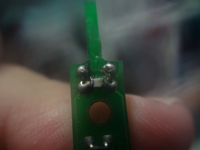

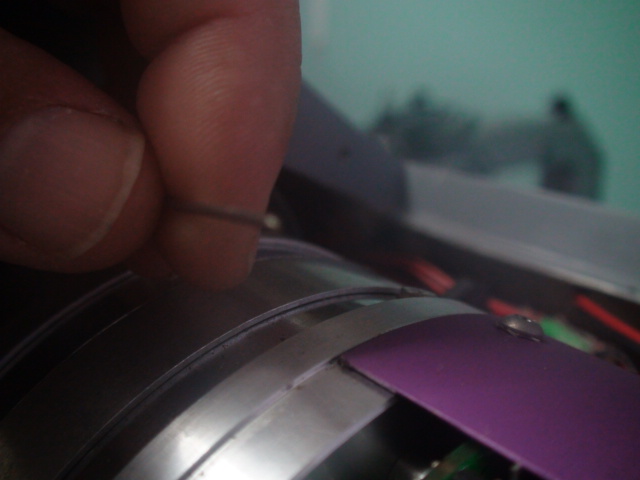

My Jet Cat P-80 temp sensor wires are broken. I realized it because a temp error displayed in the GSU.
Has any of you had this problem?
Can I solder both wires from the temp probe to the circuit board? (Maybe I need short extensions)
Can it be copper wires? Or should the be the same type of wires used in the sensor joint (termocouple?)
Can it be tin solder used to solder electronic circuit board?
I have also made this question to Jet Cat
See pictures

dont risk it
order a new sensor from jet cat.its not expencive
my 2c

The wires in the sensor is very fragile, get a new one, they are not too expensive.

These are fairly inexpensive, and you could do a temporary swap, they are the same except for the P-60 and the P-180/200.

I have already ordered the sensor from BVM but as I live outside the USA, my jet will be grounded (but safe), this weekend.
