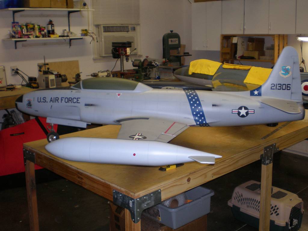

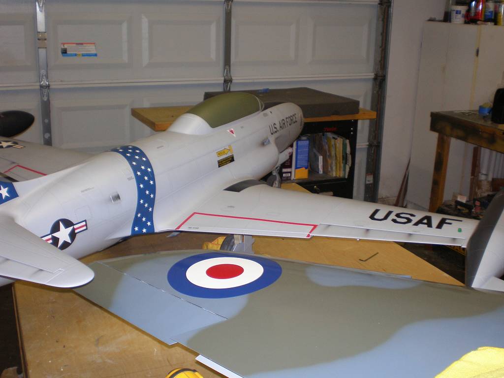

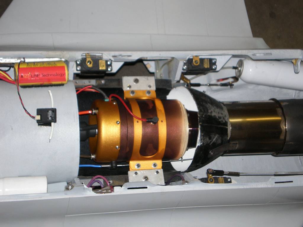

My new JMP t-33 with a k-80 installed is flying great with this set up. The T-33 is 25 pounds dry

Mike is that the Kingtech turbine? Long time no see, you awright?

Yes, Kingtech K-80 Yes we are ok here water was almost in the house.

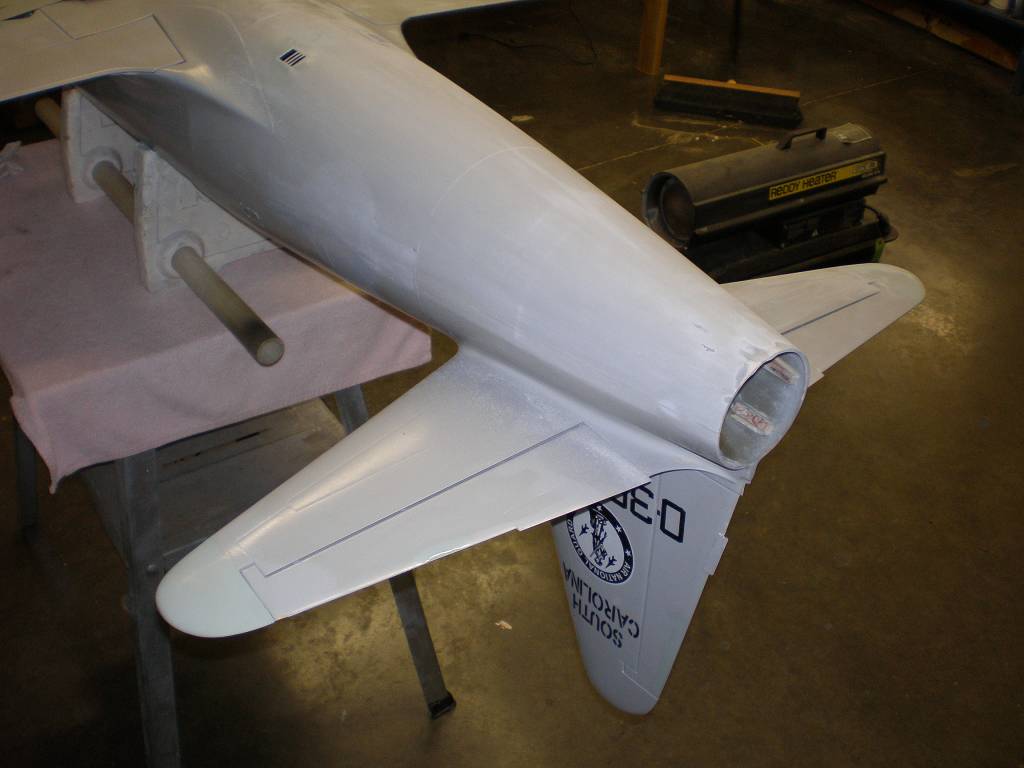

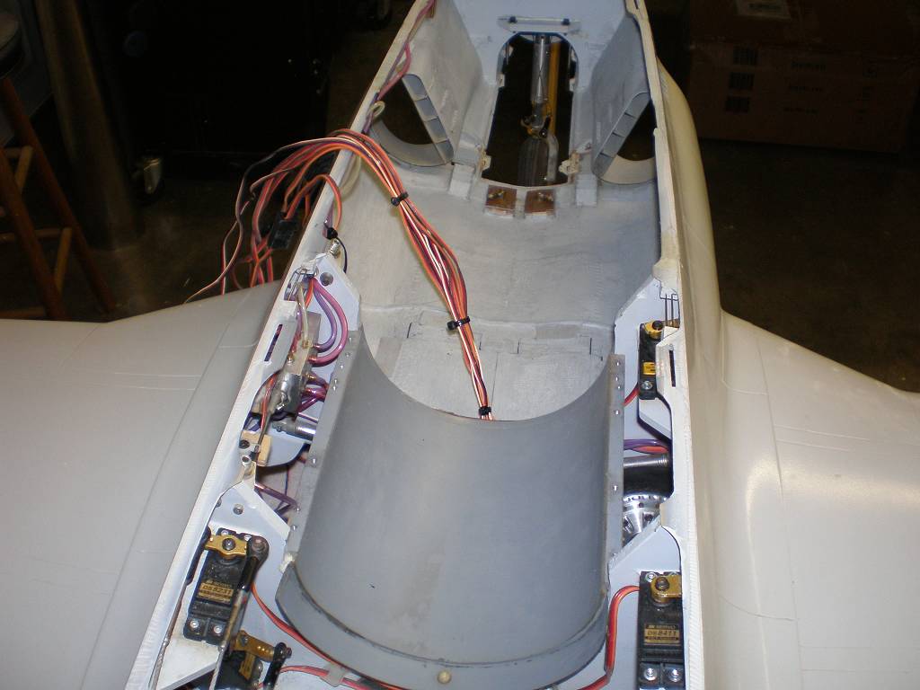

I removed the old JMP pipe it was 2 pounds 5 oz. I had Tam make a new one and it came in at 14.5 oz and I also removed over a pound of nose weight and installed the smaller turbine and is flying great.

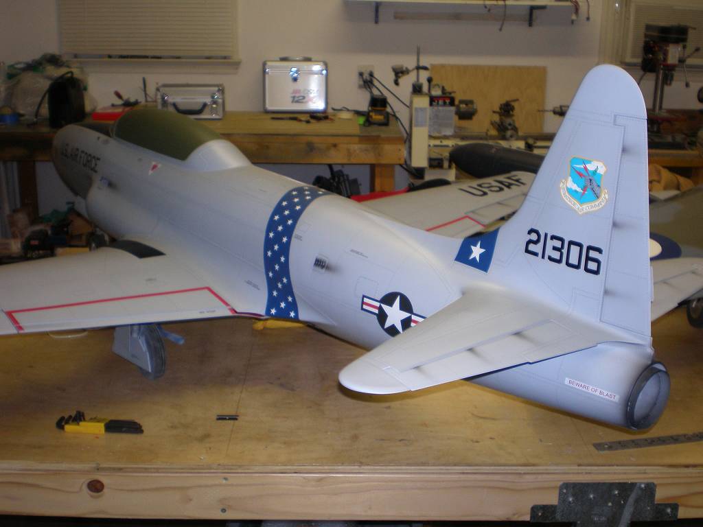

T-33 New paint Job
