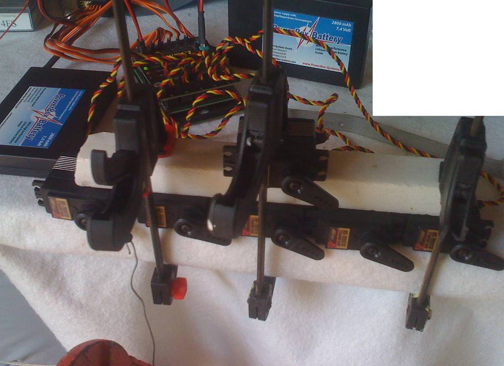

Doug
i just finish moving testing 20 of mine ...each one unter load for 15 20min
6v from powerbox
they got litle hot but no promblem at all
sorry fot yours man
best regards
George
