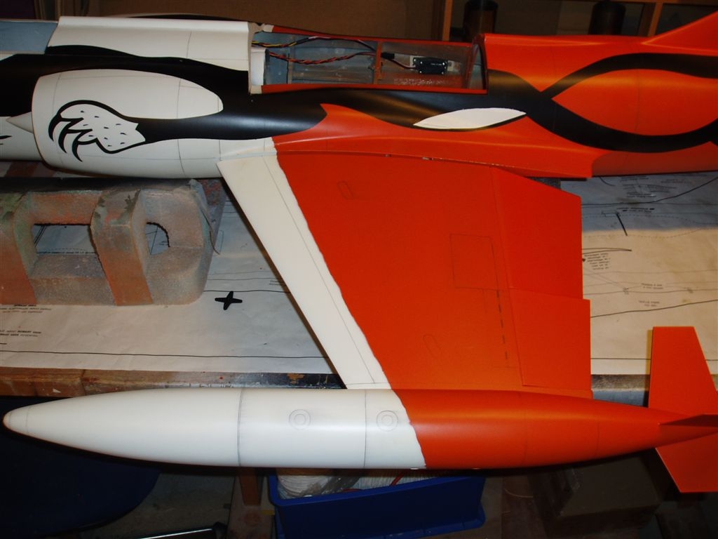

more pics.

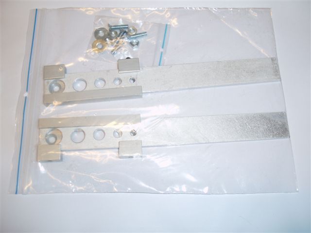

Thanks for sharing your build pics! It all helps to visulize certain areas. Where did you aquire the aluminum blade wing joiner and socket (your picture attached below)? Looks a lot like the kind that Yellow Aircraft offer.
Also, did you add a rudder to yours? If not, do you wish you had? If you did, any pics of that? I bought the items to do this from Philip when I ordered the kit.

The wing joiners are also from Philip Avonds. No rudder needed. Even a moderate cross wind is no problem. Just remember to not pull up elevator when rolling, before you have enough speed for take off, and also to let go of the elevator after touch down.
I did make rudder on my first F-104 that I built and sold 7 years ago. Never used it. (Sorry no pics)

Thanks again for the lead. I ordered the blades from Philip this morning without any problems. Just over 30 euros inc shipping if anyone is interested.
Can you post a couple close up shots of the wing root and of the same location on the fuse? Did you tweak the location of former F6 or just open up the slot in the wing to accomodate the new joiner location? I'm also interested in how you keyed the flap actuation (I assume you left the flap servos in the fuse)?
I like the upgrade, thanks again.

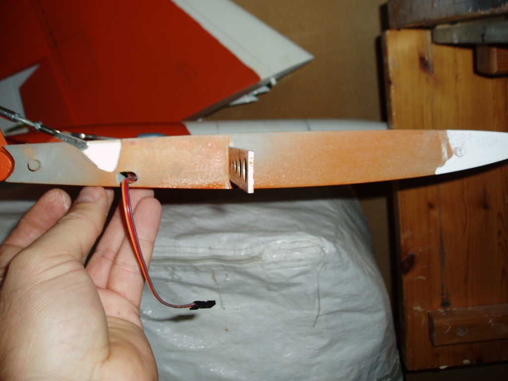

With the detachable wings, how do you drive the flaps? I have an original model with permanently attached wings, the flap servos are in the fuselage and the flaps are driven by torque rods coming in from the wings. Do the modern wing kits have cut outs for flap servos to make it easy to use detachable wings, or do they still use torque rods and you have to connect them after plugging on the wings?
Harry

Here are some pics of the wing root and the fuselage. The flap sevo is installed on the inside of the fuselage, with the servo arm protruding through the fuselage. So, when pushing the wing to the fuselage, I mount the pushrod to the servo every time. I have made horns on the flaps from 2,5 mm fibregalss board. I hope the pictures explain the method. ;-)

Thanks for kindly posting a couple pics. Your method is easily understood and very simple. Any other suggestions or recomendations for this model? ie. if you built another is there anything you would do differently? Anything you changed that you would do again?
