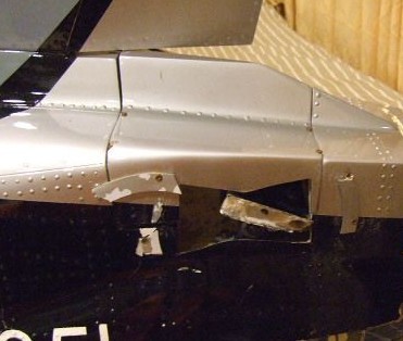

I am new here. but want to show some pictures here. how do you think about pictures (skymaster Hawk elevators)?
after saw this, i want to check mine. You must check yours too.
Ben</p>

OUCH
Were you pulling when she failed

It looks like the small SM Hawk. How old was the model?
Dosent look very nice in that stab.

That cant be the al the detail, there seems to be no structure in there. Something is not right.

I have contacted this customer from Taiwan. He bought the small hawk over 2 years ago.He has flown over 50 landings but had many bad landings.
We asked him to send the elevator back to factory. Then we will check out what the problem is.

After seeing that video, I'd want to strip the whole airframe and check everything.

It looks like the whole structure is made out of Epoxy and microbaloons / earocell .....no built up structure is present i.e composite laminate combined with structural ribs or spar to take the load....it's a miracle it lasted that many flights prior to failure.
Makes one wonder what is hiding under the skin of some these models.

Hey a simple piece of ply through the centre into the stabs would help a lot.

Based on those hard landings it was probably cracked before failing in flight.

Plywood is also a composite (of wood and glue) Which is why wooden, solid or laminated props are even found on fullsize aircraft, even U/C. But no props are made from microbaloons...
The problem (if there is one) could be that the sharp corners of the box structure is unsupported and therefore it will tear easily, especially since one edge is on a joining seam. Composites like glass and even worse Carbon tears very easy. They are very good in tensile but not shear or pressure. For tear resistance kevlar is used. In this case a support spar or even more layers of glass in just that small area will solve the issue. But the landing damage clearly played a part.

I am amazed the jet lasted for 50 landings before suffering structural failure. He has no grounds for complaint whatsoever.
