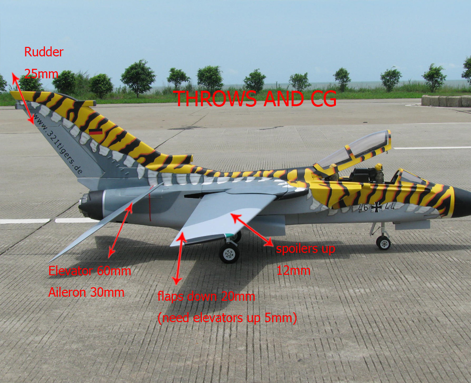

Hi
Does anyone know where the center of gravity of the FEJ tornado is?
Regards
Julius

It's going to be just in front of the pivot point most likley. All swing wing aircraft are designed with the pivot point as close to the neutral point as possible, to prevent huge changes in trim when swinging the wings. Best would be to check with James at FEJ.
