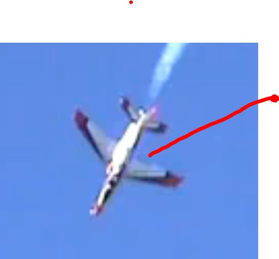

Hi guys,
Maybe one of you can suggest what happened here:
http://www.youtube.com/watch?v=LZpv0O1ubMs
.... to end up looking like this:
http://www.youtube.com/watch?v=D3MGph6-6XY
Cheers
Jan

Something induced the spin, looks like lockout or flight control failure. I wonder what the ECU said. It would tell you if it was lockout with a failsafe count.

Personally, I think the model is flying too fast for any sort of tip stall and the pull out looks fine for it not to be a high speed stall. I if I had to make a guess I would say one side of the elevators or flap failed and returned to neutral resulting is an slow type aileron roll. The roll rate looked slower than an 'aileron' roll and slightly 'barrelly' which would support that thinking???
What servos/linkages were used on the elevators/flaps?

Between 47/48 seconds (freece the frame), you can see atleast the right hand flap is down.
Maybe this induce the spiral stall?
It's hard to see if the left hand flap is also down though.

Sorry if I am going to upset anyone here, but that was clear pilot error.
Too slow, too low and too much elevator. To me it looks as if the loop was started too low and with too little speed. As the ground is rapidly approaching on the 3rd quarter of the loop the pilot heaves on the elevator to arrest the decent. At the speed he was going, and with the drag he had in the gear being out all this did was cause an aggressive stall. This leads to a departure ( Wing drop ) and the ensuing spin.
Other factors to consider are the weight of the model at the time of the crash. I see a beautiful paint job, smoke. Both things which will add to the overall weight of the model, thus increasing the wing loading and stall speed.

From a professional pilot's point of view, you did what is called an accelerated stall. Do a google search on the term. But, basically, an airplane can stall at any attitude, when the wing's angle of attact exceeds the relative wind over the wings.

Accellerated Stall - The accelerated stall usually surprises a pilot because it occurs at a higher airspeed than a normal stall (in which a wing loading of 1 G is maintained). Remember, a wing can be made to stall at any speed—all that has to happen is for the angle of attack to get high enough. As G-loading increases, so does stall speed. If a wing reaches its critical angle of attack when the wing loading is 2 G, twice normal, the stall will occur at a speed that’s proportional to the square root of the wing loading. The square root of 2 is approximately 1.41, so the stalling speed at 2 G will be 1.41 times what it would be under 1 G conditions. Accelerated stalls are often caused by abrupt or excessive control inputs made during steep turns or pull-ups. If you’re in a dive and pull back with enough suddenness and force to load the airplane to a typical design load factor of 3.8 G’s, you’ll enter an accelerated stall if the airspeed drops below 1.95 times the stall speed at 1 G loading (the square root of 3.8 is approximately 1.95).

As any pilot who has practiced accelerated stalls in a full sized airplane would know, you roll the airplane to a 60 degree bank and pull hard on the elevator. You will feel the buffet. When you release the back pressure the buffet stops and you can fly the airplane away from the stall.
Unfortunately In a model we are not given that second chance as we have no warning of the impending stall. It's over very quick.
I have been flying all kinds of models for many years, three months ago I had my maiden flight on my SM L-39.
Plane flew perfect for two minutes. In a tight bank which I thought was not to slow, I pulled on the elevator to tighten the turn (I set elevator throws to factory specs). It was over very fast. As someone said in a previous post, I stood there in amazement not understanding what could have happened. an Accelerated stall is what happened. Full fuel, 33 lb airplane, 68" wing, to slow, to much elevator in the turn. BAM! Over very quick, was for me.

It looks as though the left flap is fully down at the 44 sec mark of the video...right before the hard left into the spin.
