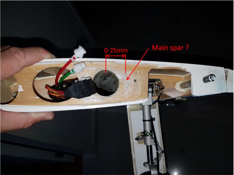

I am building an Xtremejets 2m Viperjet and I am getting a bit confused about the location of the CG.
The manual states 25mm in front of the spar, which seems to be located behind the wing tube, while in many forum topics the wing tube is taken as a reference.
Can somebody who knows please confirm that my assumption is correct ? I added a pic for clarification
Thanks in advance,
Ro

Should be in front of the tube, I flew mine at 15mm and liked it a lot till a dead stick killed it.

Mine seems perfect just on the leading edge of the wing tube.. !

Mine is on the leading edge of the wing tube!
