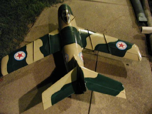

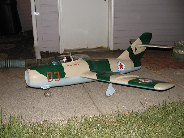

There is a dynamx conversion out there for the Mig 15 . It comes with necessary glass work to cover the hole in the bottom of the plane and the necessary mods to make it work. I have mine with the Dynamax and os.77 . havent flown yet breaking in the engine . Here is a pic

Old 07-28-2003 | 08:11 PM
My Feedback: (101)
Posts: 5,828
Received 6 Likes on 6 Posts
From: Bennington, NE
Default conversion
heres another pic, notice no hole
