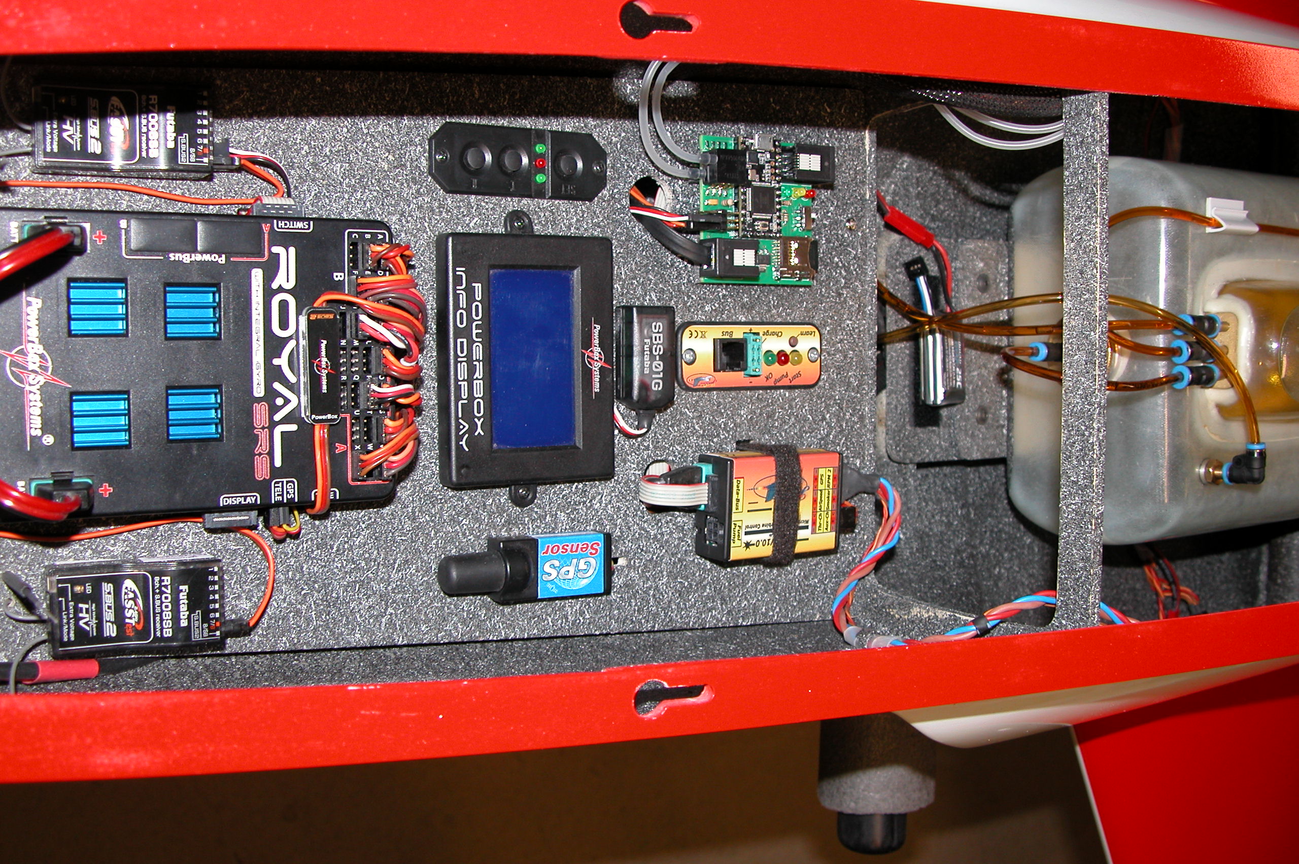

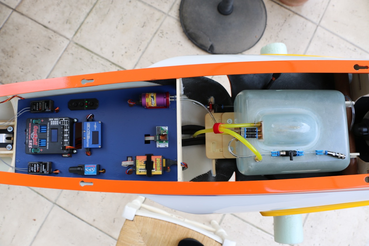

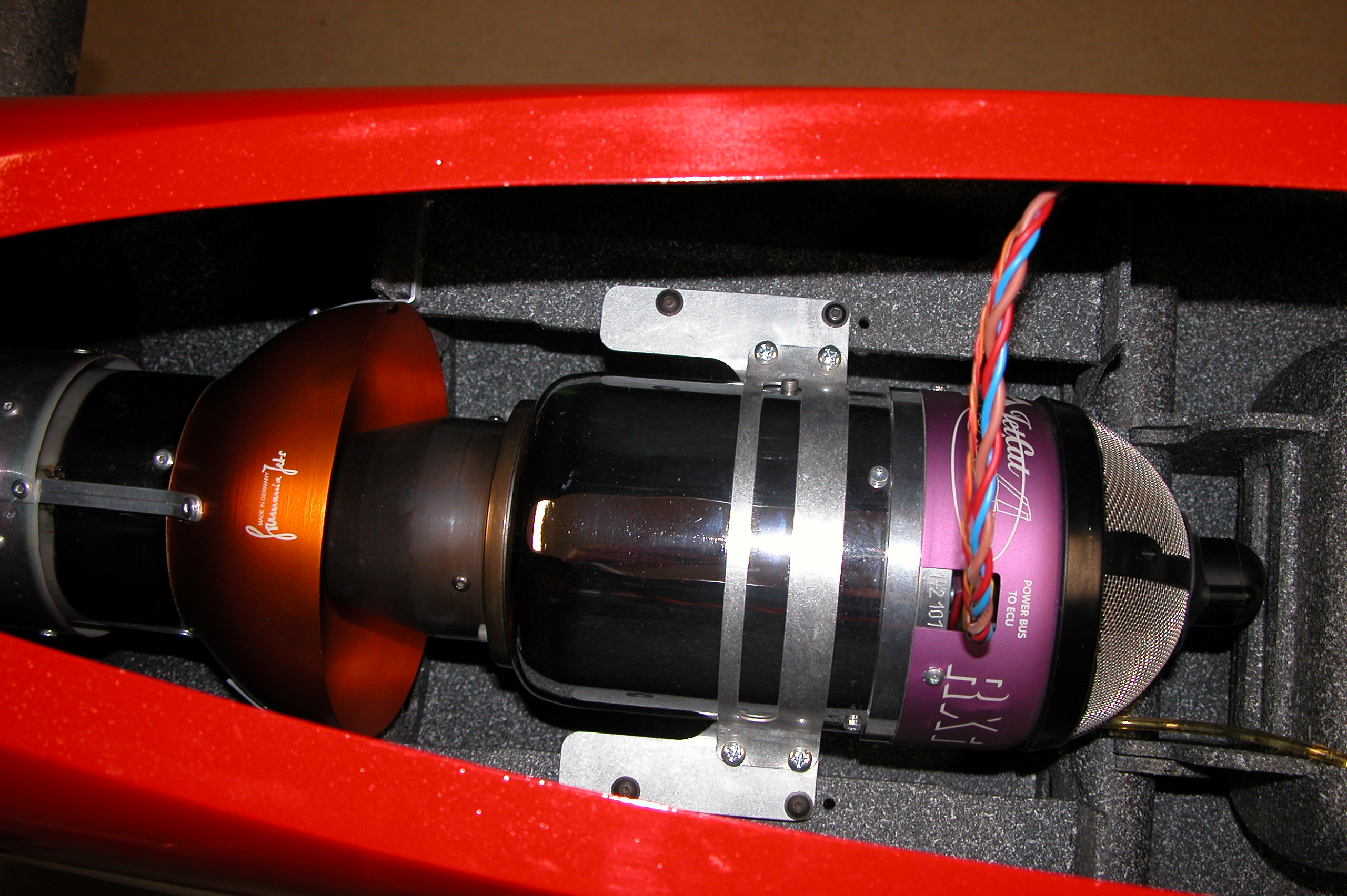

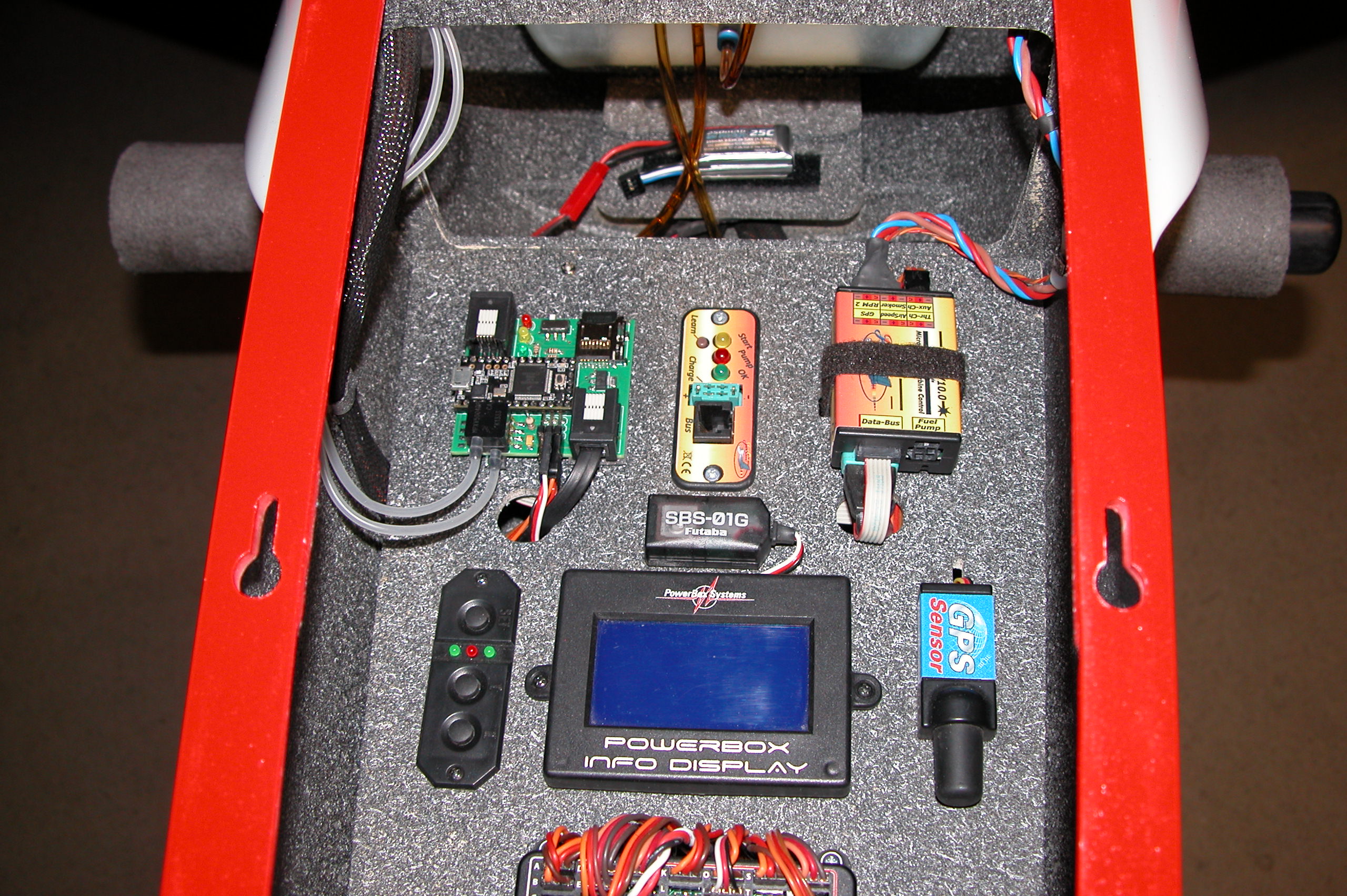

Rafale Sport 09-15-2014 02:17 PM
2 Attachment(s)
I ordered mine pre-assembled to stage 3 (and painted) therefore I cannot comment much on the build itself. I had to install the servos, radio, retracts, tank and turbine (easy stuff).
I used BLS452 servos and had to slightly adjust the size of the mounting ply to be glued on the servo hatches, the cut fits for Savox originally. Also I had to do minor ajustements to fit the retracts in position. I replaced the 2 screws securing the wings onto the fuselage by 2 home made screws that I can screw with my hand only, this is much easier than using an allen key in the small space available. Then you will need more than 2 hands to glue in place the large canopy onto the top hatch... Other than that I can't recall anything but just following the documentation. The CoG is just spot on as well are the servo recommended throws and flaps to elevator mix. Here are some pics of the inside before I replaced the 140RX by a 140XBL due to a failure of my brand new jetcat... I believe my CoG is even more backward since the different position of the 140XBL vs the 140RX. On inverted flight, there is very little need of down elevator to maintain the level.
I found the 3,2 liters tank a bit too small, I gives only 6 mn of flight autonomy (with a reserve of 1mn to land), I think I'll upgrade to 4 liters soon...

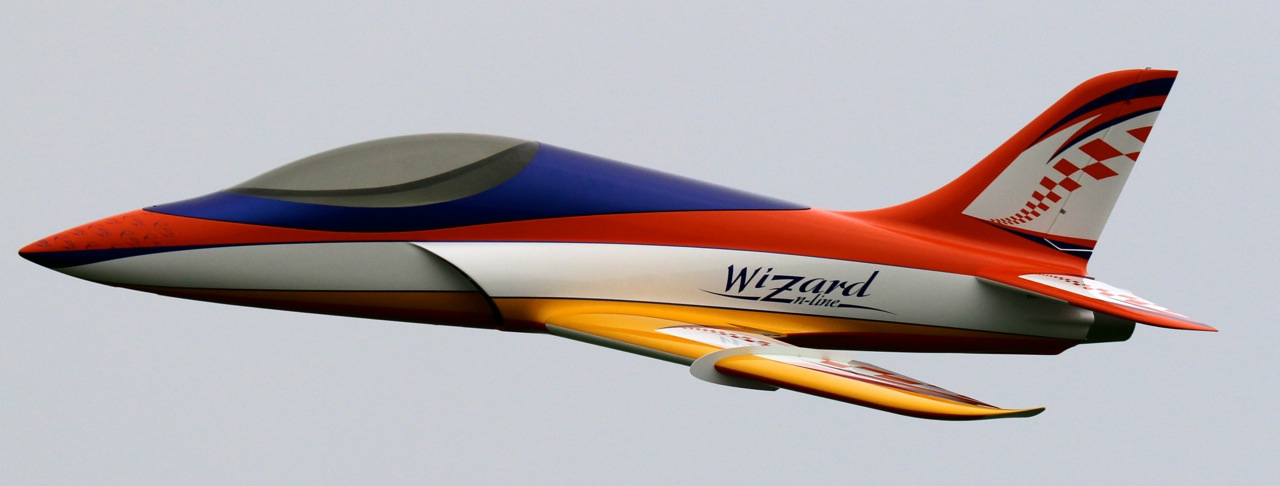

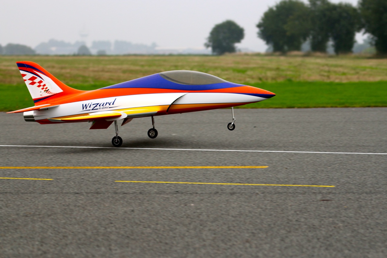

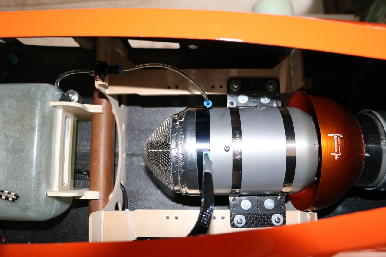

JPZ 09-16-2014 11:02 AM
3 Attachment(s)
http://www.rcuniverse.com/forum/atta...mentid=2032609http://www.rcuniverse.com/forum/atta...mentid=2032610http://www.rcuniverse.com/forum/atta...mentid=2032611
JPZ 09-16-2014 11:04 AM
Wizard proto with P140 RXI

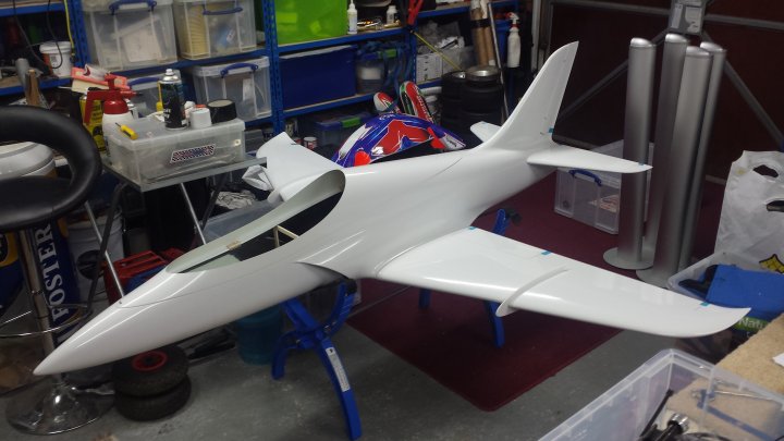

Thruster 09-25-2014 11:26 AM
1 Attachment(s)
Well got mine and did a trial fit and very impressed with everything. Thanks to JP all I have to do is bolt all the radio bits in and get it painted ;)http://www.rcuniverse.com/forum/atta...mentid=2035013
Thruster 09-28-2014 09:57 AM
Well spent a few hours today on the Wirard and got all servos in other than the elevators (don't have them yet) linkages done and all cable lengths sorted. As I'm going powerbus I need a couple more leads to complete. I made a box just below the rudder to hold the PB converter and cables - works well
fuel tank done and Radio bay mostly laid out, just waiting for the "white box" unit to finish.
Everything fitted so good only minor sanding on formers needed.
Only surprise for me is the small amount of movement needed for ailerons- my instinct was to get more but after checking the instructions I had more than stated ;)
I'll post some pics shortly
