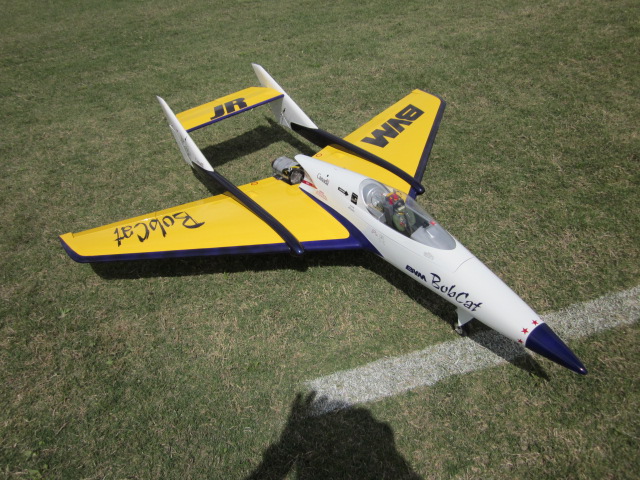

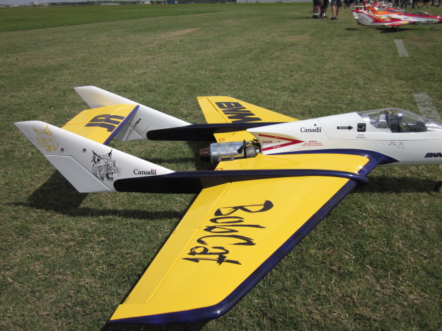

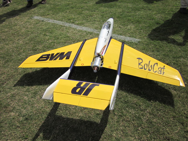

rcpete347 11-03-2013 07:20 PM
6 Attachment(s)
http://www.rcuniverse.com/forum/atta...mentid=1936419http://www.rcuniverse.com/forum/atta...mentid=1936420HI, the Bobcat needs a gyro, but my Kingcat certainlly does not, and nether require flaps for take off.
Rcpetehttp://www.rcuniverse.com/forum/atta...mentid=1936415http://www.rcuniverse.com/forum/atta...mentid=1936416http://www.rcuniverse.com/forum/atta...mentid=1936417http://www.rcuniverse.com/forum/atta...mentid=1936418
