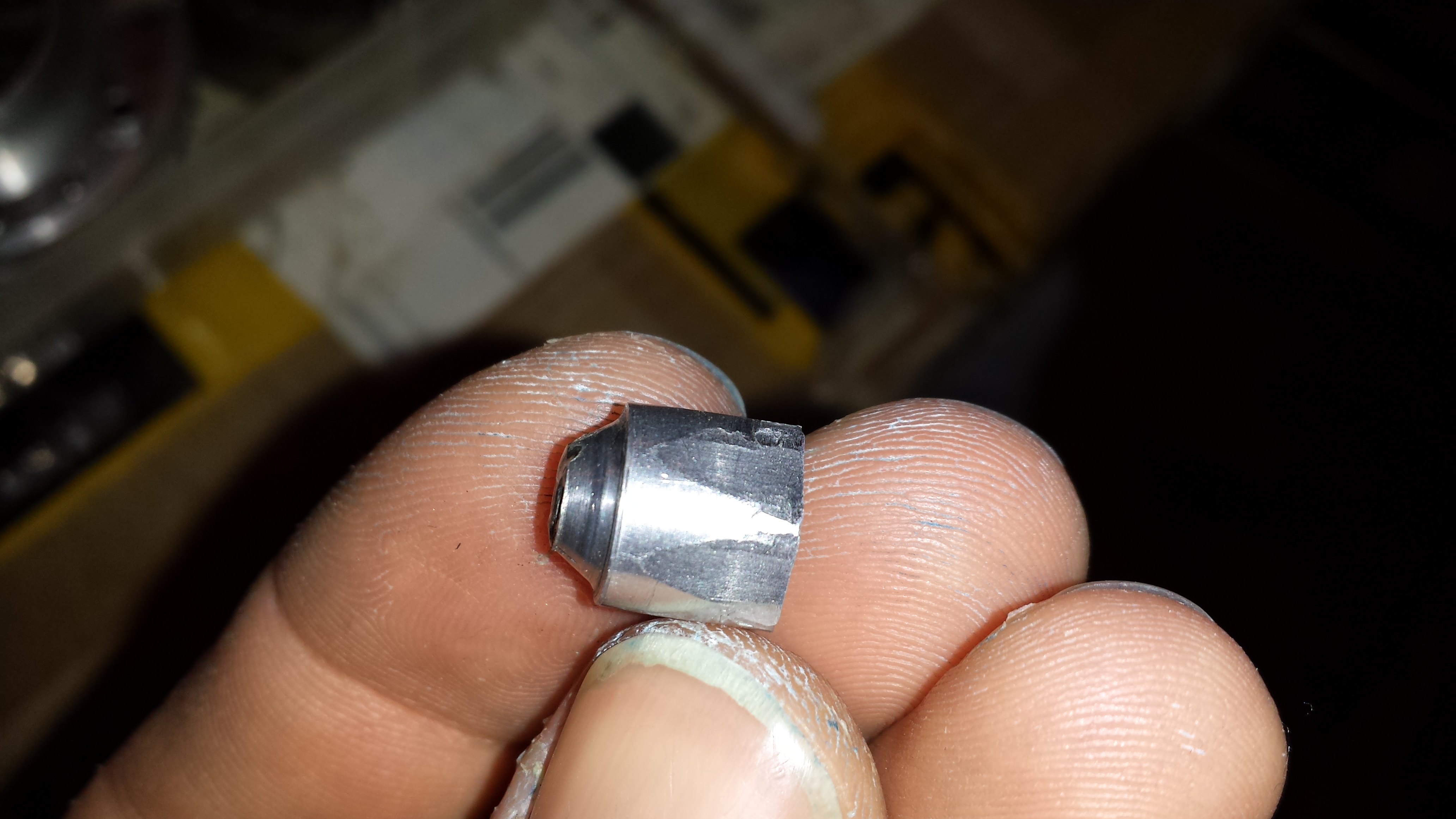

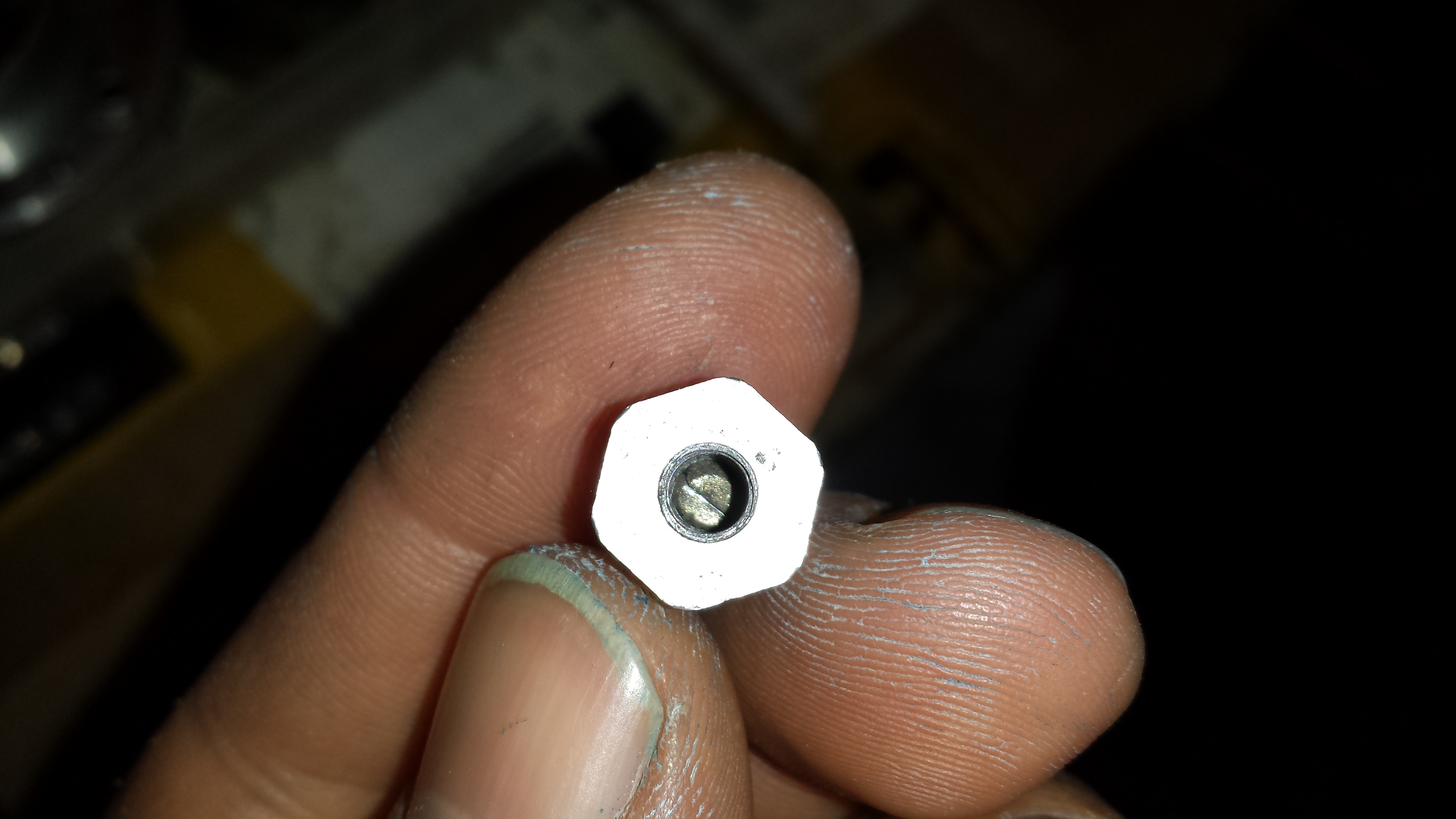

The restrictor is for lube the bearings only don't touch ,the magnet is inside the aluminum front skrew not visible ,I have extra board but I think is the magnet relate problem ,if you like send me the turbine for checkup I'm not the service mechanic but I have lot of experience with this type turbine nd I have extra new esc and fuel pumps .
sysiek 03-17-2014 04:21 PM
2 Attachment(s)
This is the front screw with the magnet. http://www.rcuniverse.com/forum/atta...mentid=1979148http://www.rcuniverse.com/forum/atta...mentid=1979149

sysiek 03-17-2014 05:08 PM
In one turbine I did instal brass tube to thread protection and drill the old magnet out than find similar size magnet and install with ca glue sideways ,my turbine started to work perfect after the ,check before with jetjoe if the have the nut I think jj-1400 have the same magnet nut let me check.
