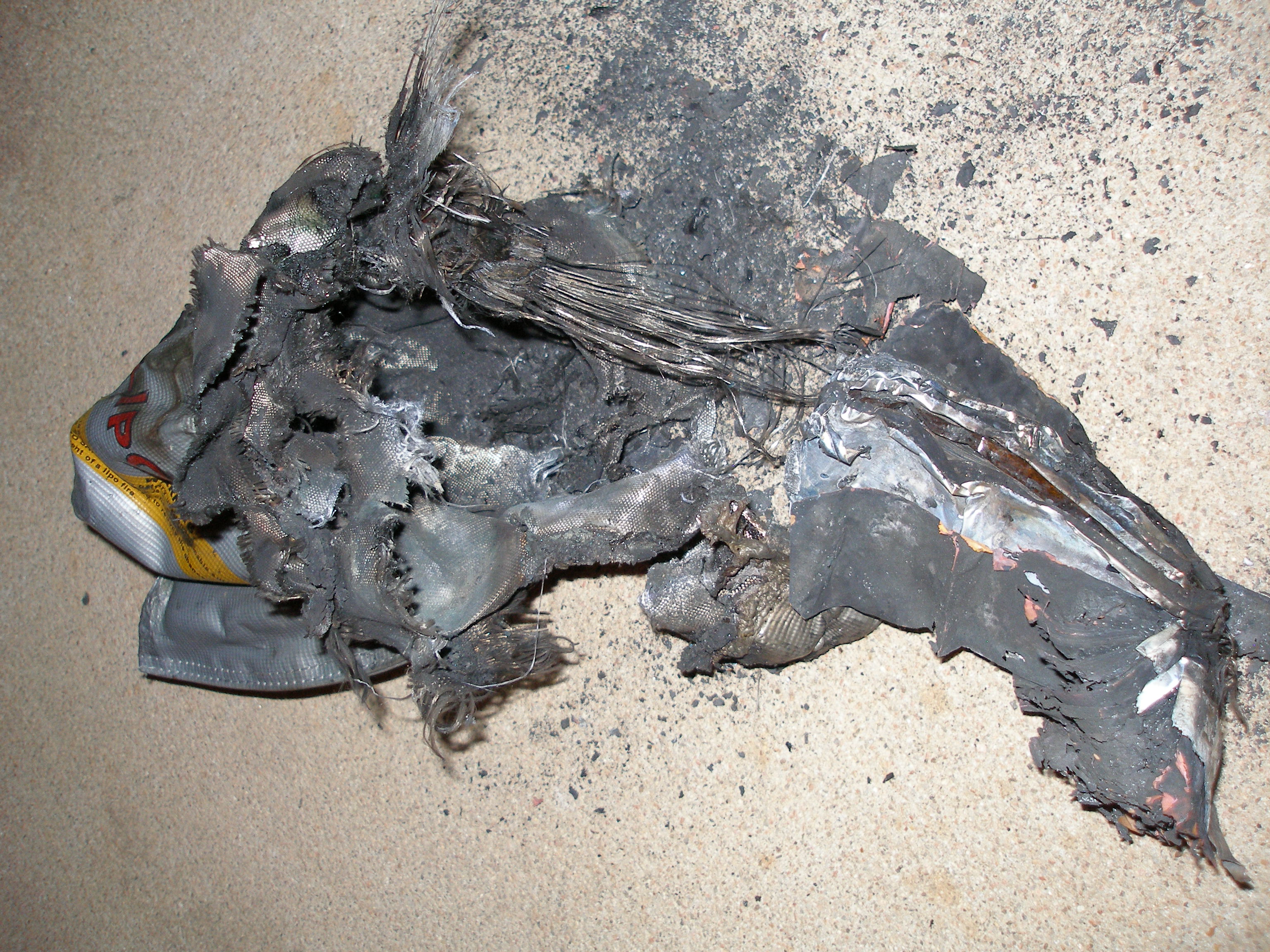

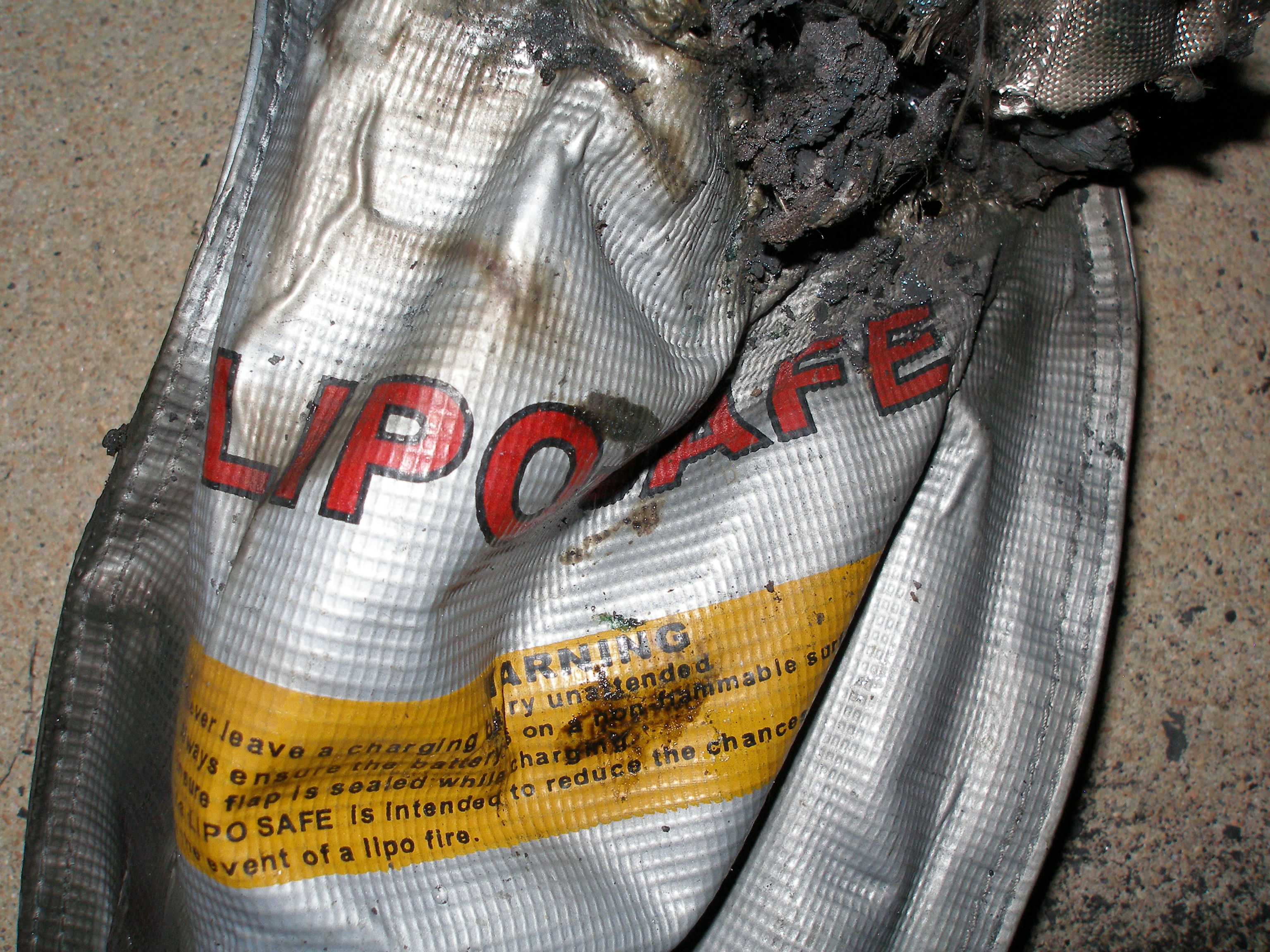

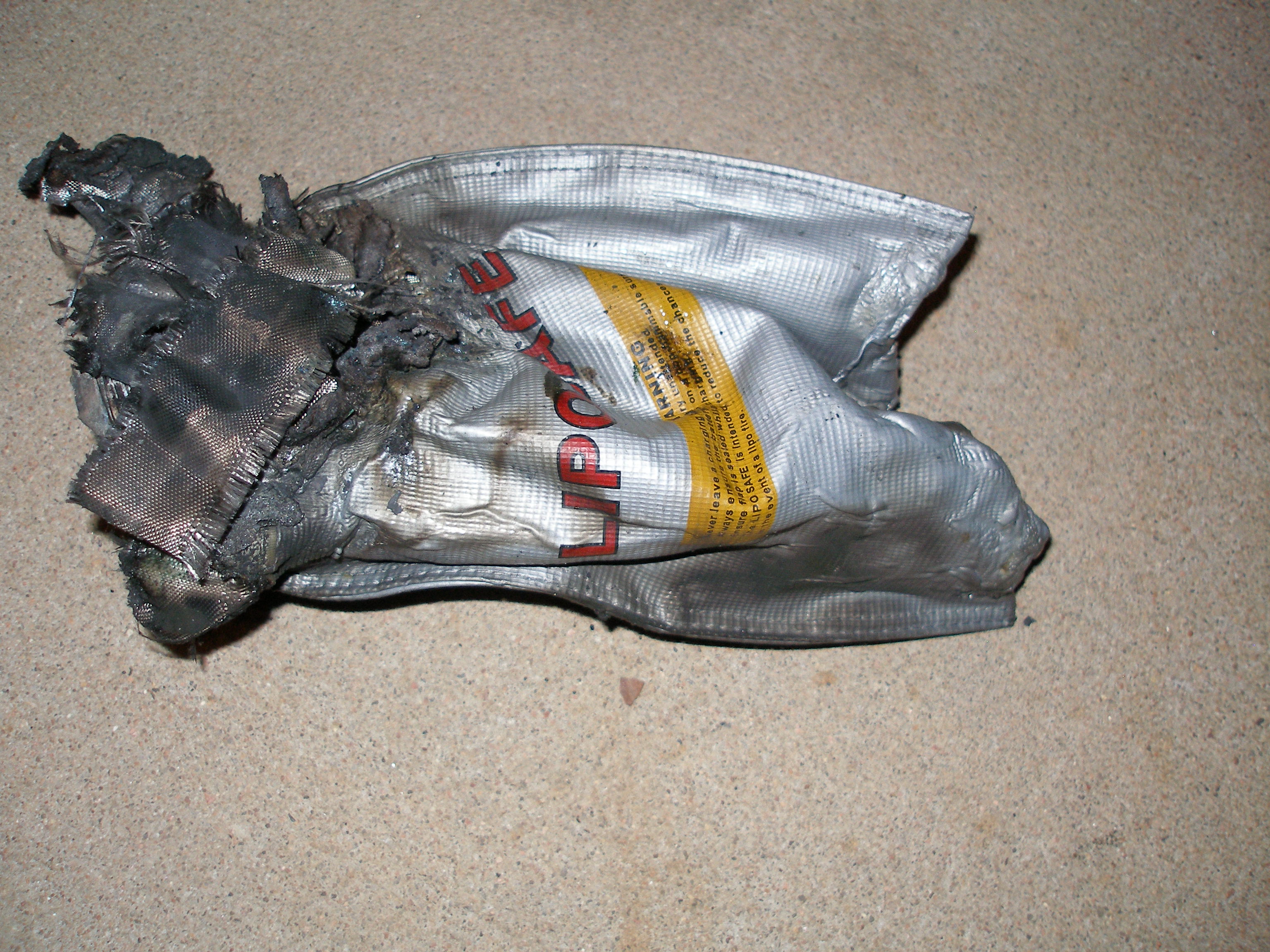

sidgates 03-30-2014 09:54 AM
3 Attachment(s)
http://www.rcuniverse.com/forum/atta...mentid=1982759http://www.rcuniverse.com/forum/atta...mentid=1982760http://www.rcuniverse.com/forum/atta...mentid=1982761Below is a description and pictures of a recent fire while charging in a Lipo bag.
"It was a 2650 Mah 4 s 50c Flight Power Pro50 being charged by a Thunder Power Dual AC 680 in a Nitroplanes lipo -safe bag. Fully charged battery discharged in flight about a minute and a half earlier than normal and was puffed up and hot. After battery cooled ,I was charging it for about 12 minutes when standing in room next to laundry room which is where I did my charging, it blew up with a big flash of light . Upon running into room I found soccer ball size flame engulfing the lipo safe bag. I knocked bag to the concrete floor and quickly removed it to front yard with a dust pan. Here's the pics. Eric S."
