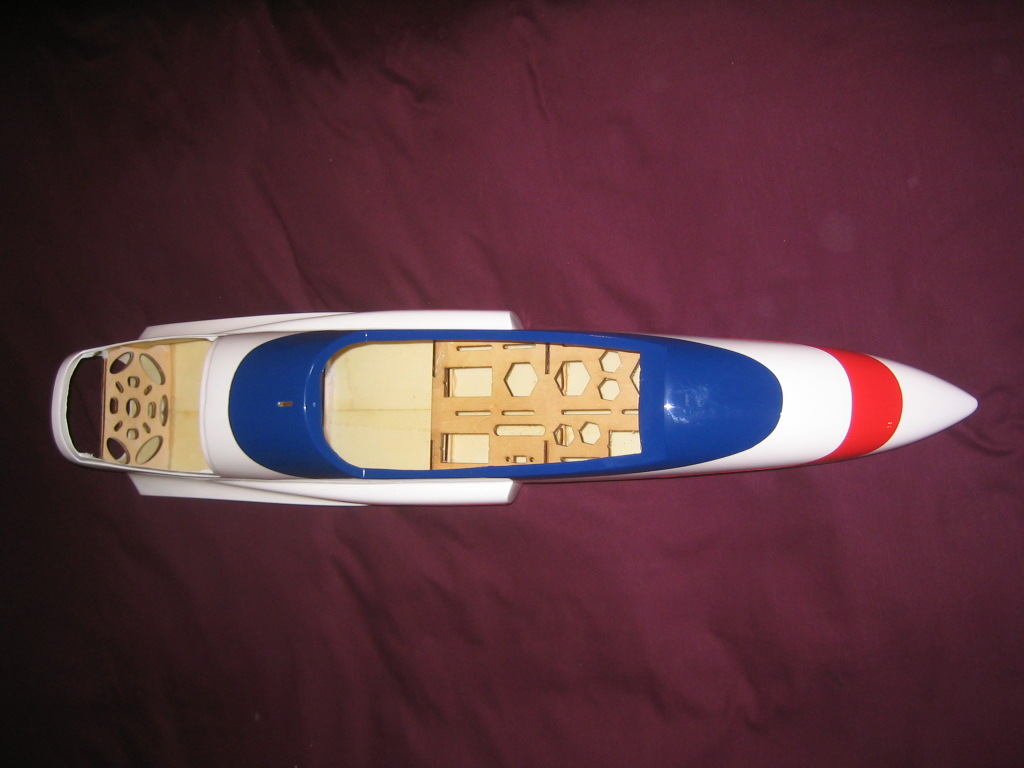

I recently watched this model fly with a Jetcat P-20 and was quite impressed, so had to get one. Overall I'm quite please with what you get for the money; it's not perfect but it's not too bad at all.
The model is pretty well packed and appeared to arrive with no damage. The first surprise when I opened the box was the colour as I thought they were sending me the red/white version (as per the box art) but they actually sent the red, white and blue. I'm quite happy with that though as this was the scheme that I saw fly and it shows up nicely in the air.
The fuselage has plenty of glue but there are a couple of areas where it hasn't stuck perfectly. These are non-structural areas so a bit of cyano will sort that out. The wings look pretty good and are wrinkle free at the moment. It should be a very quick build but I'm pretty busy with other things at the moment so will update this thread with my progress when I can.

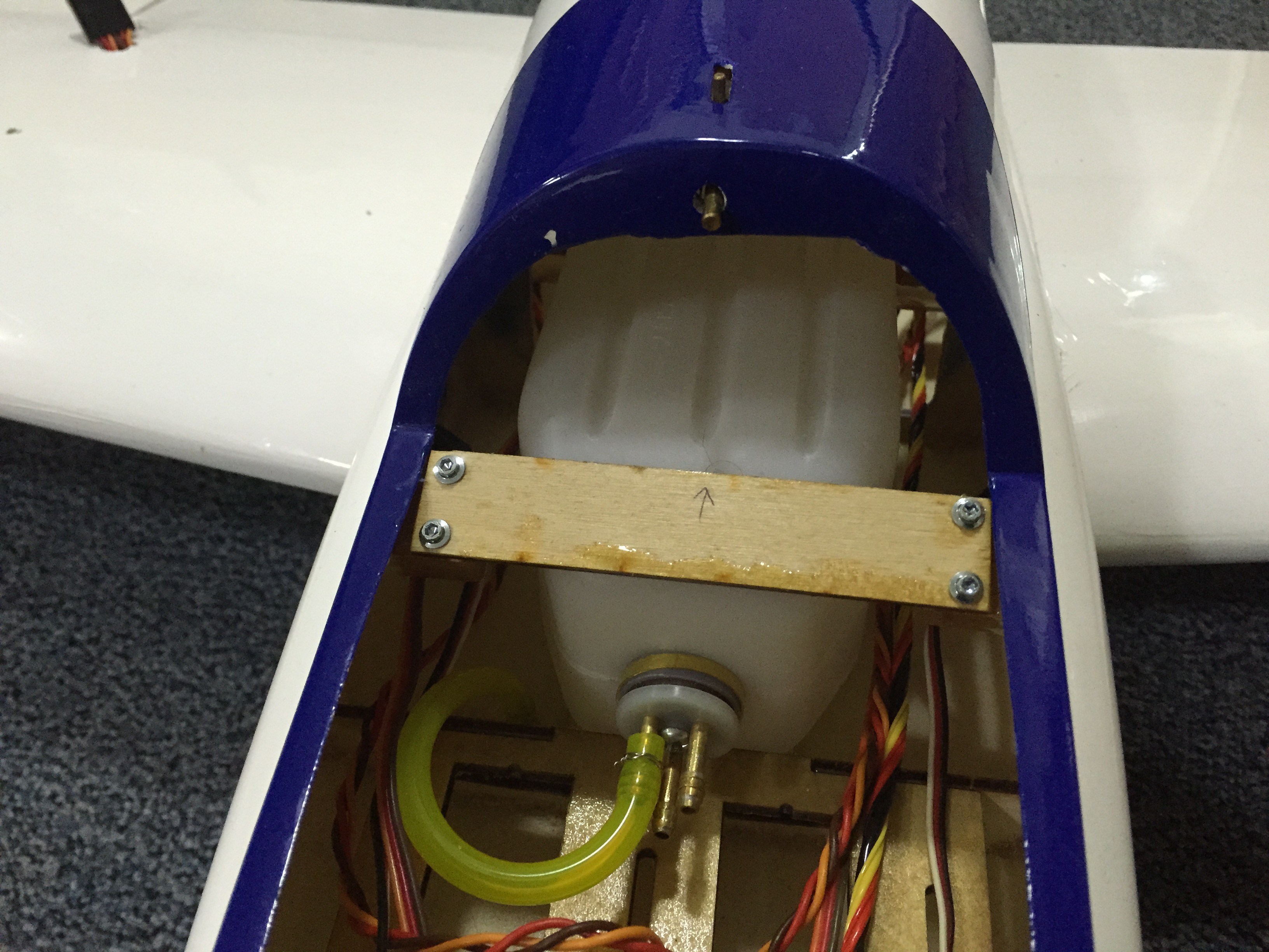

A few pictures of my progress showing the turbine and fuel tank installation. Only minor jobs left to do now :D

Need info on tank size, having problems with cg
Where is cg w full tank? Cg w empty tank??
Tank is ahead of cg is my problem w full tank.
Dave
R Woodard 12-11-2020 08:44 AM
Hi Dave
I am using a 20 oz Dubro tank. I have the back of the tank butted against the wing spar. My CG is 105mm from LE. It fly's great with full tank. My Vertex 32 is still flying great today. I hope this help
david101 03-06-2021 07:36 AM
Vortex 32 tank/cg
Have had numerous tanks in it.
Main tank empty or full @ correct cg?
When my tank is empty and cg is correct when I fill tank it is extremely nose heavy.
Will it fly ok nose heavy? I don't want to run out of elevator and lawn dart it.
Current tank is 18 ounces and back to spar.
Thanks for help!!!
Dave
R Woodard 03-06-2021 05:44 PM
It should CG with Main tank empty, UAT full. It will be nose heavy on a full tank. It will still fly great. You never want it tail heavy when there is no fuel in main tank. you want CG right when landing.
