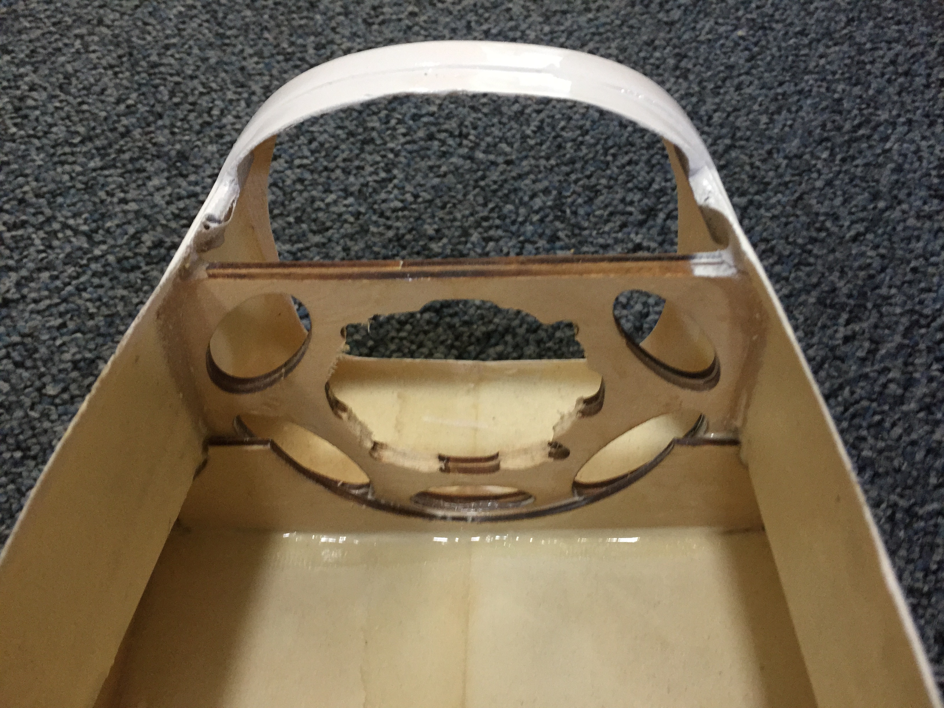

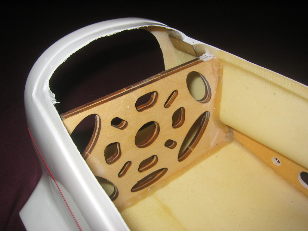

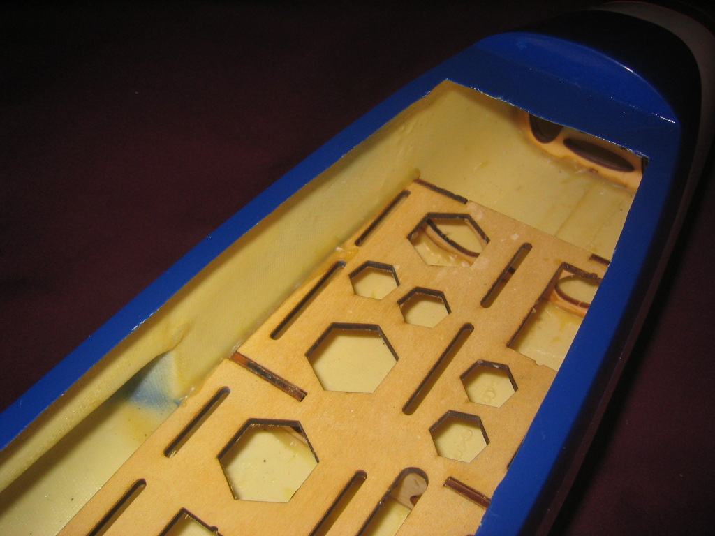

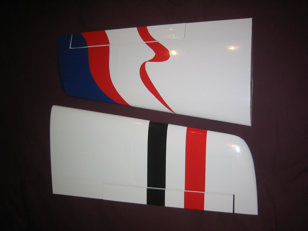

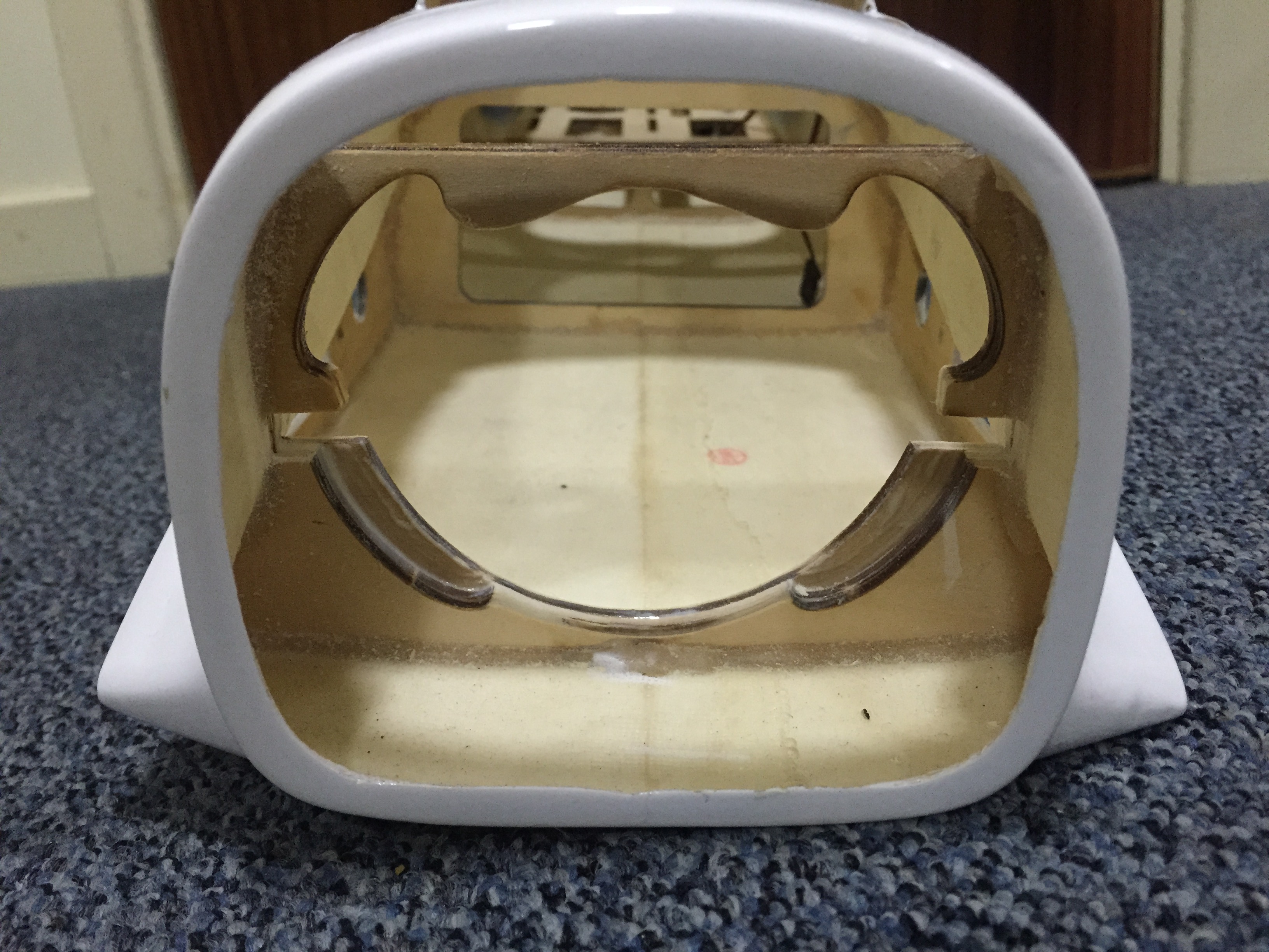

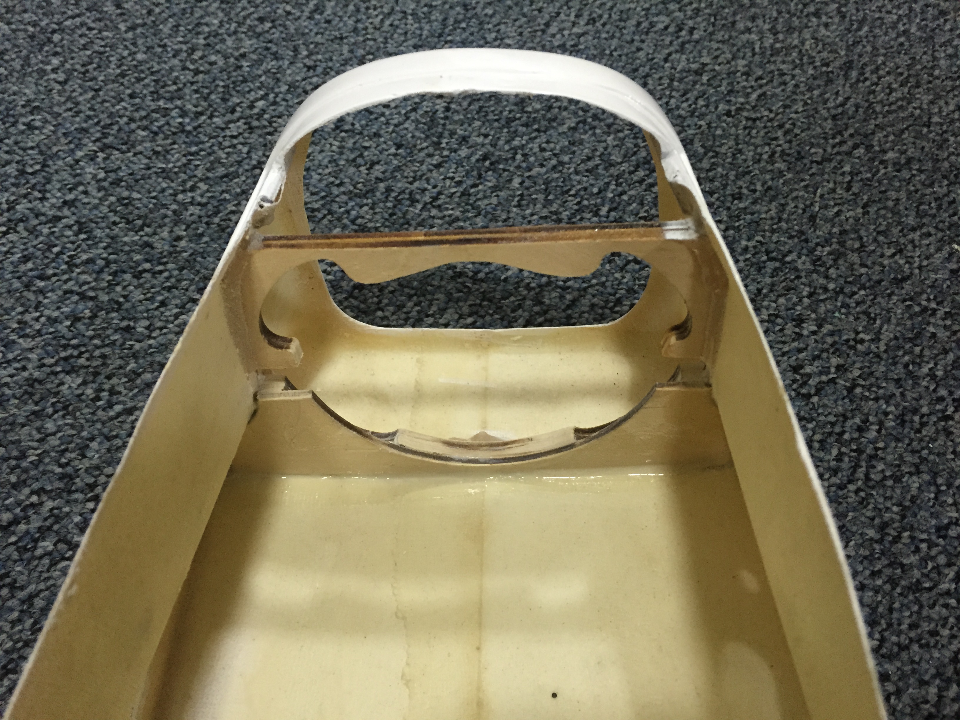

I recently watched this model fly with a Jetcat P-20 and was quite impressed, so had to get one. Overall I'm quite please with what you get for the money; it's not perfect but it's not too bad at all.
The model is pretty well packed and appeared to arrive with no damage. The first surprise when I opened the box was the colour as I thought they were sending me the red/white version (as per the box art) but they actually sent the red, white and blue. I'm quite happy with that though as this was the scheme that I saw fly and it shows up nicely in the air.
The fuselage has plenty of glue but there are a couple of areas where it hasn't stuck perfectly. These are non-structural areas so a bit of cyano will sort that out. The wings look pretty good and are wrinkle free at the moment. It should be a very quick build but I'm pretty busy with other things at the moment so will update this thread with my progress when I can.

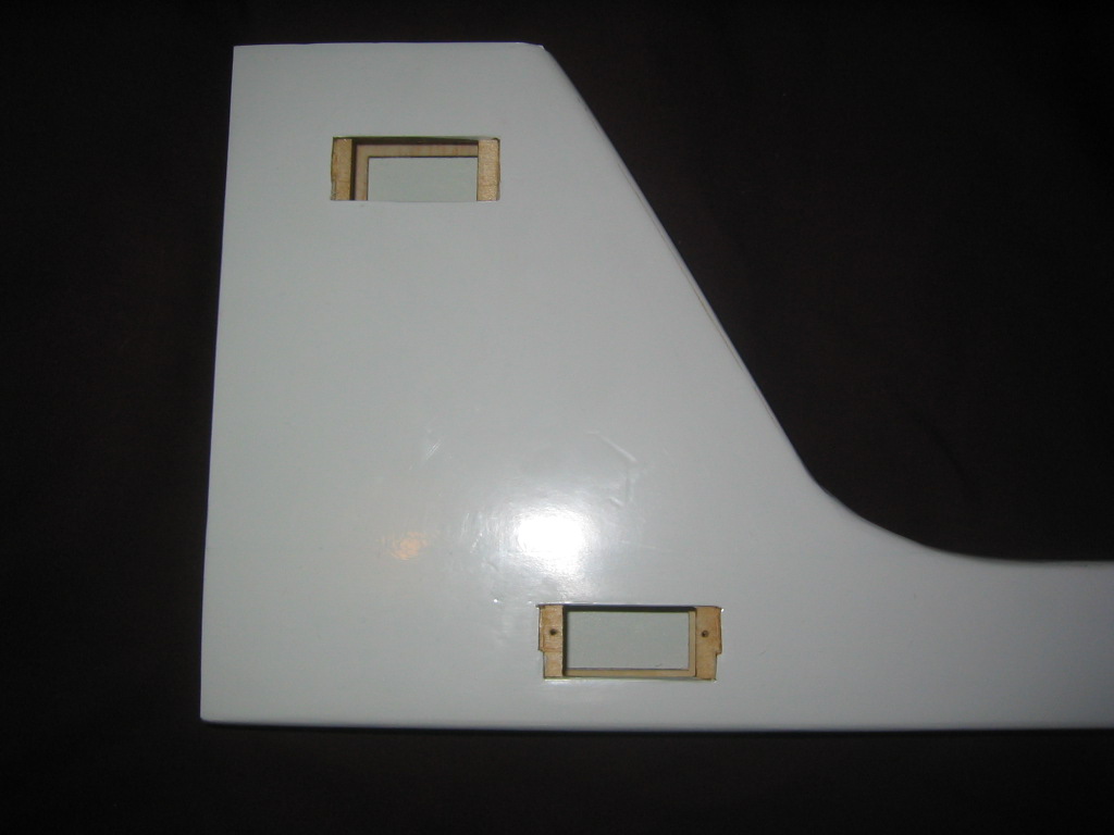

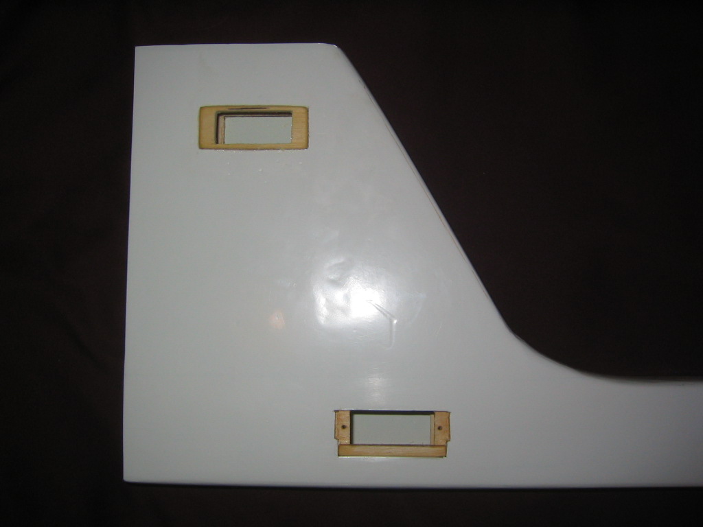

The first job I looked at was the boom servos; each boom has 1 elevator and 1 rudder servo. The cut-outs didn't perfectly suit any of the servos that I had so I tried a few different ones out to see what I wanted to use. In the end I have decided on Hitec HS-85MG for the rudders (as I had some spare) and will use Hitec HS-5085MG for the elevators. These seem quite small but previous experience flying a Wren 44 powered Savex L39 with Hitec minis on aileron and flaps makes me think that these will be fine.
The HS-85s fit pretty well into the rudder cut-outs; I have just added a strip of 1/8th ply at the bottom for neatness. The elevator servos were a little more tricky as there is not much depth for them. Also, one of the pieces of wood that the elevator servos should screw to was a little loose. I ran some cyano around the loose part and then made some 1/8th ply mounts which I glued over the top. This creates just enough stand-off for the HS-5085s to fit without sticking out of the other side of the boom.

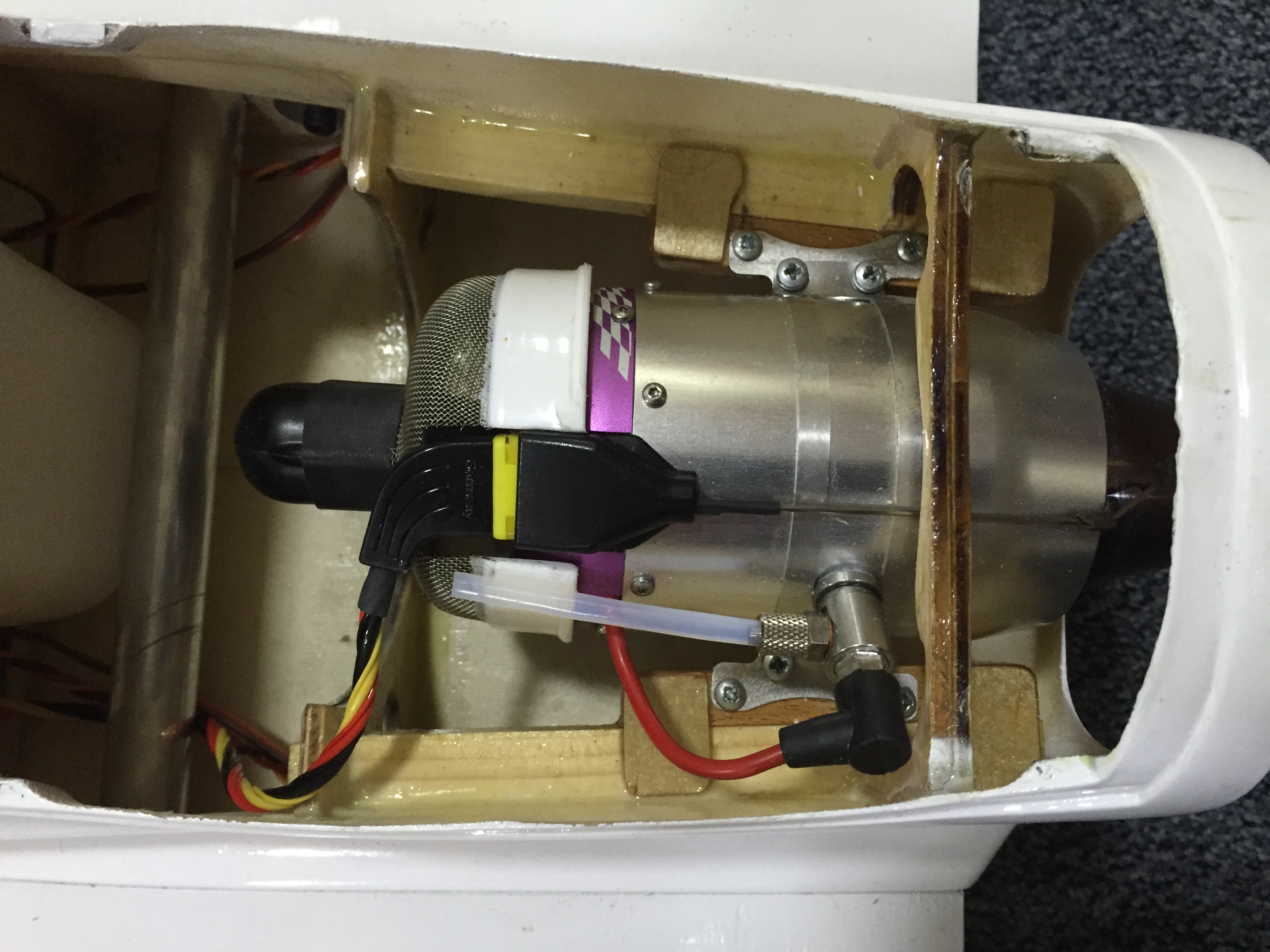

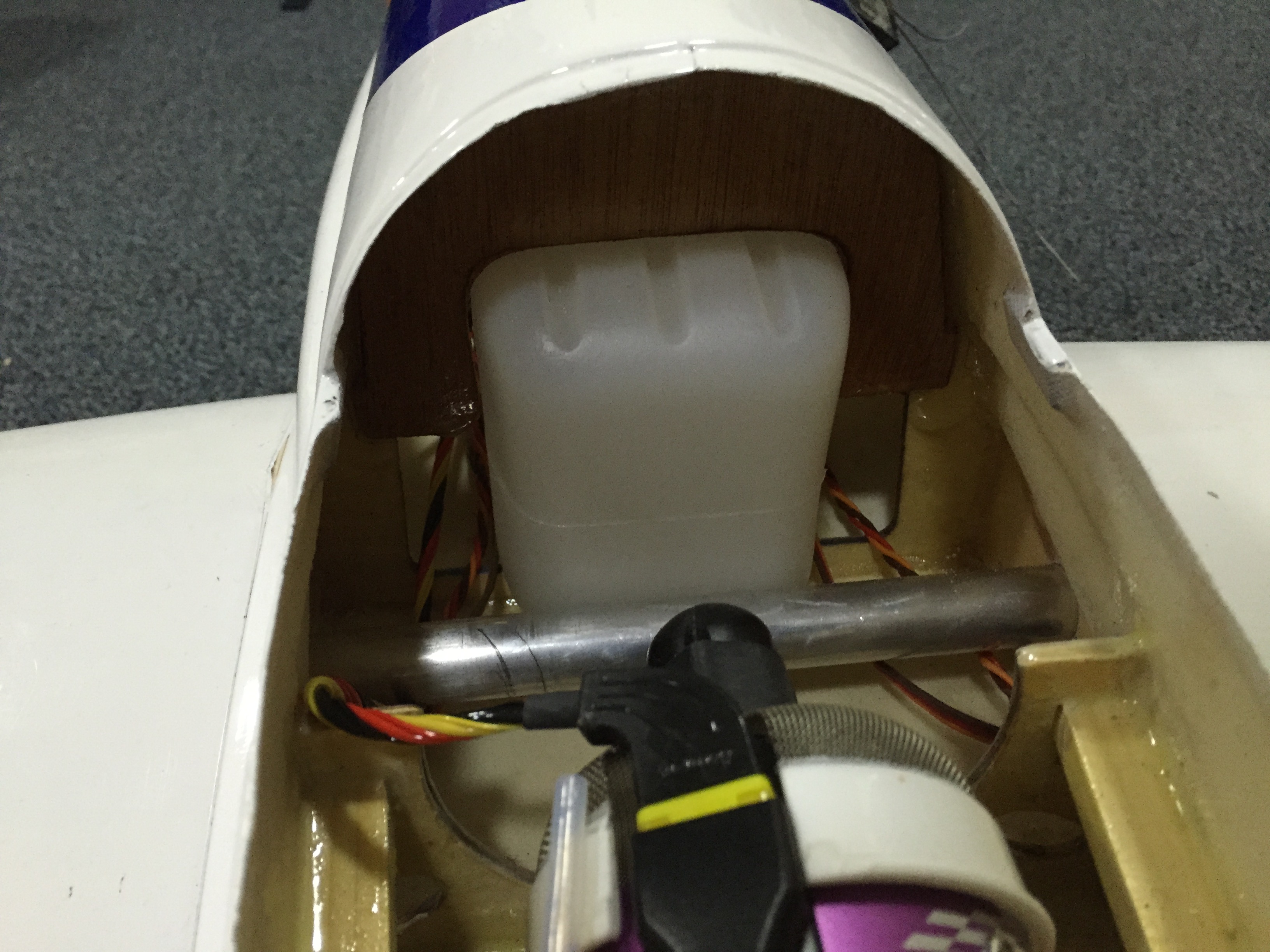

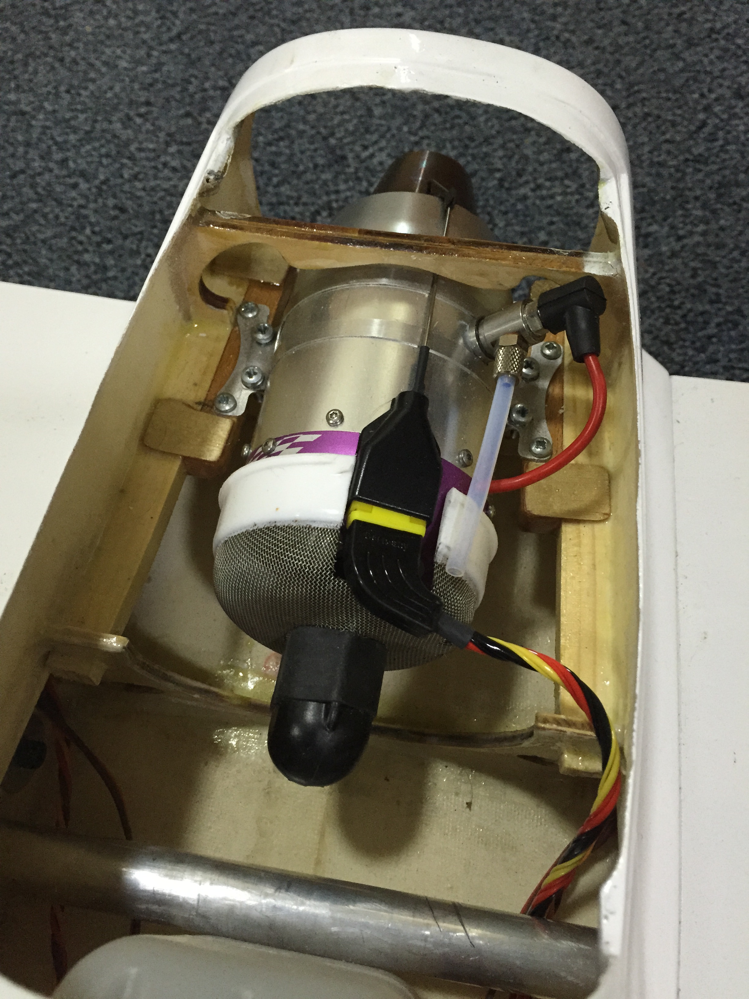

A few pictures of my progress showing the turbine and fuel tank installation. Only minor jobs left to do now

Looks great, I put my battery behind the fuel tank.I am using 1 battery with a voltage regulator.

Hi Dave
I am using a 20 oz Dubro tank. I have the back of the tank butted against the wing spar. My CG is 105mm from LE. It fly's great with full tank. My Vertex 32 is still flying great today. I hope this help

Old 03-06-2021 | 05:44 PM
Joined: Jan 2009
Posts: 11
From: Kansas, KS
It should CG with Main tank empty, UAT full. It will be nose heavy on a full tank. It will still fly great. You never want it tail heavy when there is no fuel in main tank. you want CG right when landing.
