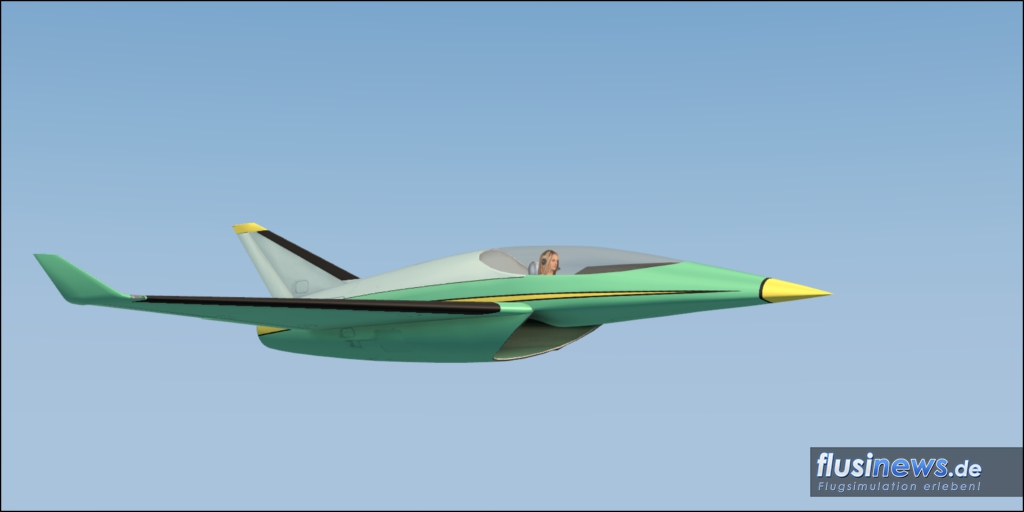

Henke Torphammar 04-15-2015 10:10 PM
Maybe a delta sportsjet? Like the squall or something like that. Sort of if a Futura would mate a Mirage 2000 :-)
http://www.flusinews.de/wp-content/u...aby-Bild-1.jpg

patf 04-16-2015 11:28 AM
Wow! the Squall.. that's a throwback.
invertmast 04-16-2015 01:50 PM
While the squall was a cool and unique looking airplane, i really didnt like the way it flew, so i couldnt bring myself to do a larger one of it. That said, the model i emmulated mine from is very nice and everyone i know who knows the original would love to have one, so i think this will be a hit at a smaller price and size.
