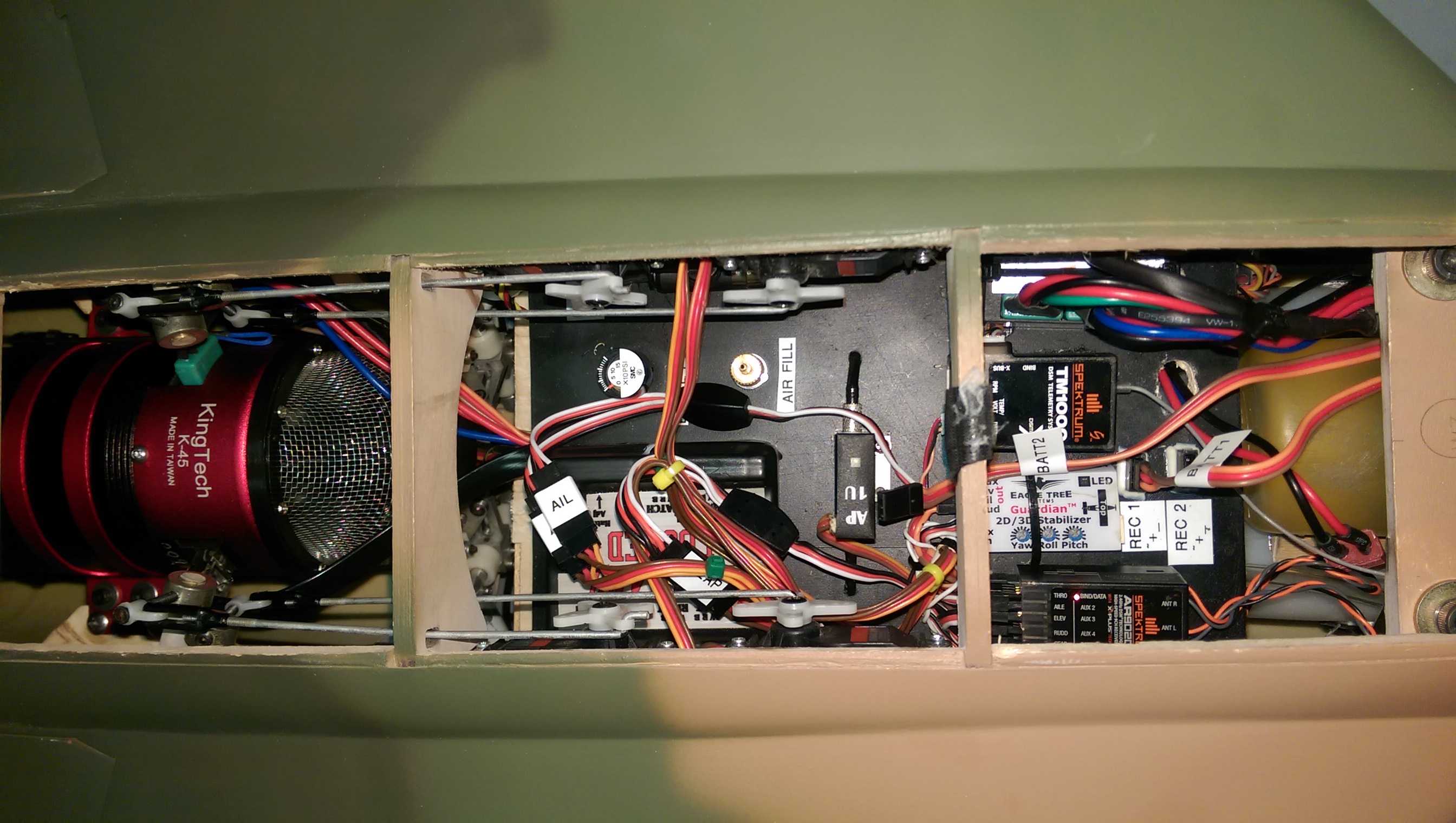

Bob see you soon!
A7 is ready for Kentucky. Might do a little weathering on it if I get time. http://www.rcuniverse.com/forum/atta...mentid=2105865

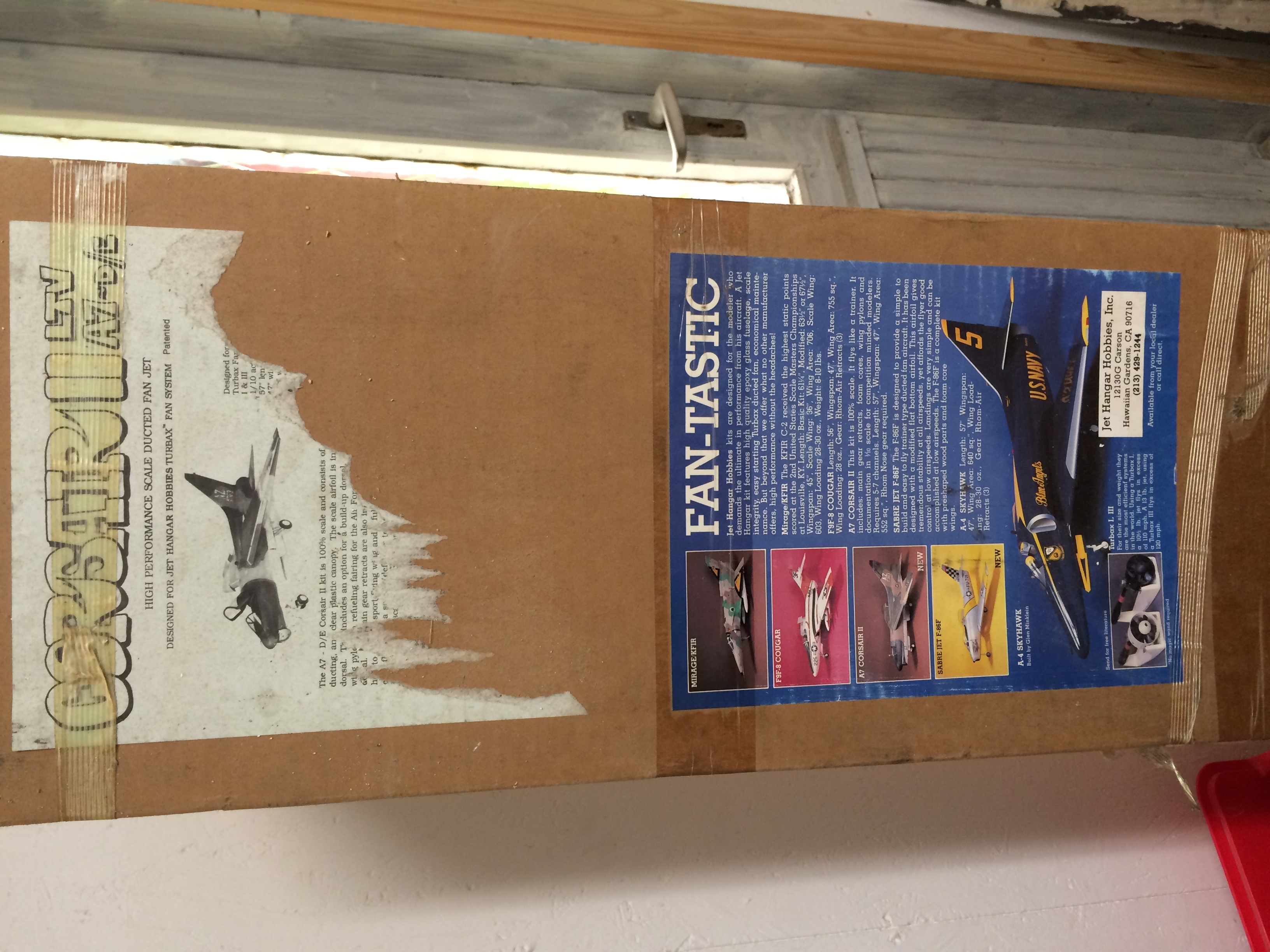

This thread made me pick down my A-7 from the shelf an start plan the bulid. I`ts an old kit version who has piano wire main gear I plan to go the same route and turbine power it and are in need for an upgrade with more rugged scale type gear. Sent JHH an e-mail 3 days ago but has`nt got a reply yet. Looks they are temporary out of stock.
Anyone else have an advice for a set that fits ? I also need the brackets who holds the cylinders for the main gear
Trond Bruun-Olsen
Norway

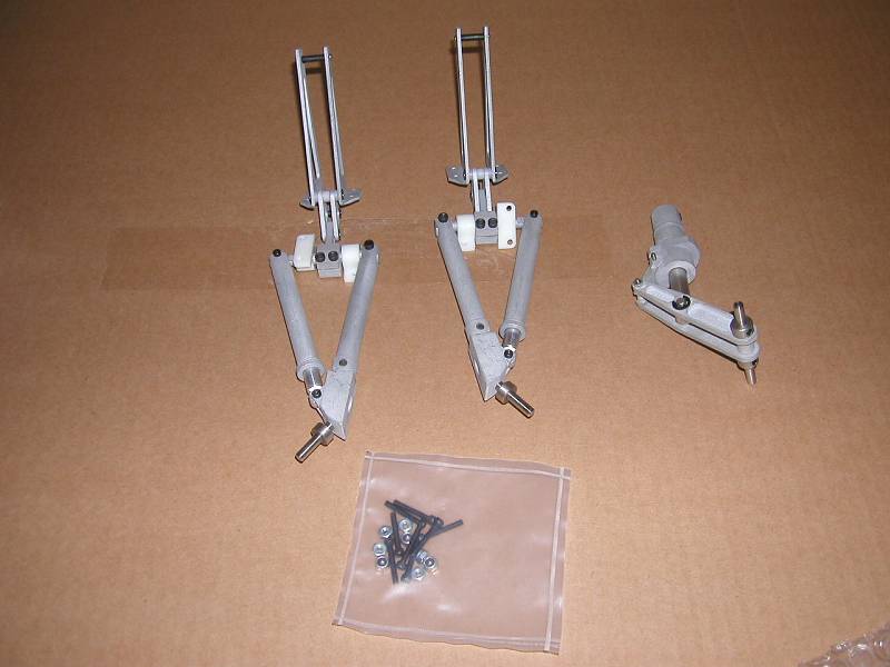

2 pics of the kit this gear is what I`m looking for

Trond,
A kit build, nice! Do you think you will build the leading edge flaps? Regarding gear, I can tell you that my folks don't have any and probably won't anytime soon if at all. However, RC Crafters (http://www.rccrafters.com) has a set available if you wanted to go that route. It's a similar solution to what was supplied with the ARF's. Here's a shot of the 3 gear set.

Thanks Chris ,
Not decided if I´m gonna do the leading edge flaps yet. It`s a bit of hazzle to do , and not sure if it`s worth the job ? :-)
The Rccrafters gear looks nice , will get in contact with them . That`s the route I want to go if it`s available and not too overpriced..
However I found THIS scale gear set , but at near 1300 bucks .. well ? Nicely made thou ...

Yeah, the matrix stuff is nice, but quite expensive. Looking at the design, the mains look heavy to me given the metal mounting plate, etc. I think the RCCrafters gear will do the job for you and should be a fraction of the cost compared to the Matrix gear.

I spotted for Chris on one of his flights with the A-7. The K45 pushed it *very* well. He seemed to have a good turn of speed, realistic vertical, and the plane got off the ground in a fairly short time. Overall, the K45 pushed it much better than the E-Turbax setup (10 cells) that I had in mine a few years back. I think I'm going to use this motor in my Yellow A-4...
He had some issues with the airframe itself, but those were not related to the Kingtech motor...

The engine was flawless. Now the aircraft... LOL lots of work to do on it. Gear doors dont work most of the time the electric down and locked gear does not stay down and locked. My eagle tree gyro failed and made the aircraft very hard to fly.I had to hold half stick aileron the entire flight to hold it straight. In the end I will get it all squared away just need some time at my home field to play with it some. I did install new wheels and brakes at the event and also shoved some tygon in the main struts to lift the rear end some since it was sitting way to low.
40 ounces of fuel seemed to be about perfect. I flew 5 mins then landed and had enough to go around left. The Xicoy telemetry worked great and will be using that on more planes now. The little K45 was so quite when it would go by. Ali called it the little guppy. When I get all the problems ironed out and get some real flights with it I will post some video. Dont like posting maidens and untrimmed crappy flights.
