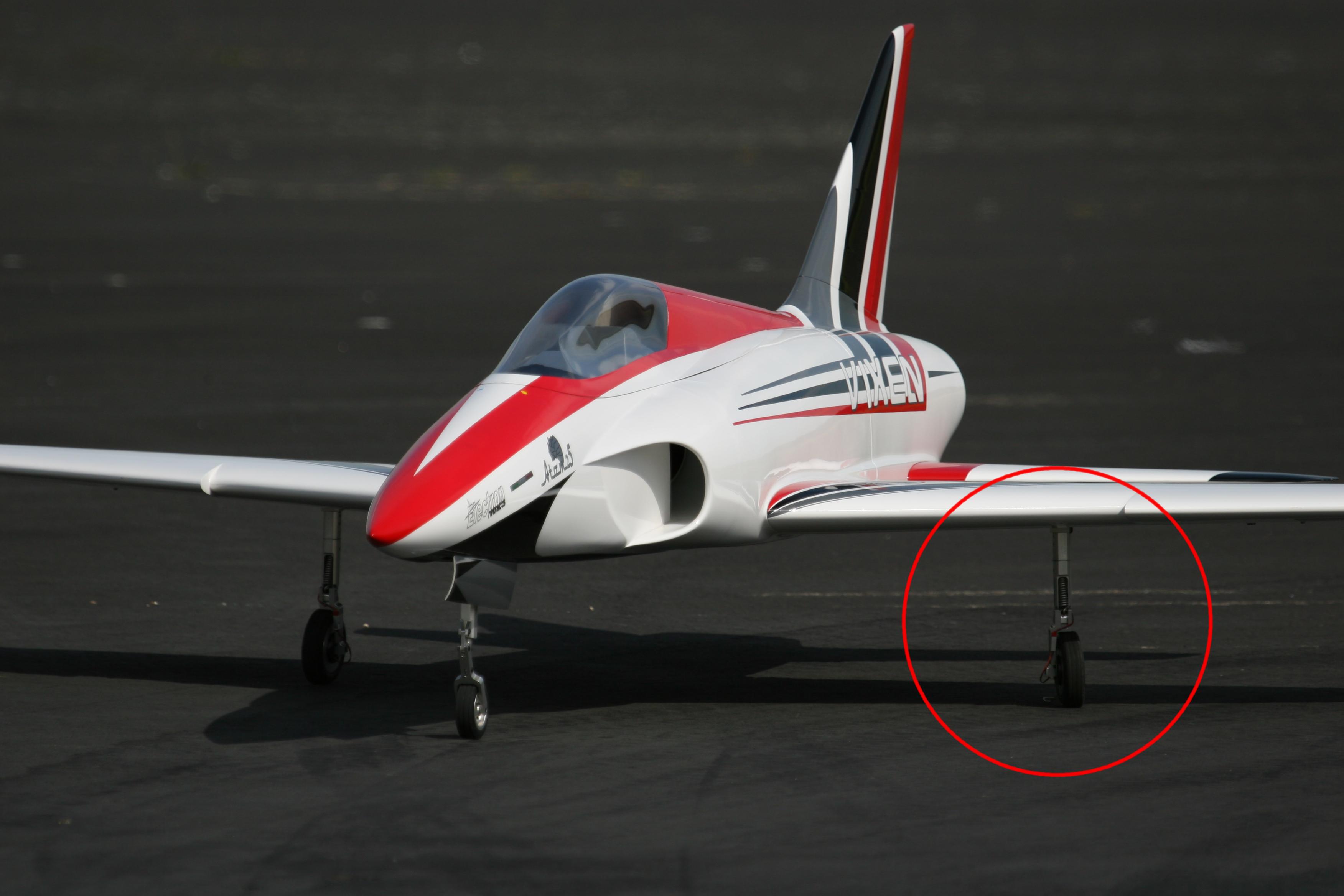

Looks like a little problem on the landing or roll out?
RCISFUN 09-14-2015 03:41 PM
What makes you say that?
causeitflies 09-14-2015 03:52 PM
Looks like the wheels are off the ground and it is skidding sideways and one main gear is twisted on the taxi back.
rchobbymodels 09-14-2015 04:04 PM
It is really weird picture, but looks like a landing on a cross runway similar the one we have in Pensacola, FL maybe Marc, as he was there, can explain better.
causeitflies 09-14-2015 04:07 PM
I think you're right Wagner. That would explain it.
causeitflies 09-14-2015 04:11 PM
1 Attachment(s)
Gear still looks a little twisted though
http://www.rcuniverse.com/forum/atta...mentid=2119967
rchobbymodels 09-14-2015 04:14 PM
Yes Mark, it does but this is not Xtreme stock gear, maybe gear should be tighten a little more.

As Wagner mentioned the landing gear is not 'stock', the units fitted are EVO50's from Electron and were part of a retrofit option for those who might be interested in all electric gear. The gear leg has four grub screws and my mistake was to not tighten the two grub screws in the trunion so on the first landing following a quick turn to vacate the runway the main gear twisted. I properly tightened the grub screws after re-alignment and the following two fights were perfect with no issues on twisting of the gear.

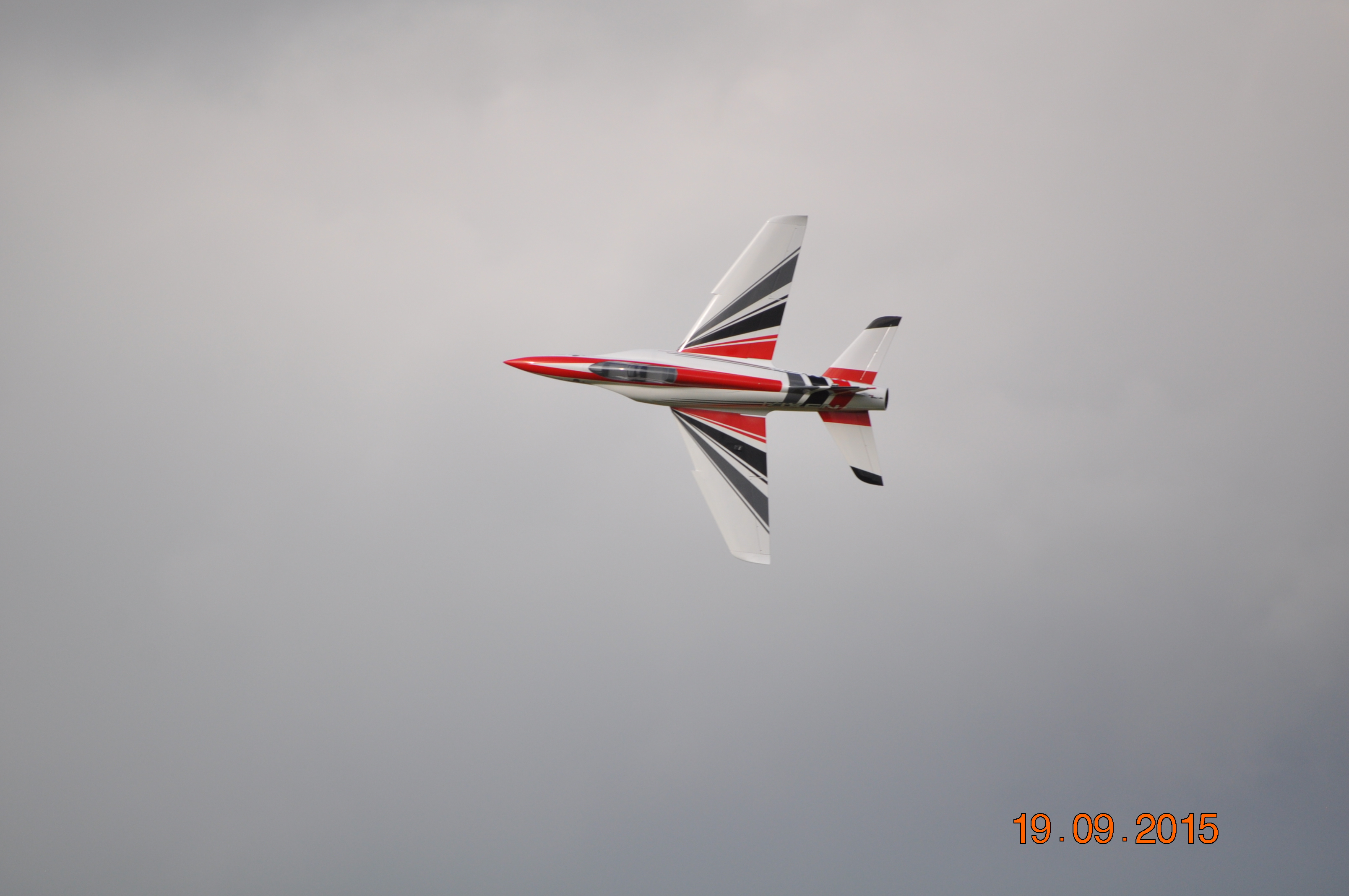

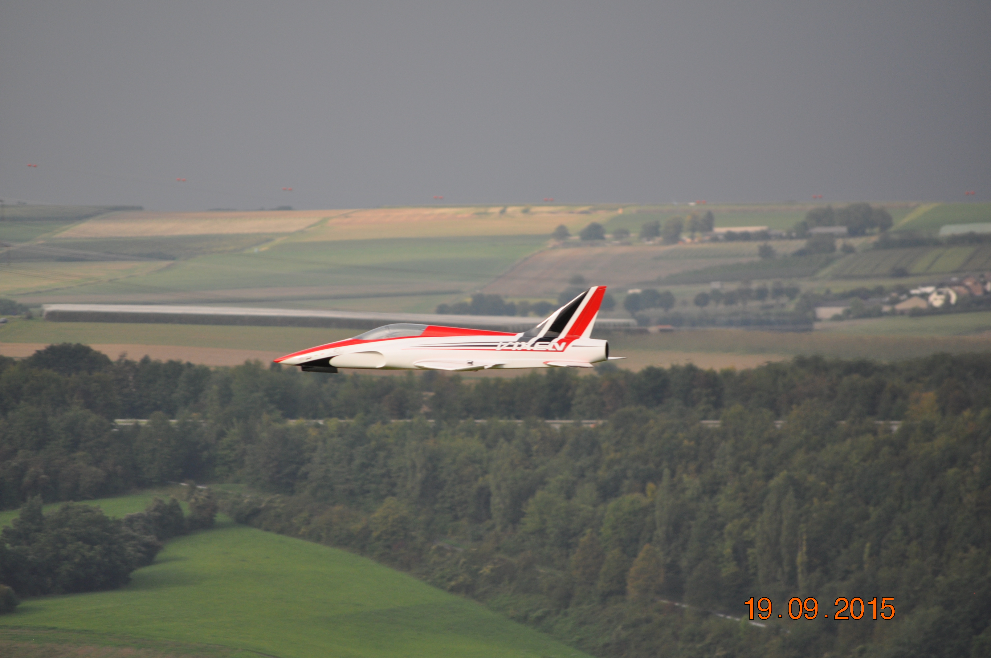

marc s 09-23-2015 12:40 AM
3 Attachment(s)
Couple of pictures in flight and on the ground preparing to take off.......
http://www.rcuniverse.com/forum/atta...mentid=2121885http://www.rcuniverse.com/forum/atta...mentid=2121886http://www.rcuniverse.com/forum/atta...mentid=2121887

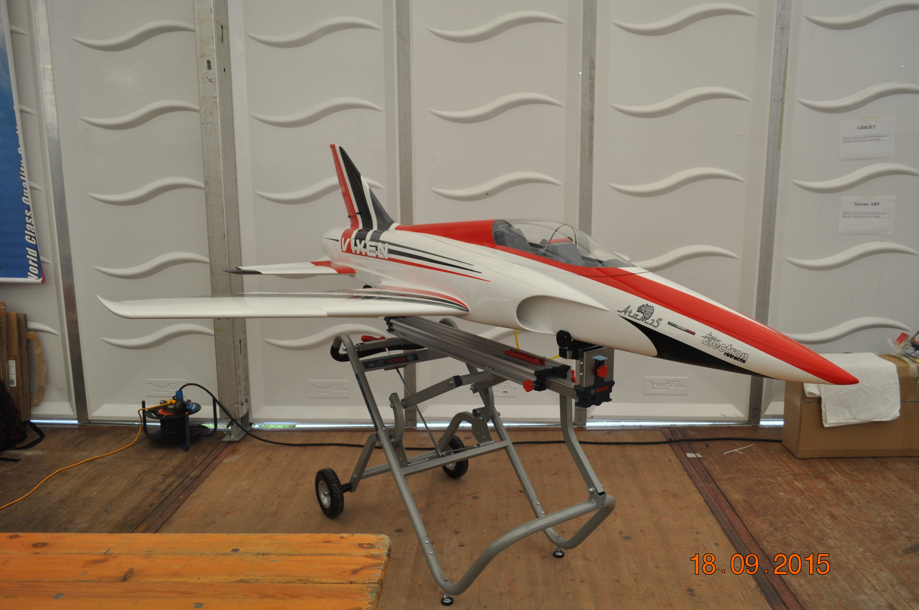

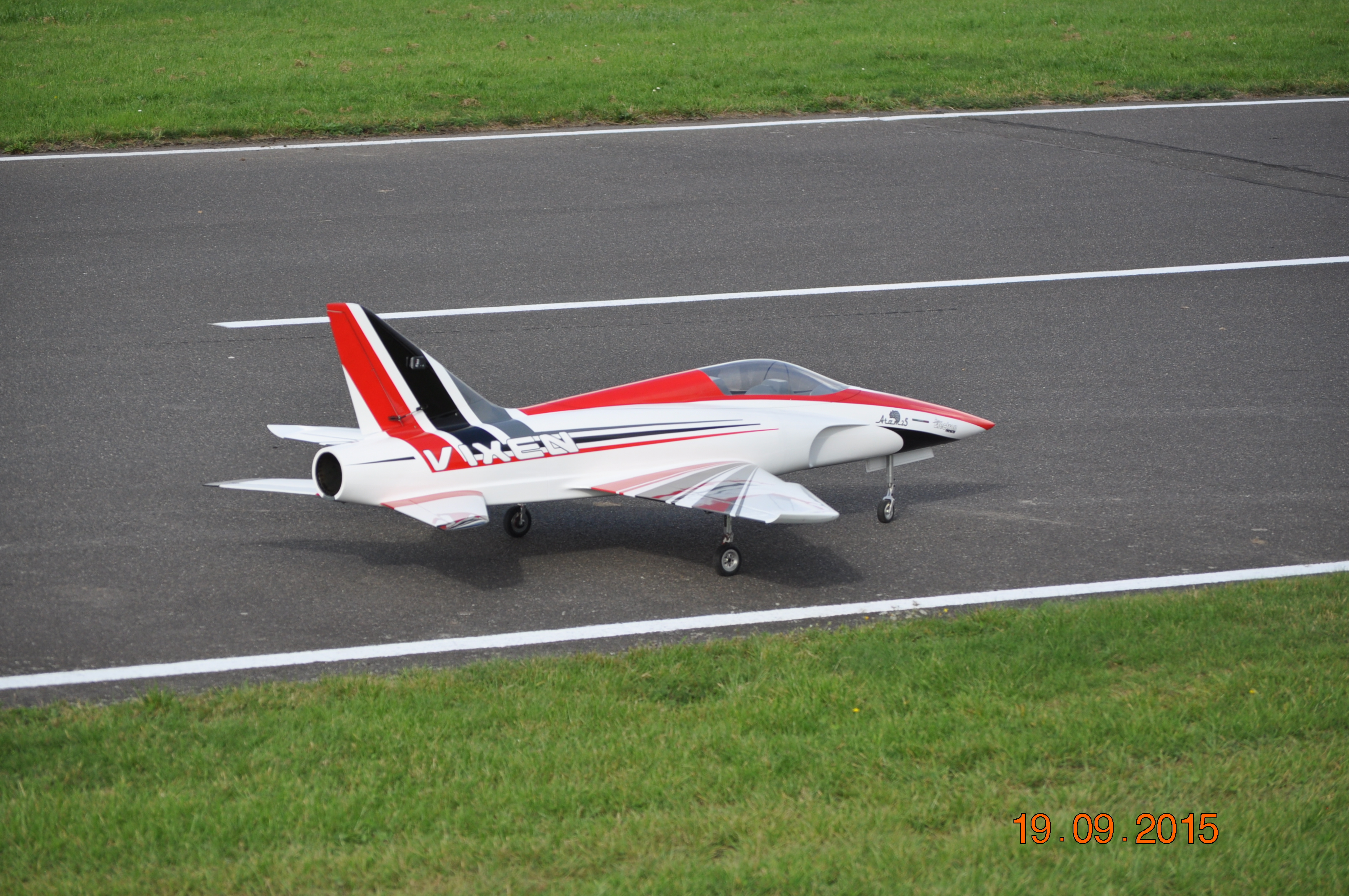

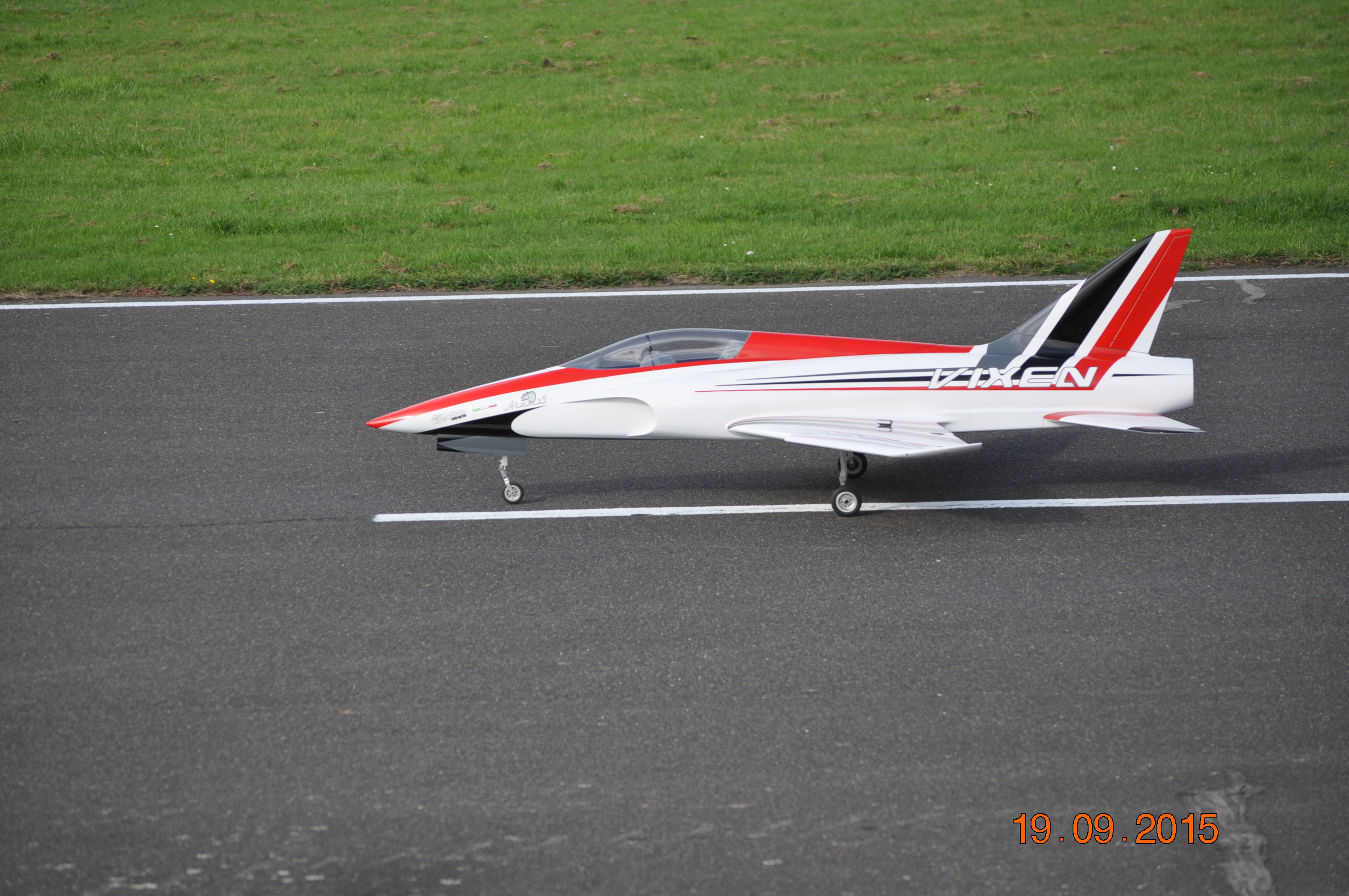

marc s 09-23-2015 12:41 AM
3 Attachment(s)
Few more...
http://www.rcuniverse.com/forum/atta...mentid=2121888http://www.rcuniverse.com/forum/atta...mentid=2121889http://www.rcuniverse.com/forum/atta...mentid=2121890
