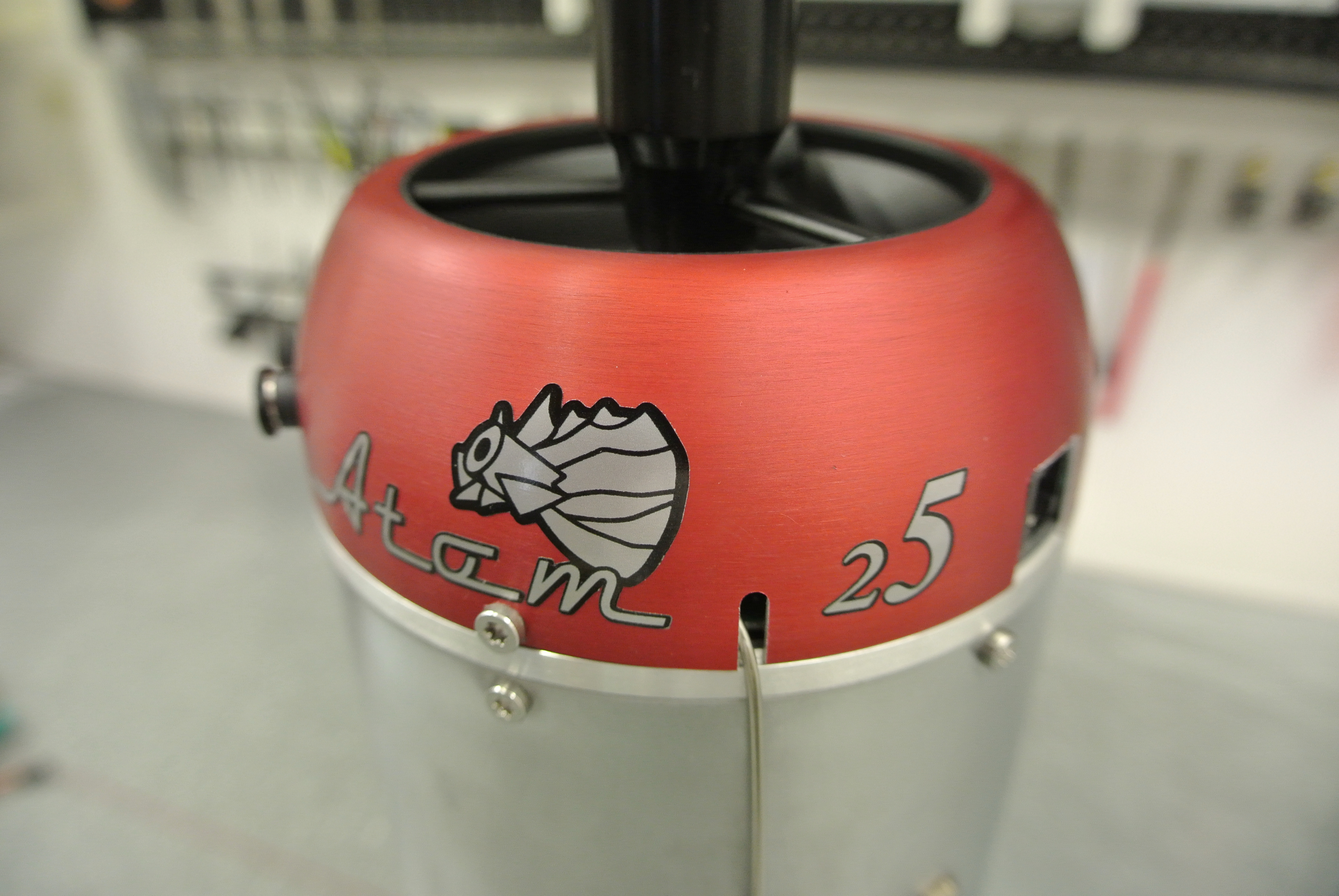

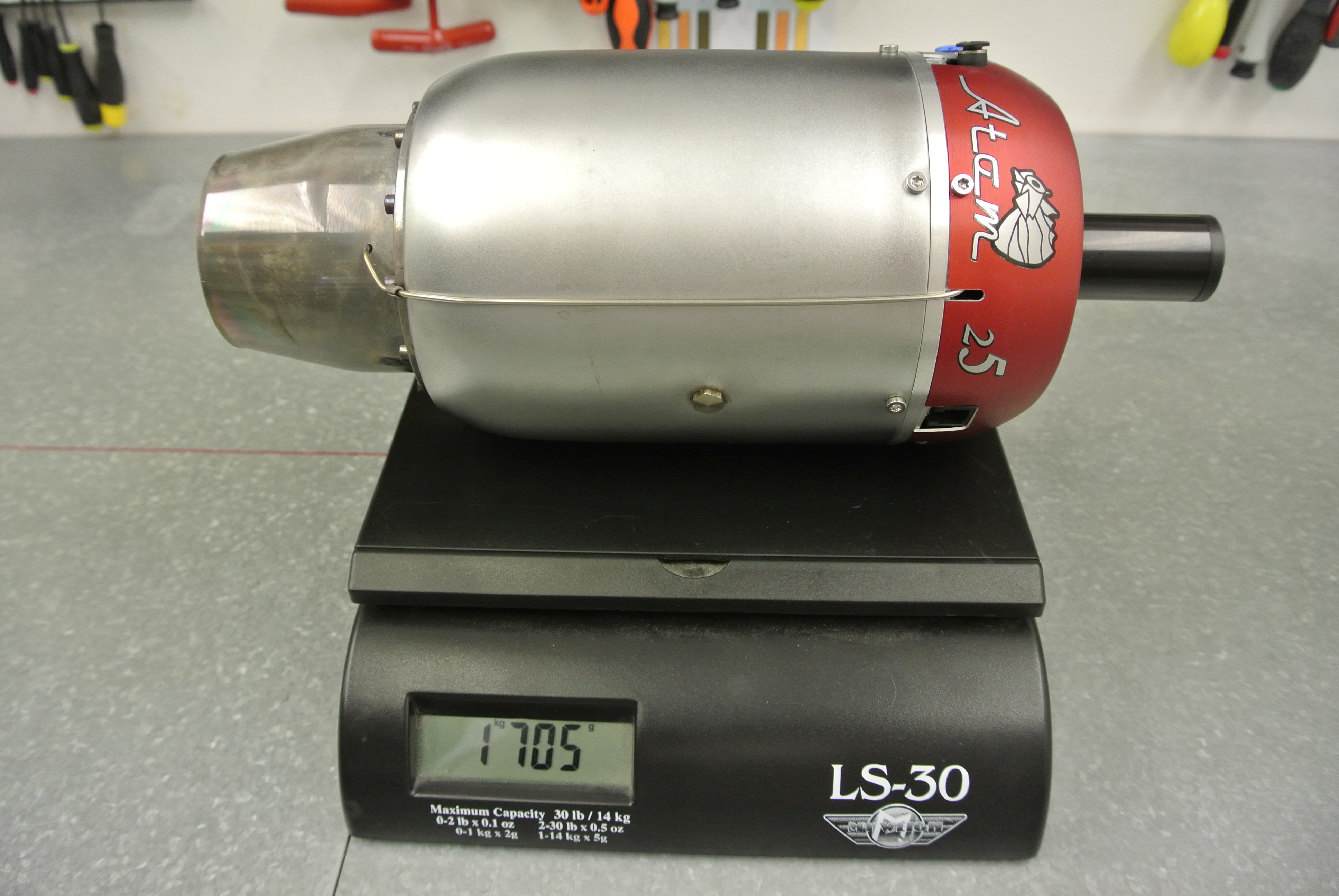

Today the turbine arrived, it's the new Jet Italia Atom 250, a very compact and light turbine which delivers a big punch in the 'newton' field, my friend Francesco has worked hard to build and ship me this turbine so that I can test and fit this gem of engineering into the VIXEN.
I chose the Atom 250 as it looked to provide exactly what I wanted in a lightweight and compact package.
Attached are some pictures of the Atom 250 and look forward to the results it delivers when the build is complete. More to follow.

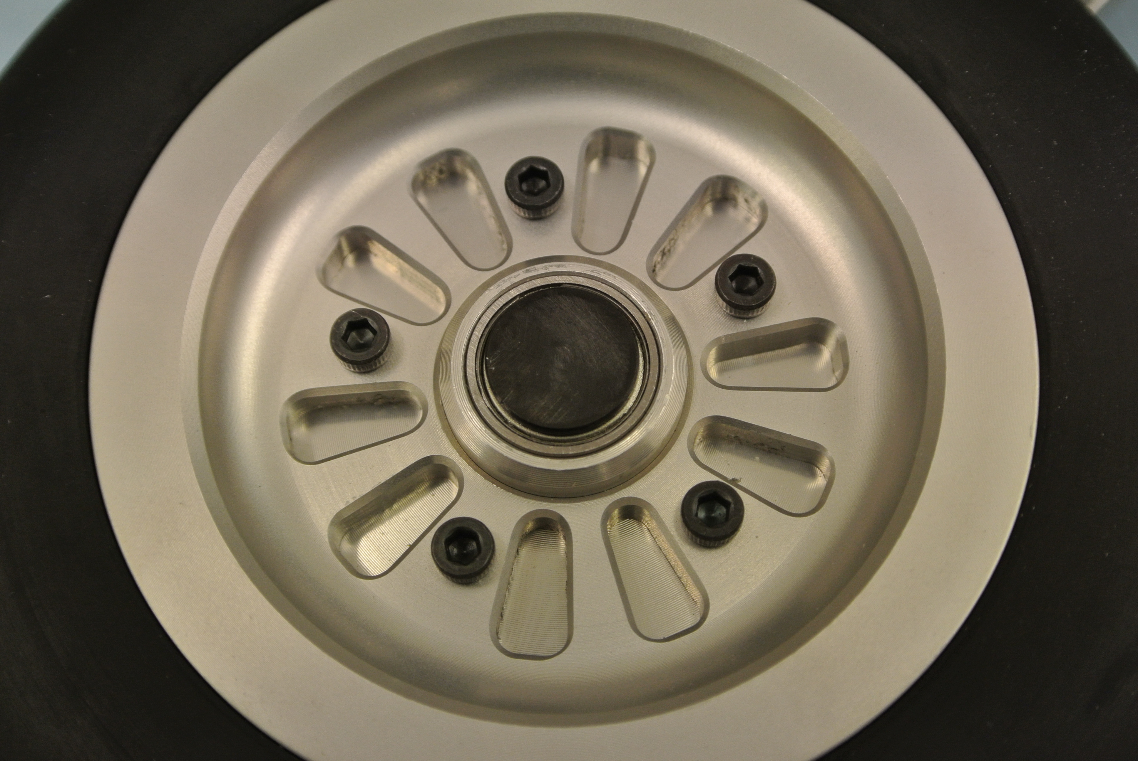

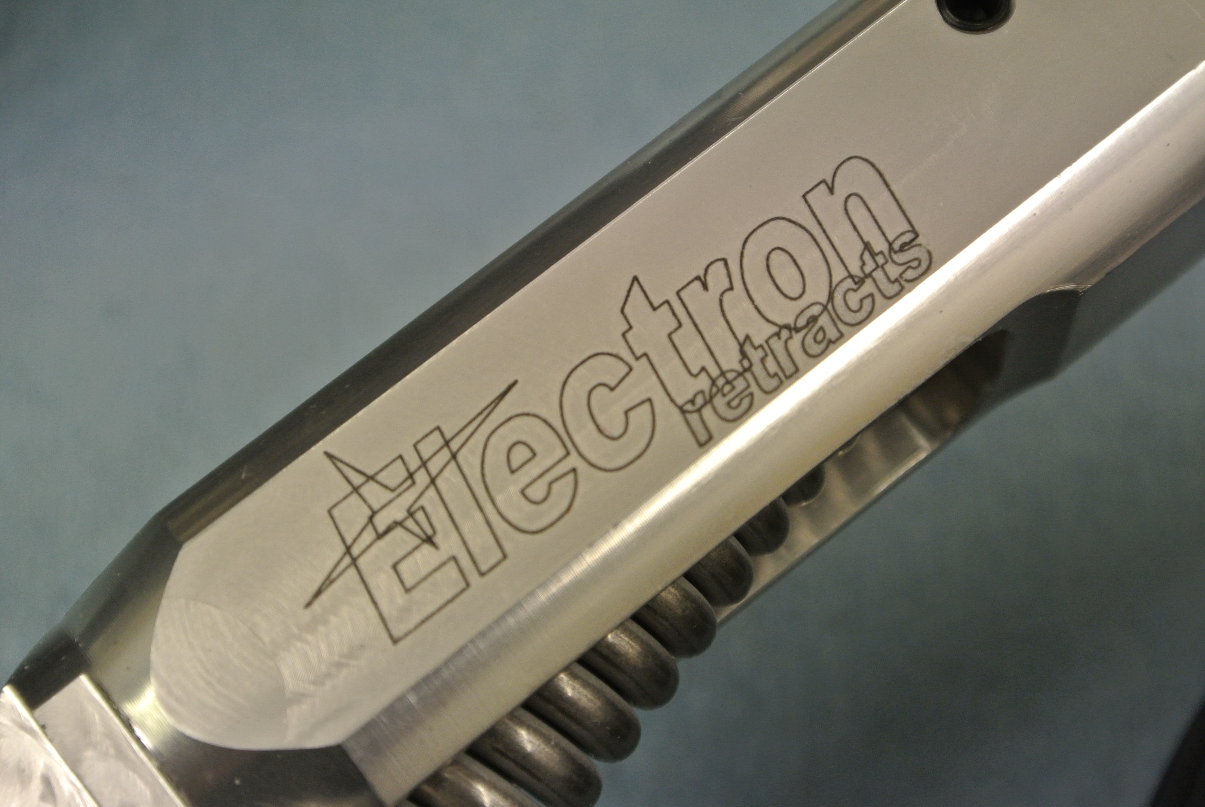

The Vixen is now in final paint prep and should be packed and shipped later this week, whilst this is going on I have received a set of custom made Electron Retracts to test and ultimately offer as an 'electric' option for the Vixen kit.
Big thanks to Xoel for working with me on this and machining special legs and parts for the retract units to get them to the right configuration.
There will be an amount of 'adapting' mainly on the gear rails to hopefully get these to fit so the final results wont be known until I have the airframe with me.
I've never been a great fan of air, electric tick more boxes for me and having had very good experiences with Electron on past models the choice was a simple one for me and I'm glad Xoel has agreed to work with me on this.
Quality is really top notch, the feel gives you confidence in the durability and robustness and all the machining is beautifully finished. In addition I have the R200 controller and programming pad to set things up and the mains are running the Electron electric brakes.
A few pics of the gear supplied for testing....
marcs

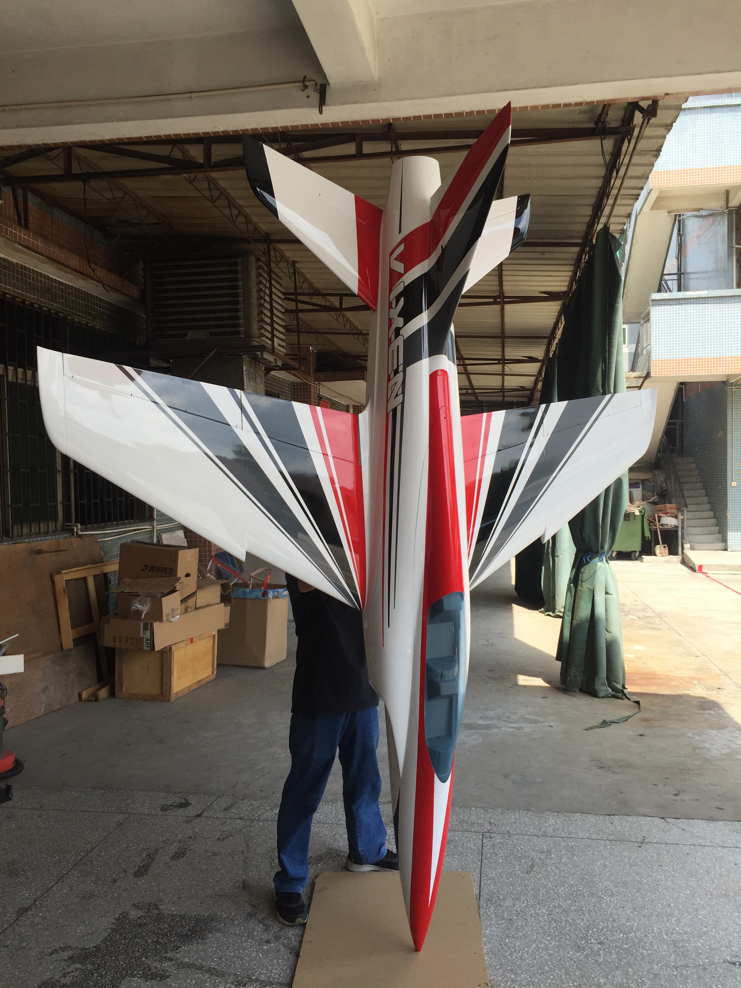

Some key features of the VIXEN are:
Split fuselage aft of wings to make a compact transportation format.
This is what Marc is talking about
You can fit it in a minivan

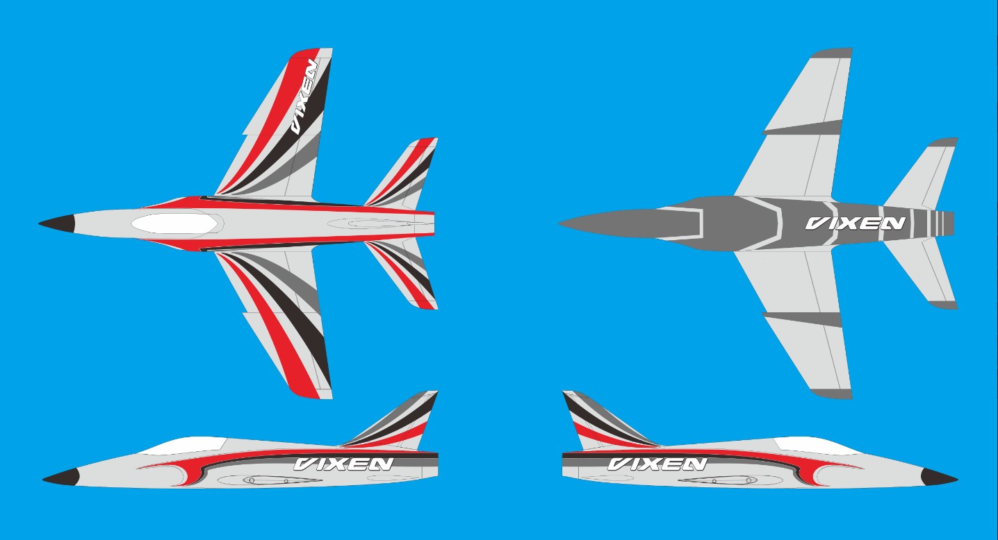

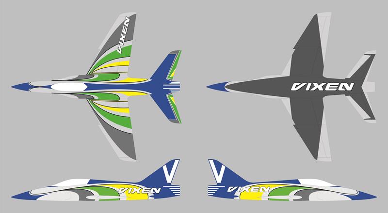

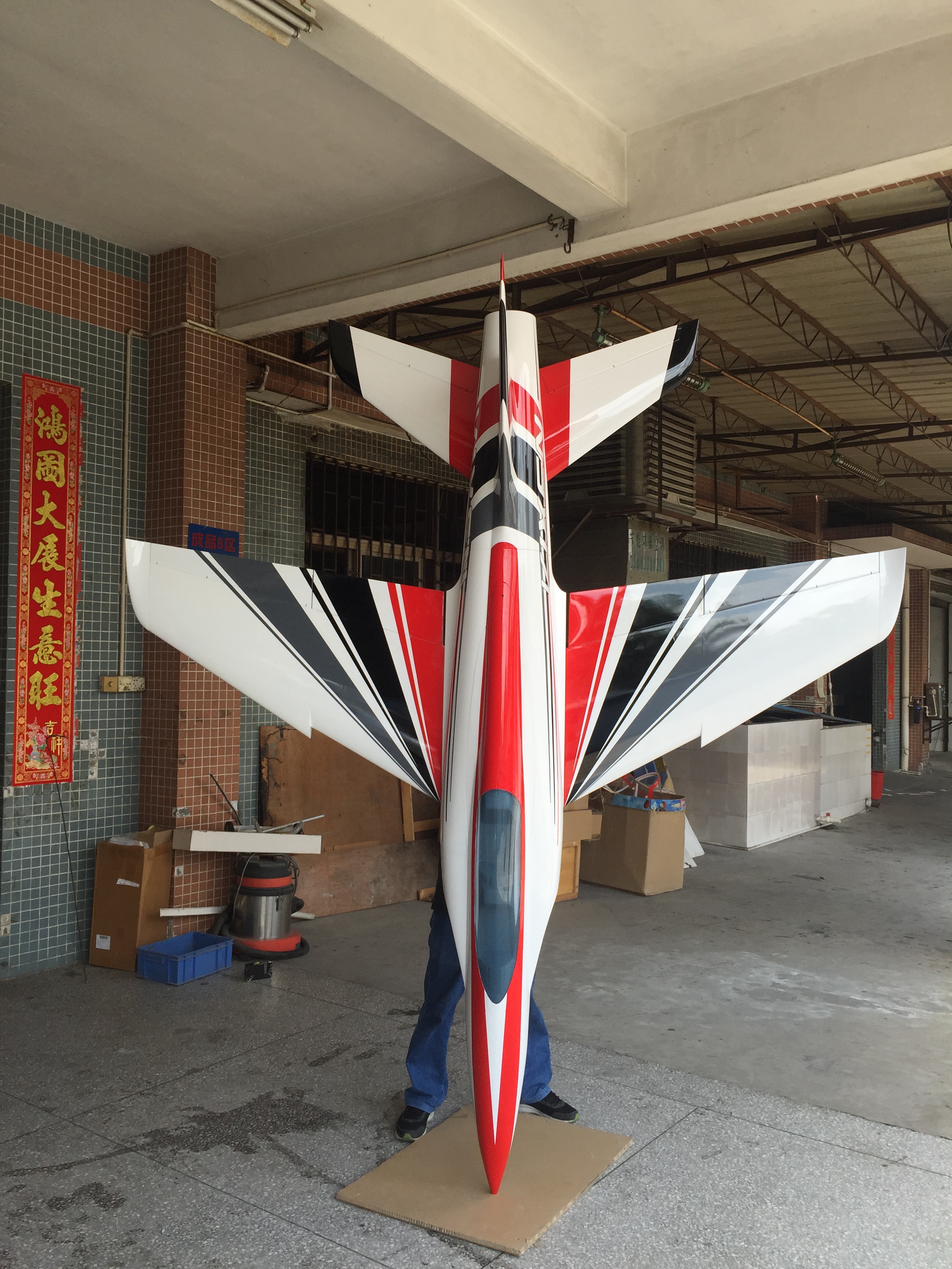

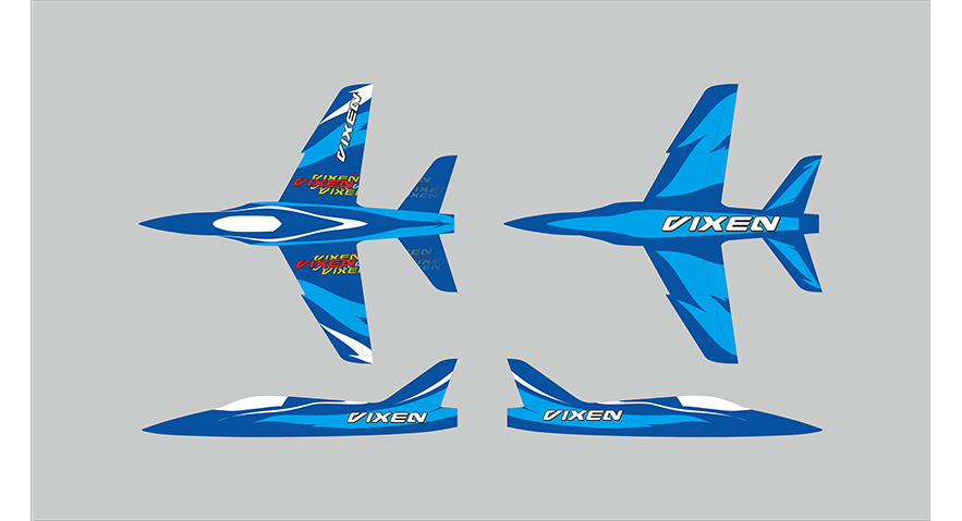

Let me post some new basic Vixen color scheme
ID:	2109238   Click image for larger version
ID:	2109239   Click image for larger version
Name:	Vixen 2 (Copy).jpg
ID:	2109240   Click image for larger version
Name:	Vixen1-3 (Copy).jpg
ID:	2109241   Click image for larger version
Name:	Vixen1-4 (Copy).jpg
ID:	2109242   Click image for larger version
ID:	2109243   Click image for larger version

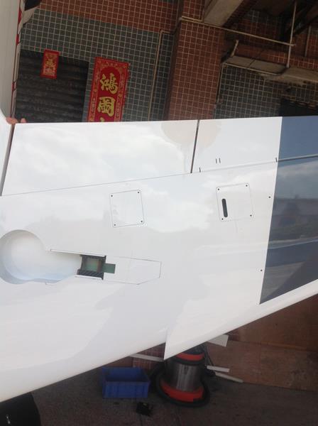

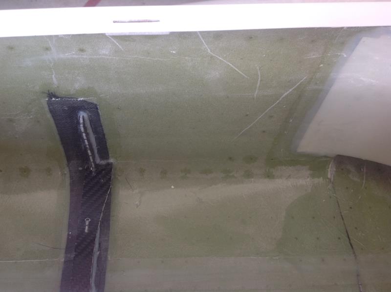

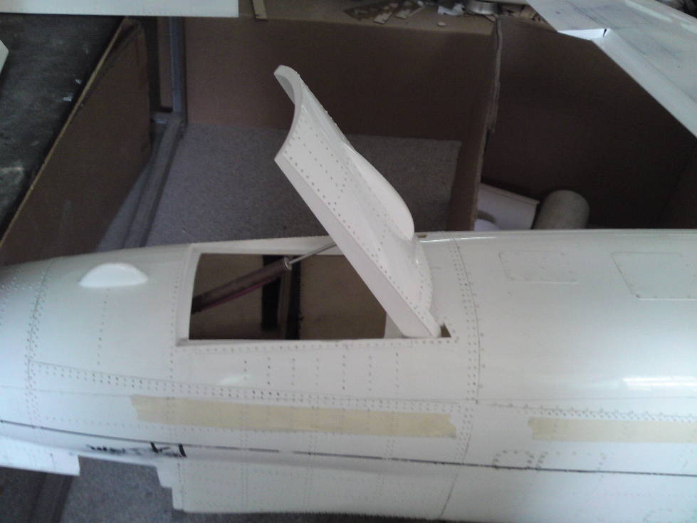

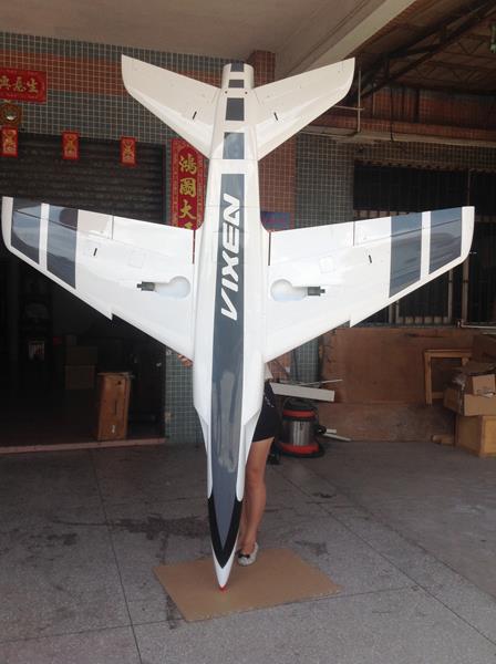

A little more pictures from Marc's Vixen
The first picture shows the flaps linkage are internal, the second is the bottom of the color scheme, third is the back, fourth is the nose door gear installation and finishing (hinges are aluminum) and last one is the reinforcement (all the plane are reinforced with carbon fiber but did not show once it is done before the Airex layer), now all formers has an extra stripe of carbon fiber before installation.

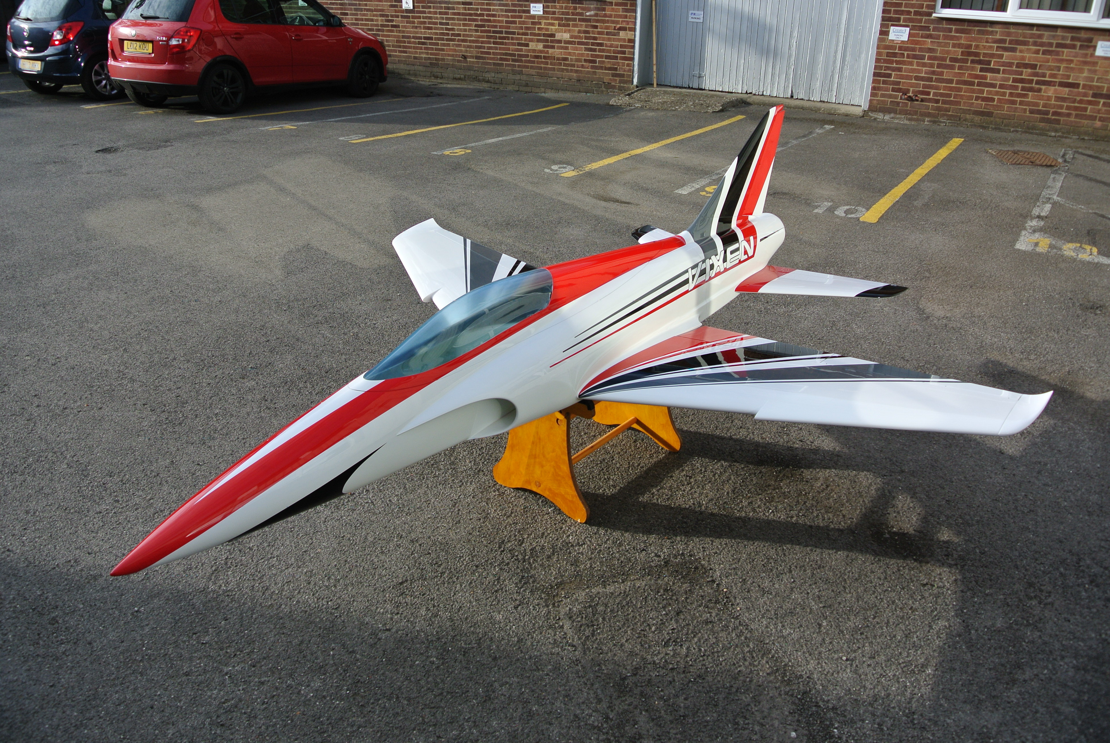

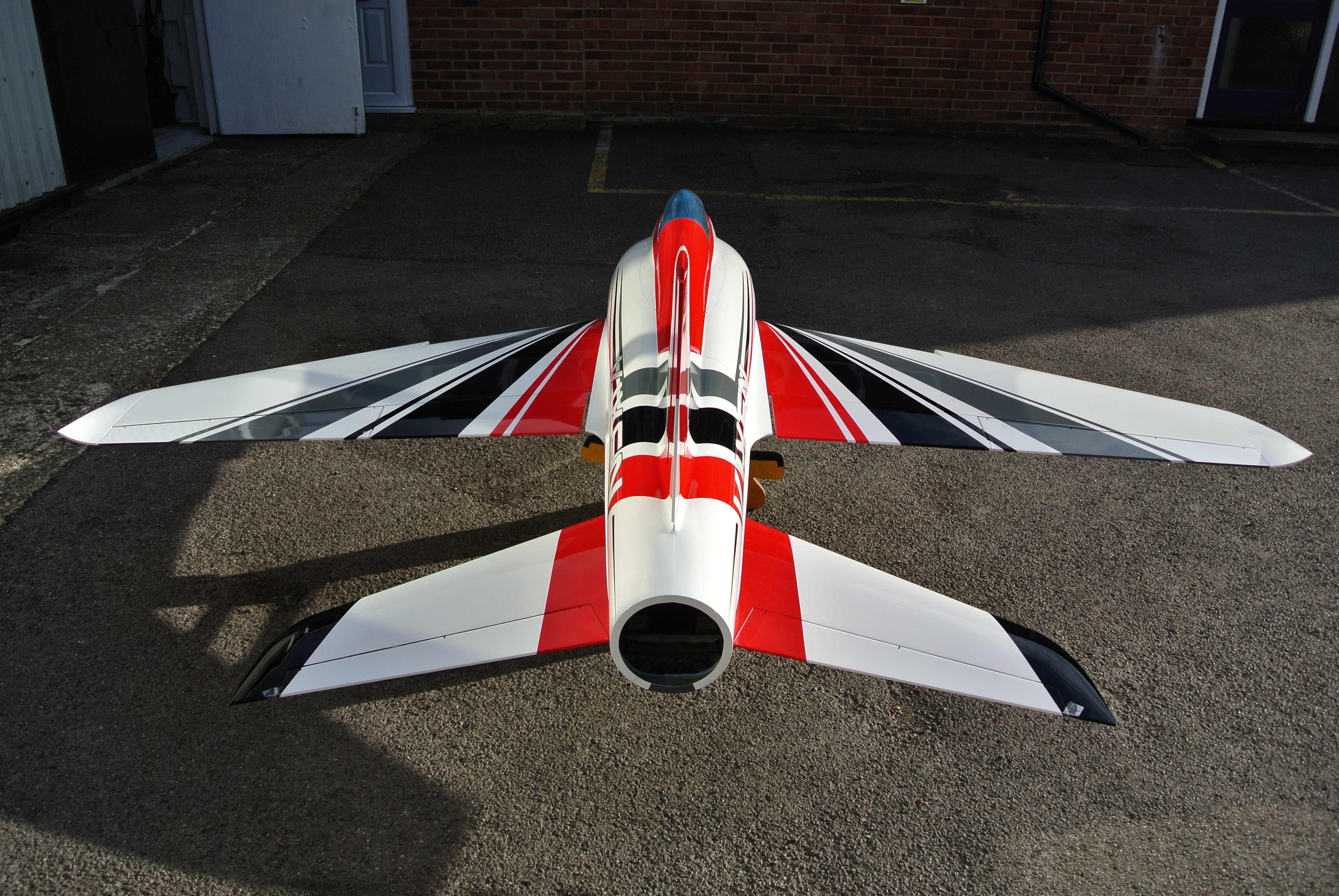

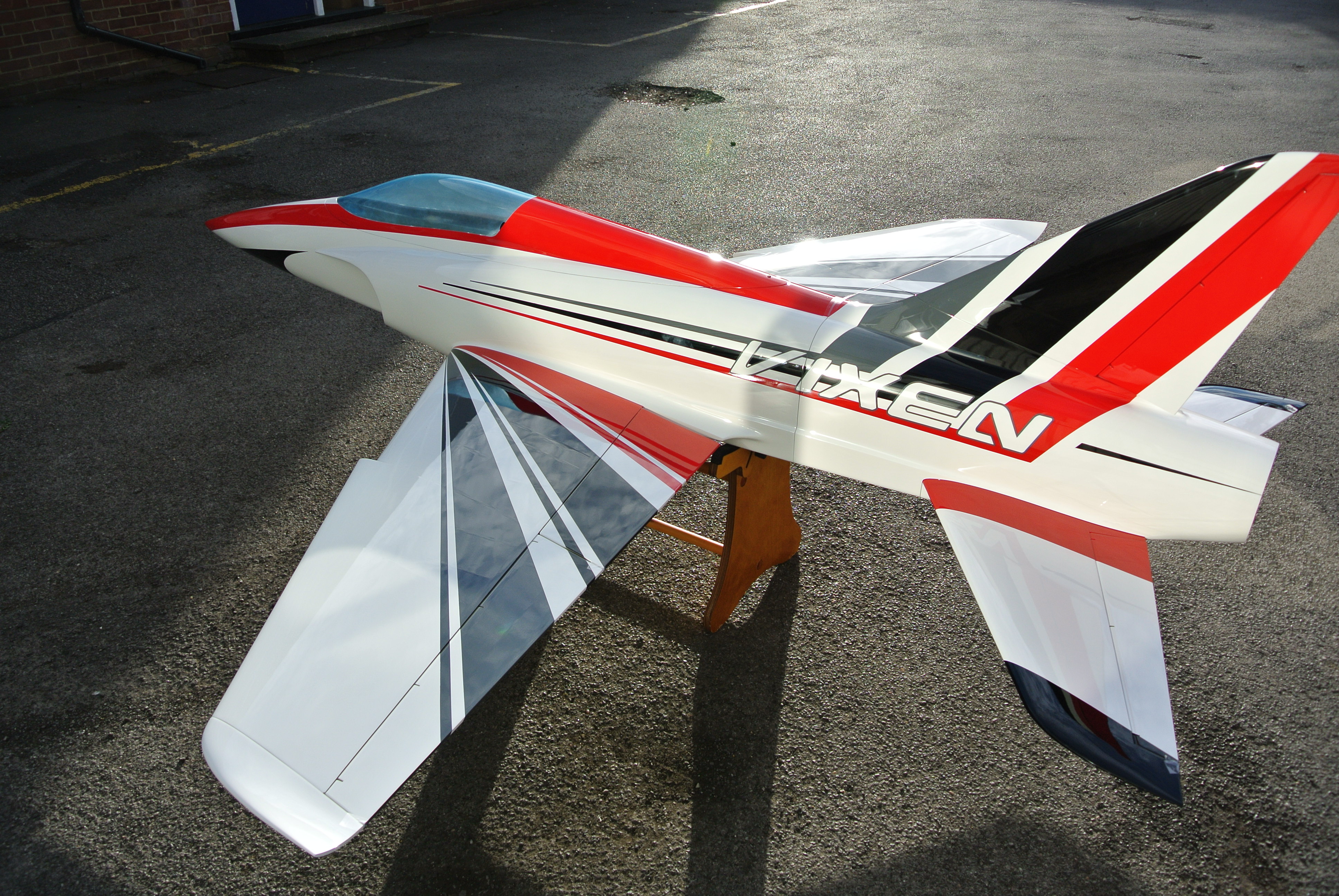

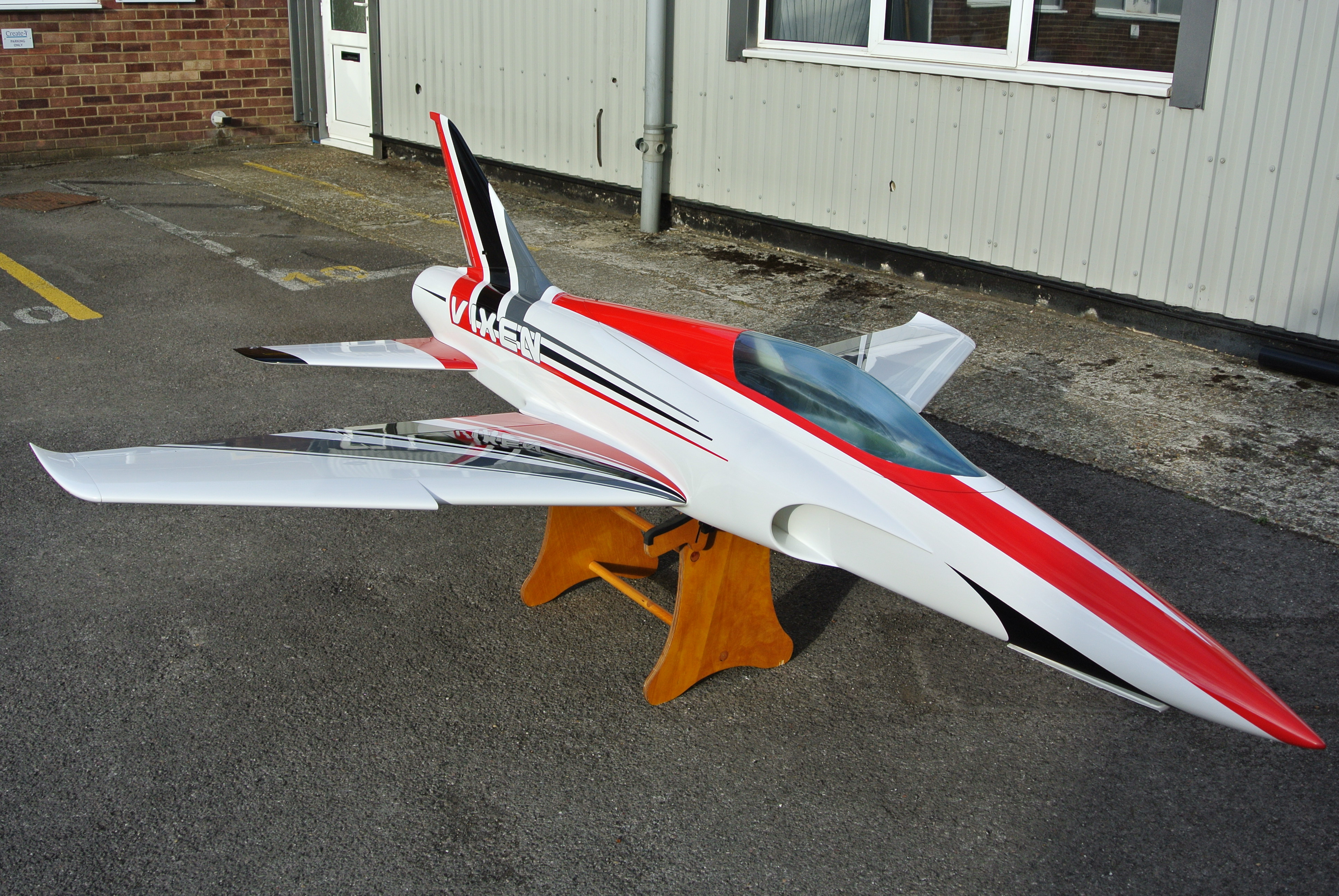

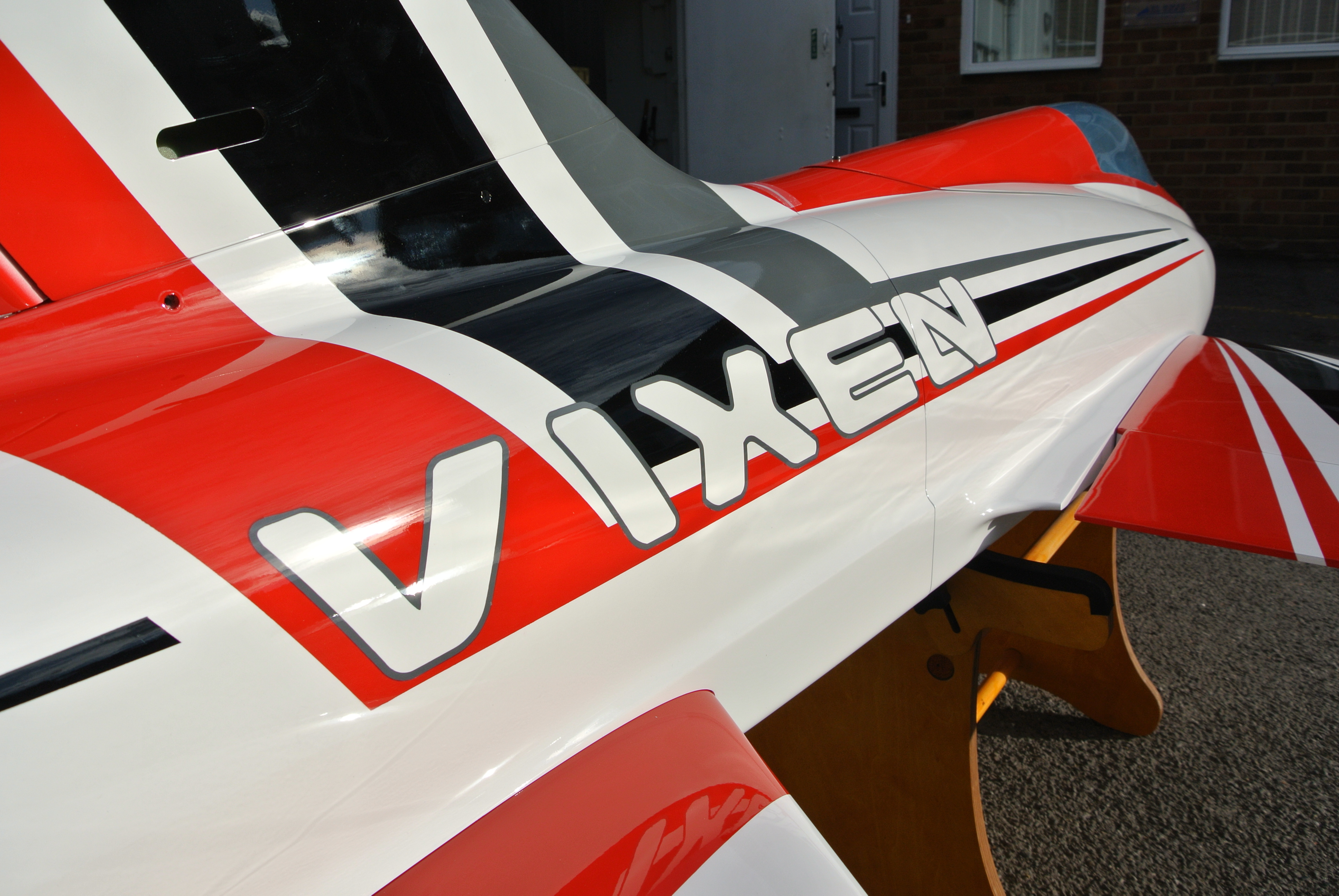

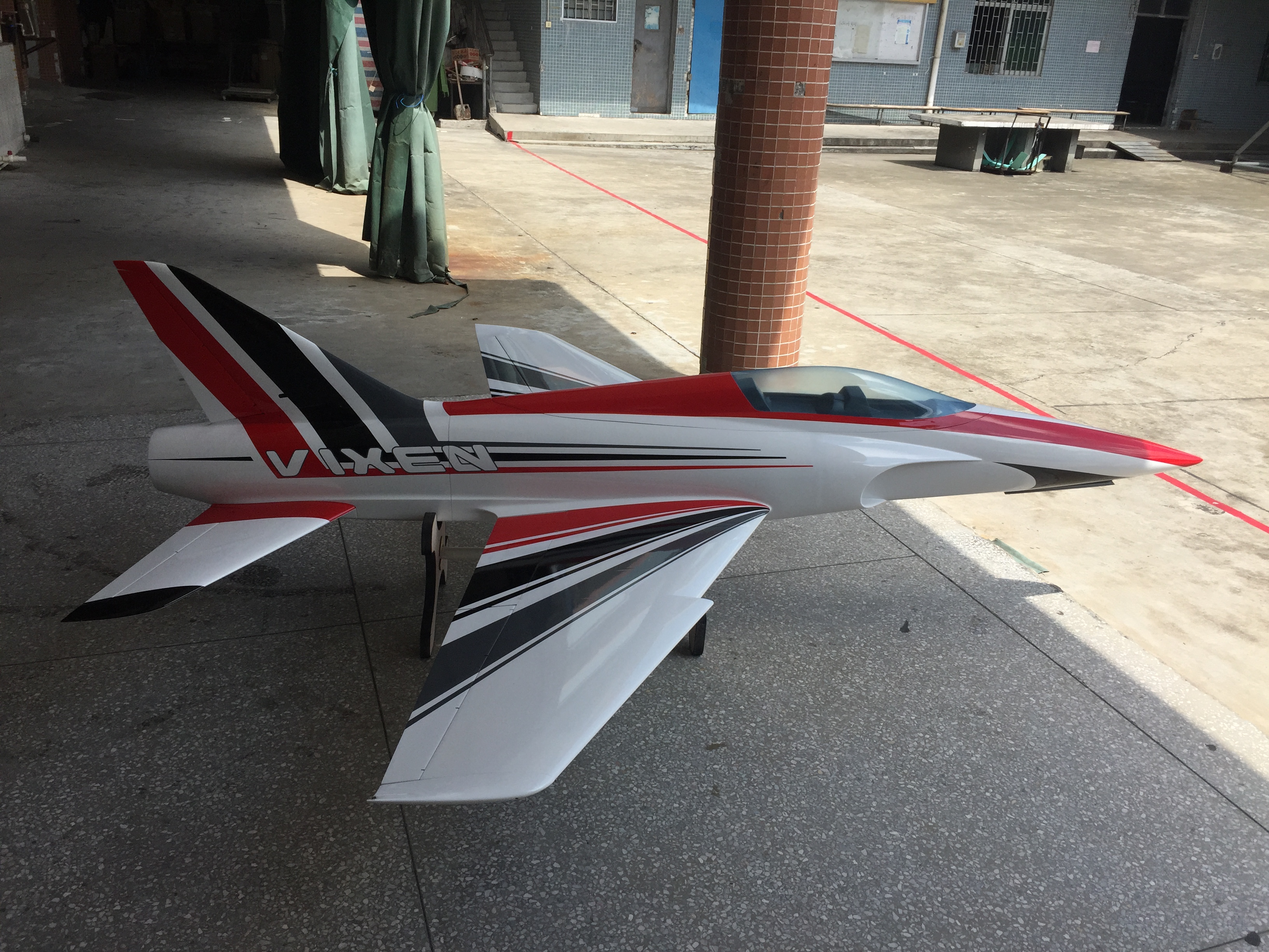

The VIXEN arrived earlier today, unpacked it after work hoping all was well.
The box looked as though it had been through the wars but luckily the main moulded parts were all in one piece with no damage, the canopy took a hit at some point and has been cracked and a piece missing at the rear on the side so hope to either repair, cover up or replace depending on time.
Paint is very good overall and nice not to have seams
Assembled the main parts and managed to get some shots in the sun tonight, looks like it wants to fly........
Will shoot some pics of the accessories although these might not be the final set as this is still the first 'production' model and my feedback will result in a few changes to hardware I am sure.
Bypass was included so will look to instal this and keep the propulsion system fully ducted, if time does not pan out will leave off for now.
More to follow over the next few days, enjoy.
marcs

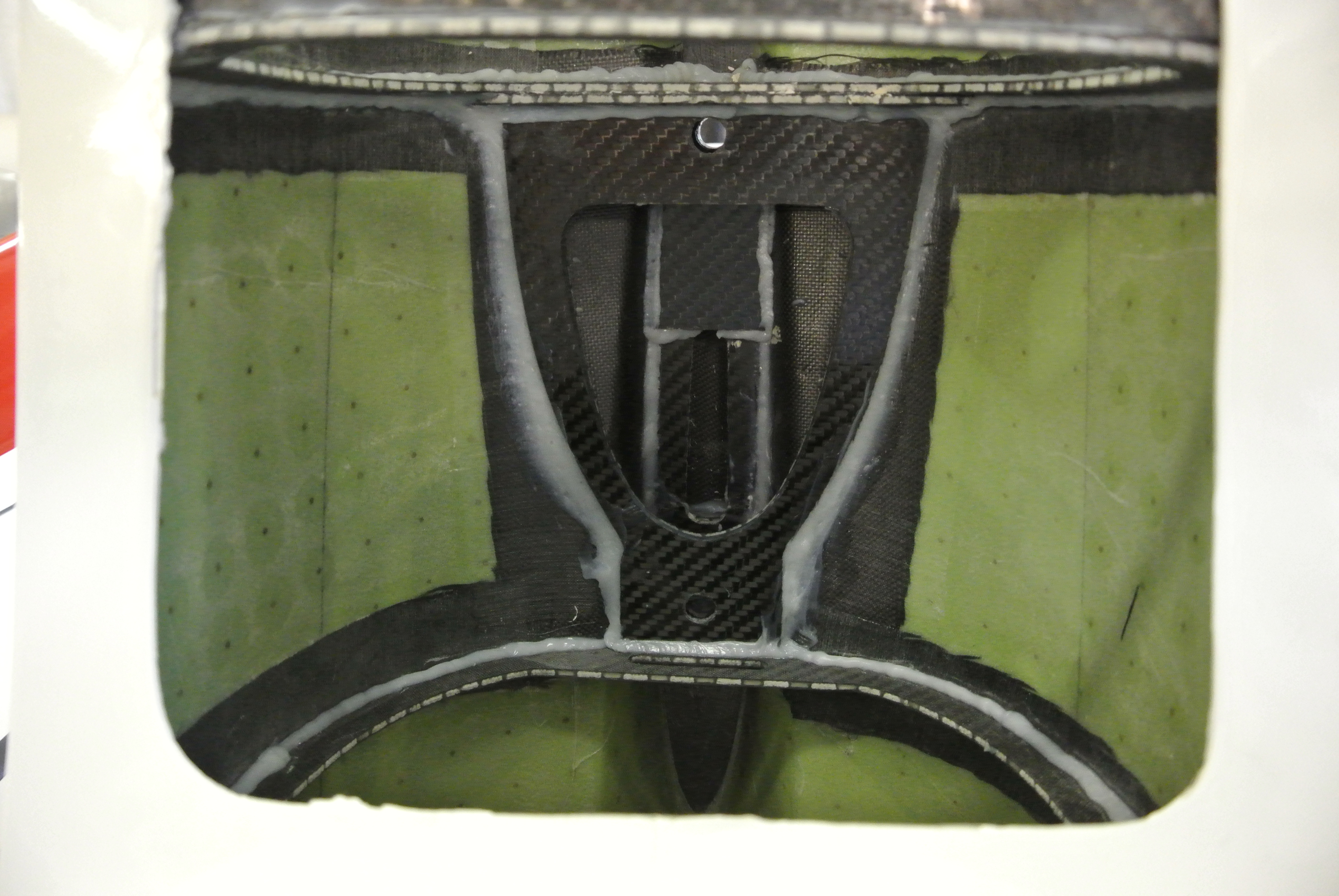

Nose wheel area:
Equipment tray middle support:
Duct blending:
Turbine former assembly (without and with lower bypass in place:
Rear main fuselage jointing section:
Rear section jointing face:
Rear pipe support and fin support formers:

I put my order in for one!!! Winter project for me.
Marc I love the Electron undercarriage. I had one made for the 2.5 viper and they works Great for my customers who have them!!
Thanks Billy D

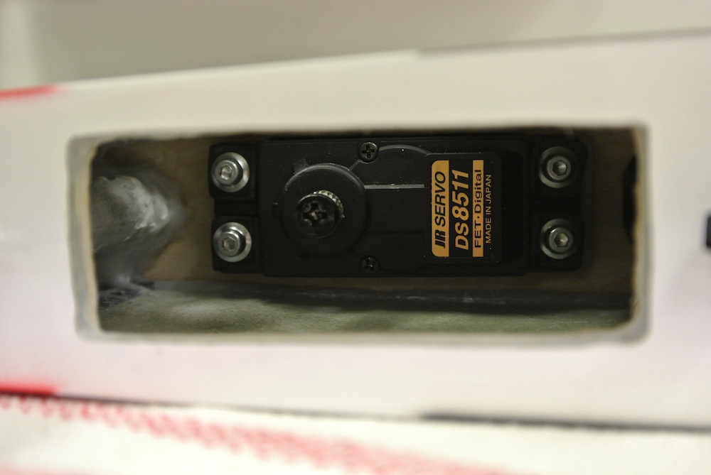

Fin
The rudder is pre hinged with a full length wire pin running through 3 pre-fitted lugs glued into the rudder, all moves freely without slop.
The servo location is inside the base of the fin rather than a hatch on the side, looks neater but slightly more fiddly to get the servo in. I'm using JR8511's on most surfaces and the pre-cut hole in the plate glued in the fin to accept the rudder servo was a perfect fit with no extra work needed, even the pilot holes for the servo screws lined up too.
I had to open out the opening in the base of the fin a little to get the 8511 in but this was a 10 minute job using my Permagrit files which if you have not heard of these tools do a Google search as they are invaluable to any model builder (big plug!).
I have not yet worked out the best servo arm lenght to get the desired throws (rudder 38mm from base line at rudder base) but have a 25mm and a 30mm arm on order to see which is best.
Rudder horns are supplied and are nicely made items cnc cut from 3mm carbon fibre plate, slots are pre made in the rudder so most of the work is done but they need opening out and preparing to accept the horns. Picture shows them in place but not glued, I will Hysol later today.
Rudder fixing to fuselage is via two aluminium rods (solid) which are well secured inside the fin and locate into the very strong formers fitted inside the rear section (picture in earlier post). Fin is secured to fuselage via two M3 bolts.
marcs

Speed Brake
The speed brake was an item I was keen to incorporate into this jet and Xtreme have included a well proportioned brake and supplied it pre-fitted with aluminium hinges.
I would have preferred to either have hinges not fitted or hinges that you could remove the pins from so that the brake could be removed to work on fitting the linkage. Hopefully the latter will be done on later kits.
When Rich built the first prototype he arranged the speed brake servo forward of the actual brake in front of the rear wing tube former, this location resulted in the servo location being off centre as the former has a central strengthening post, as a result and due to my weird desire to keep things symmetrical I have opted to locate the servo behind the brake so it can remain central. Hopefully it wont cause any issues operating the brake located here.
With hinges fitted all that is required to do is fit the horns, these are supplied as two cnc cut carbon fibre items which have long base legs to extend mid way down the brake to give a good area to fix the horns to. I guess you can fit them close together like a 'double' horn in between the hinges, I opted to spread them outboard of the hinges and make up a simple linkage bar from some 3mm threaded rod and copper tube slipped over at each end to locate the ball link at the mid-point.
Marked up the brake, keyed the area where the horn base legs were located positioning the linkage over the hinge point. Scuffed the horns, tacked them in place with cyano and microballons and then filleted with Hysol.
There is a servo tray supplied which comes in 4 parts, made from the same carbon sandwich material used in the formers of the Vixen, it assembles easily and after keying and cleaning with acetone I glued with cyan and microballons. The JR8511 fitted exactly without modification.
Sorted the threaded M3 rod linkage and ball link to give the right length and keyed the servo mount and fuselage base. Glued servo mount to fuselage with Hysol.

Old 07-27-2015, 08:41 AM

Is that bar supported? If not air pressure with bow it and it will end up with a "set"
Dave
Old 07-27-2015, 08:54 AM
marc s
marc s's Avatar
Join Date: Jan 2007
Location: farnborough, , UNITED KINGDOM
Posts: 3,294
Dave it's a stainless M3 threaded rod with a copper sleeve over it each side of the ball link, I'm pretty sure it will be fine but as an alternative I have a length of 3mm solid carbon rod which might serve better - will check the flex once the servo mount has cured.
If it proves not to be stiff enough I will upgrade to a 4mm carbon rod or tube.
marcs

As has been pointed out the large span between horns might not be ideal, but can be overcome using the methods you described.
The other observation I have is with the servo behind the air brake it appears that you can not use the mechanical advantage of the servo arm position, (i.e. directly away and in line with the linkage) when the air brake is fully deployed with the servo arm that is shown.
Two evils! If the pushrod is pushing then it will flex (OK maybe shorter that way around) If Marc had used a standard metal arm and a ball link he could have the arm inline..but then all the load is on the servo output spline and servo bearings. The forked clevis arm reduces that.
Ultimately I prefer an air ram, servos are loaded always and if they get a stuck gear you can't land with the airbrake open to slow it (without perfect timing on a switch) as the servo will be destroyed, an air ram can compress.
With the 8511 holding power and expected slow flight from big flaps, it won't be loaded too much/too long.

Dave I agree, pulling is always better than pushing when it comes to longer
control rods. However, In my set up it was short and was a non-issue
You do need a very hi torque servo for this set up though.
As far as needing the airbrake, the first couple of flights were flown without using it, the flaps are very effective, the air brake is a bonus!
