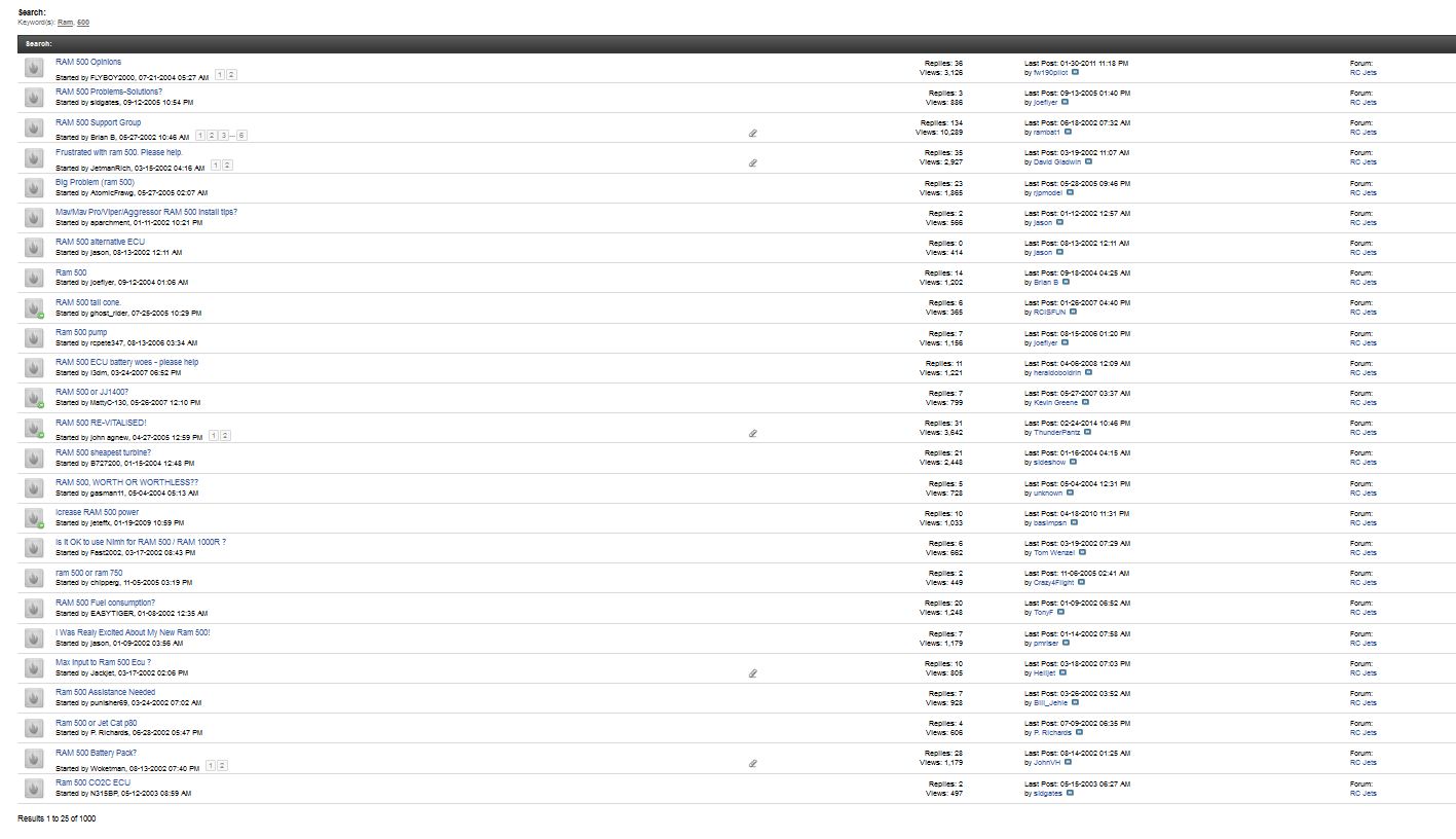

Silly question... but do you do a search of the thread?
A quick search using the words "RAM 500" returned 1000 threads, quite a few for a Turbine that has been out of production for Ten years or so....
Oh in case you don't have it, here is the manual, Modellbau-USA was the same as RAM 500
