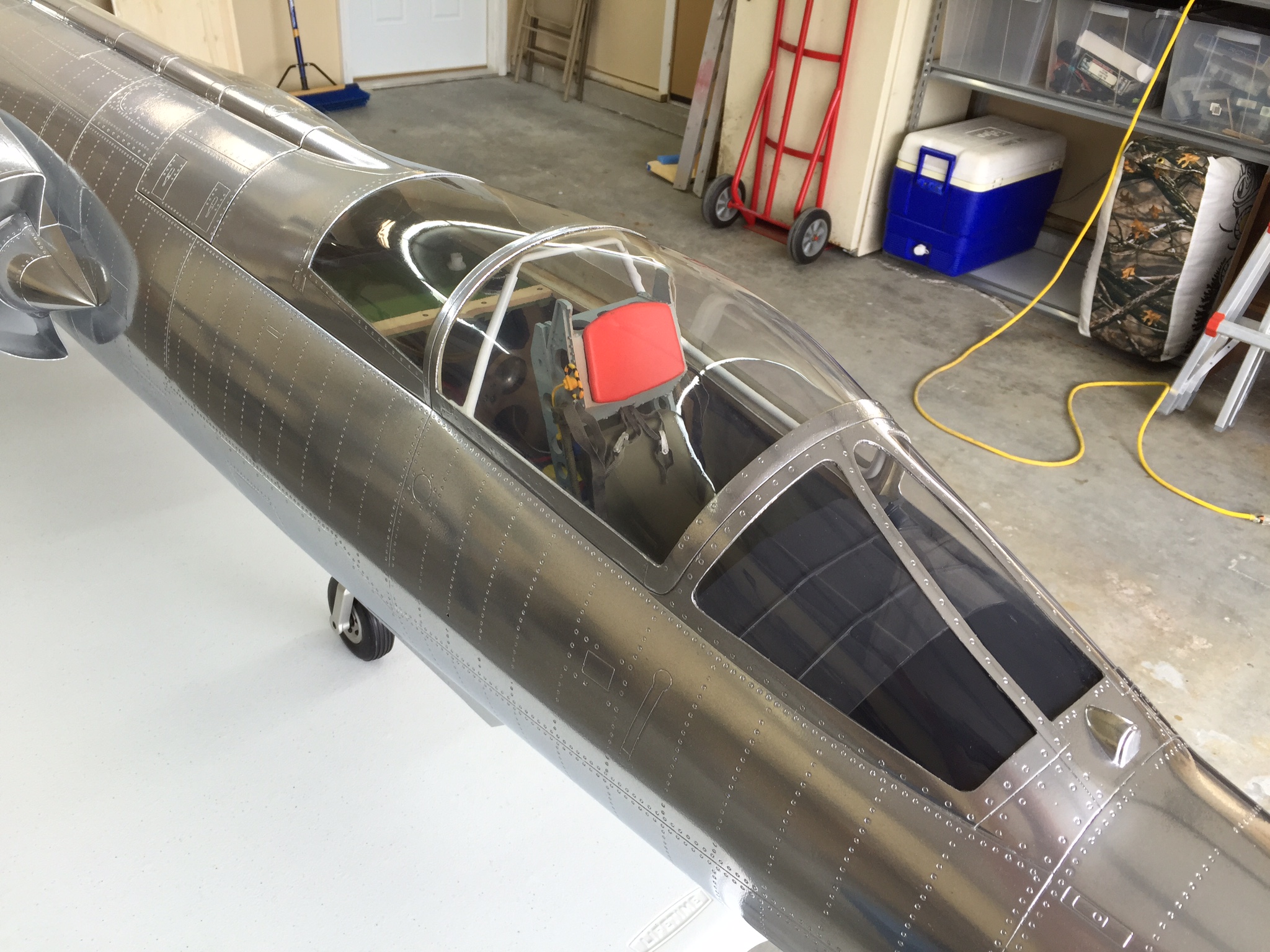

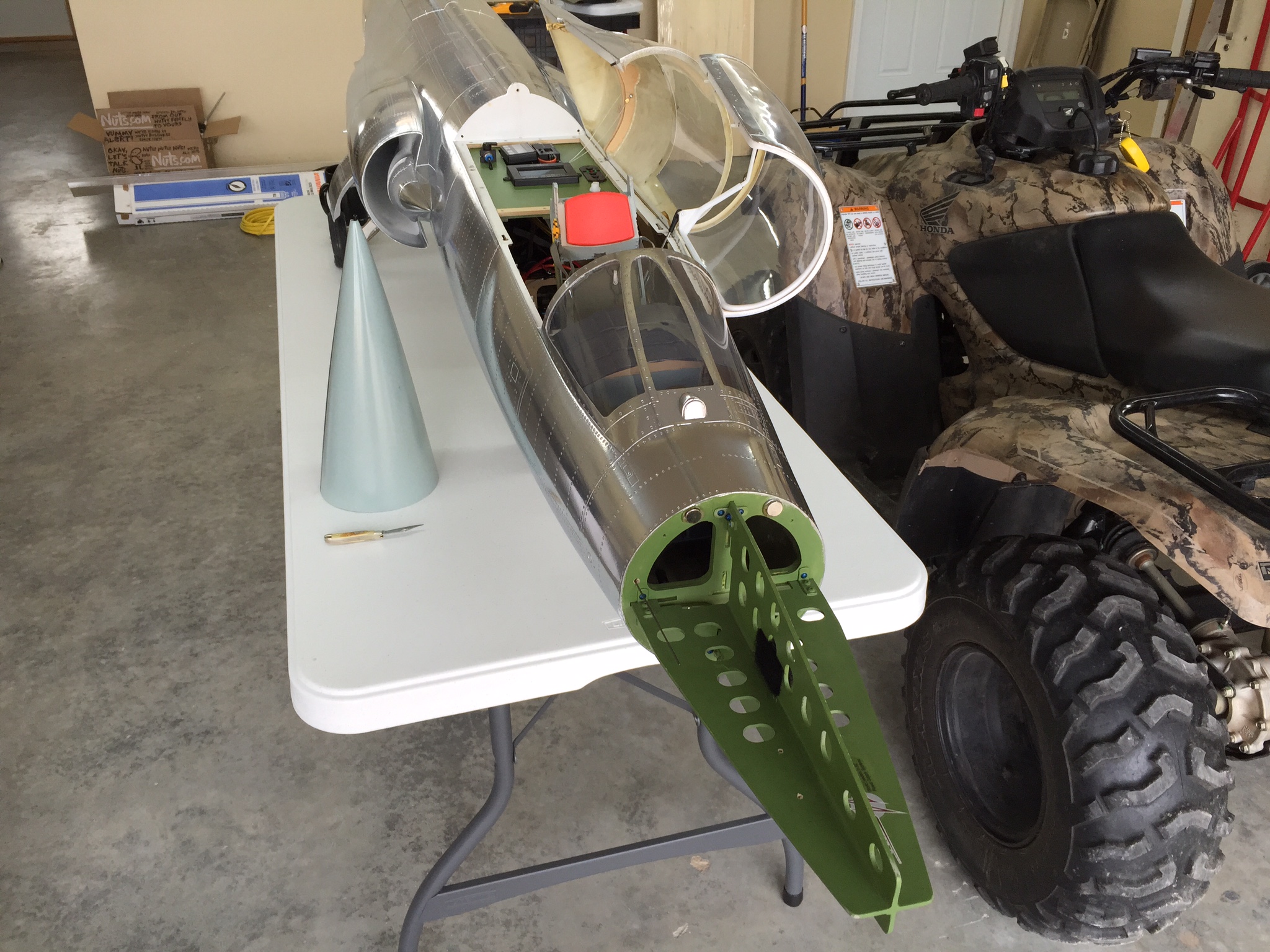

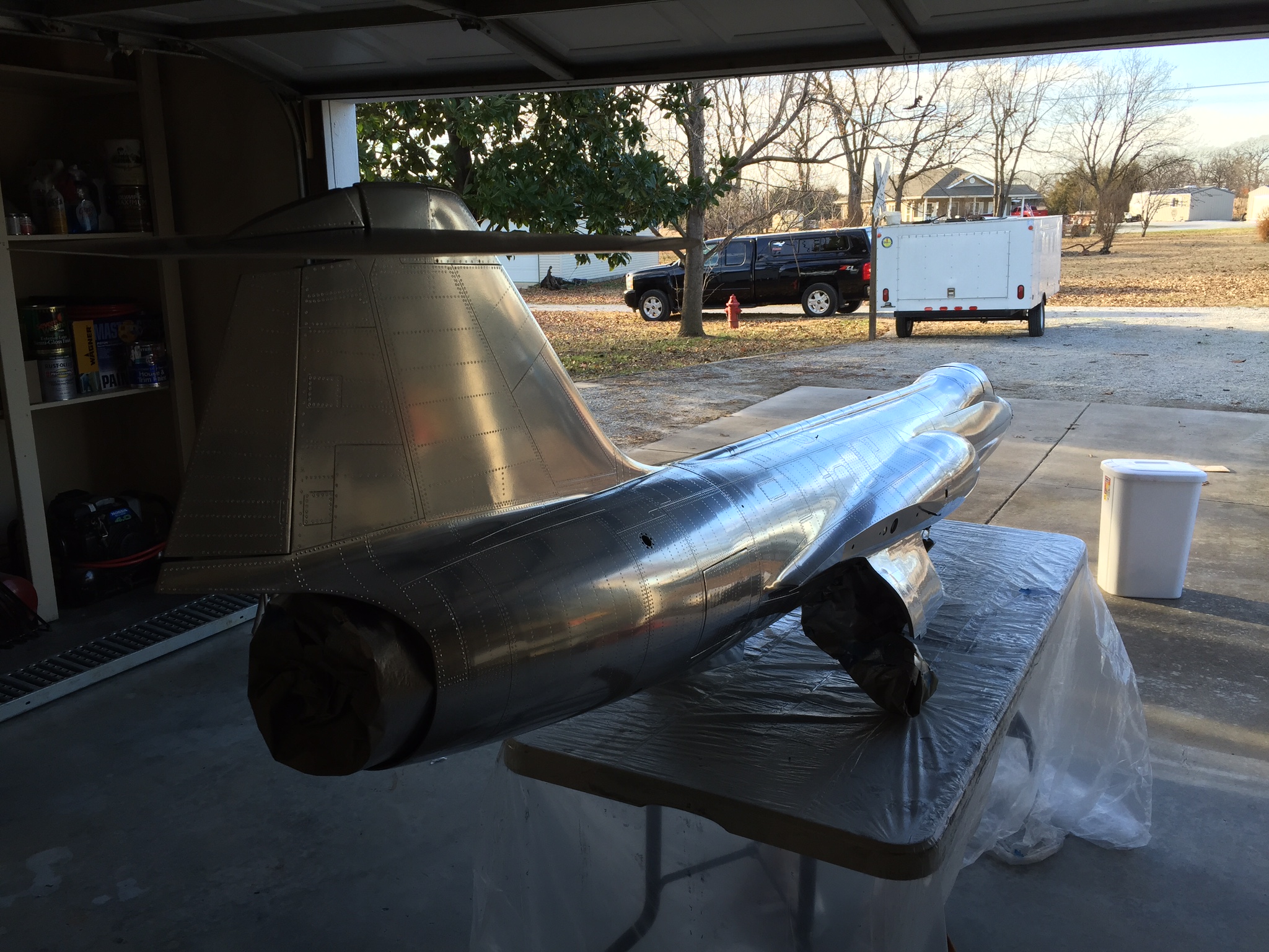

http://www.rcuniverse.com/forum/atta...mentid=2137124http://www.rcuniverse.com/forum/atta...mentid=2137125http://www.rcuniverse.com/forum/atta...mentid=2137126OMG I love the Starfighter! I got 7 great flights this year. I can't wait to fly it again. I'm stuck in Kuwait for the week so I'm gonna update my build thread. God blessed me with a month of good December Oklahoma weather so I got her painted and now I can spend the winter rubbing on placards and painting the bigger items. What did you do for a pilot? I put a 1/4 scale guy in there and he was too small.

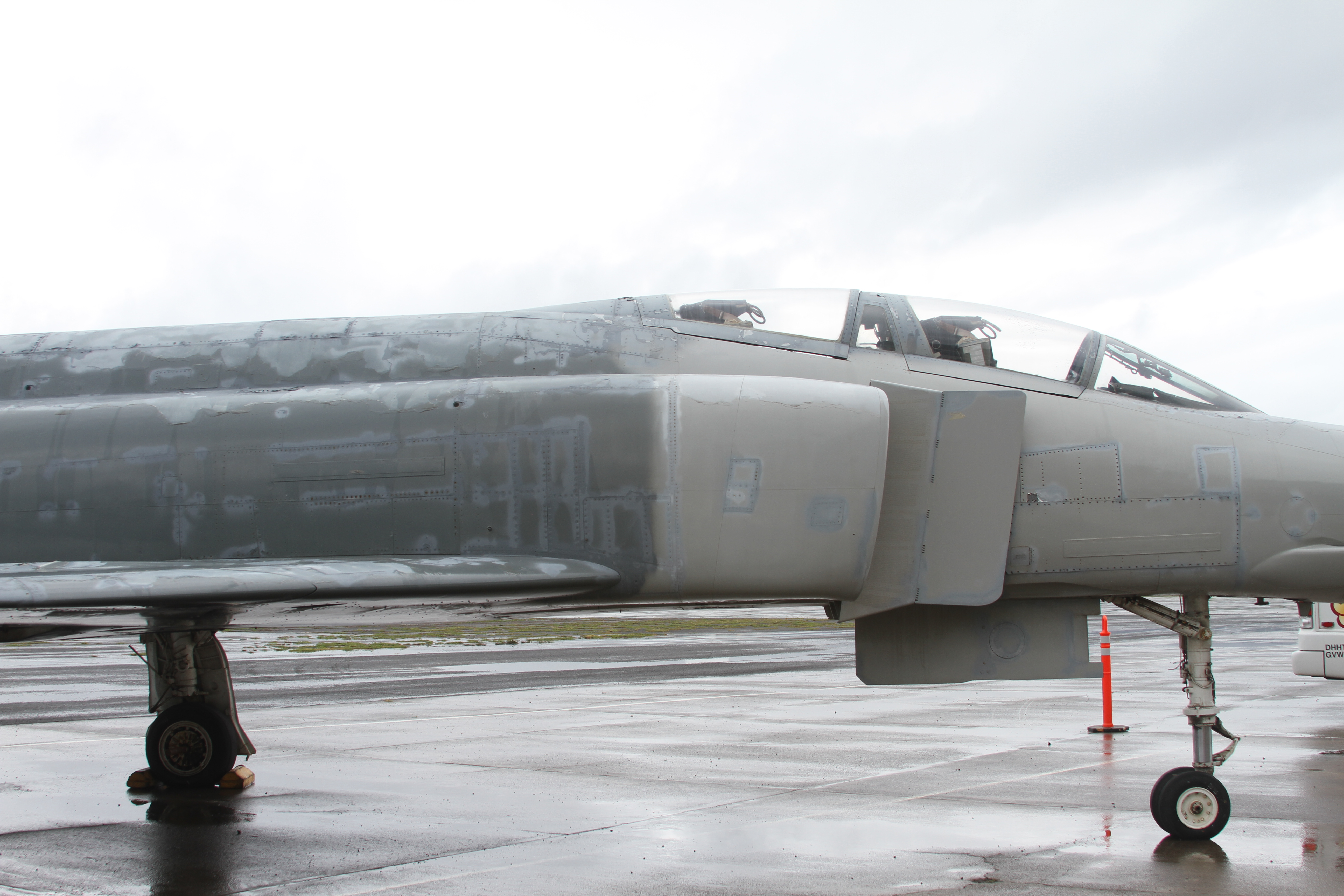

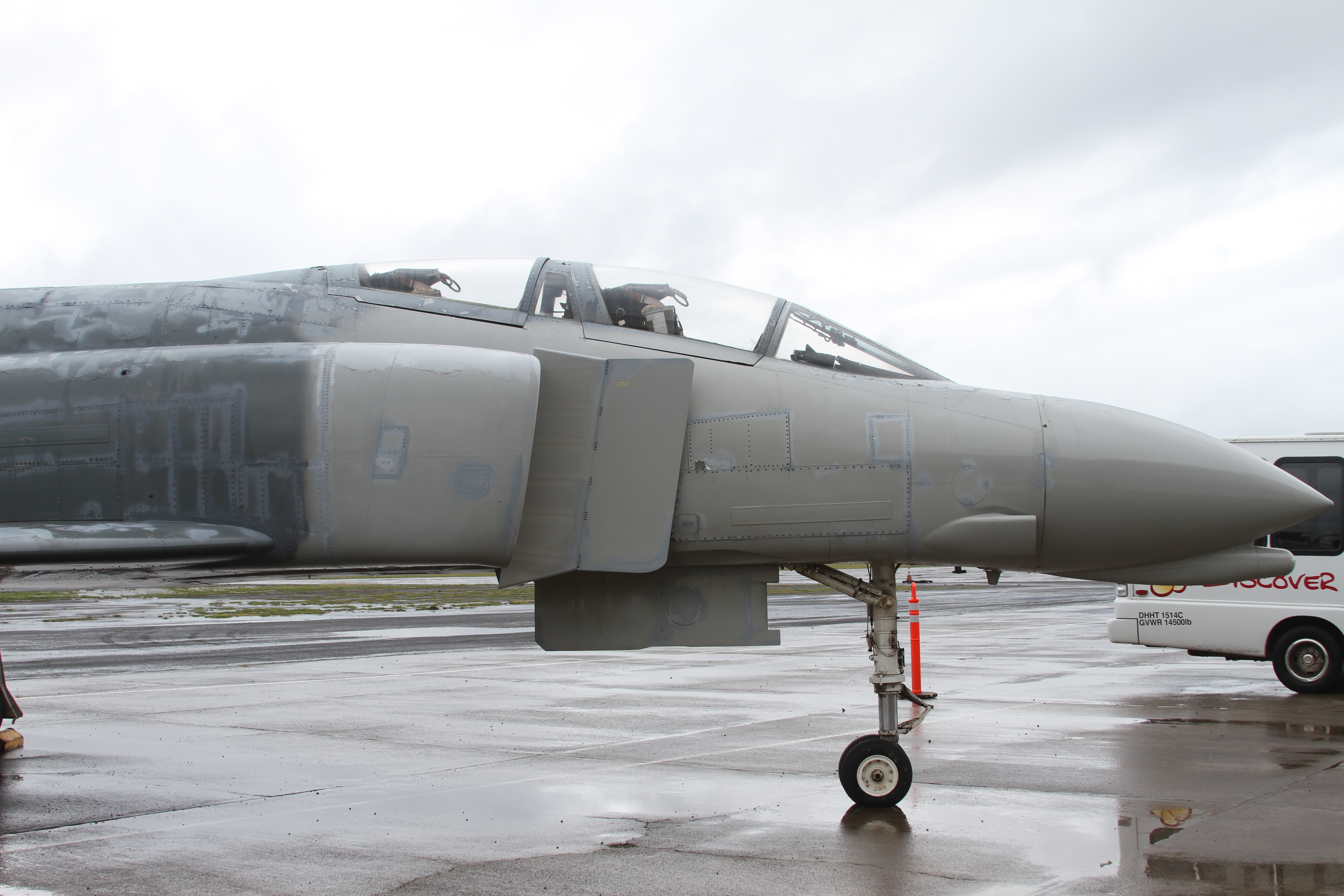

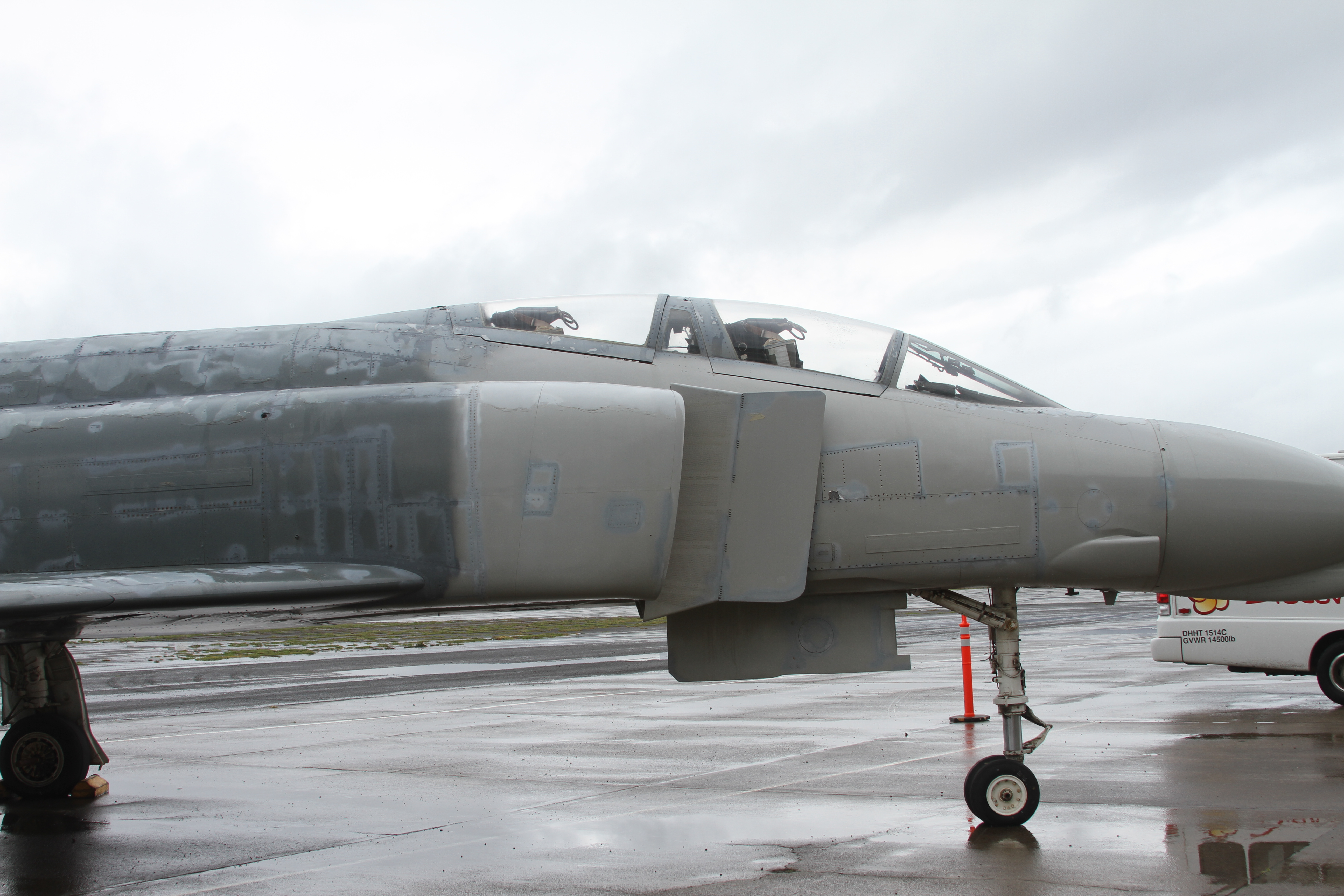

Here are a few pics I took of an F-4S at the Pacific Aviation Museum in HI.

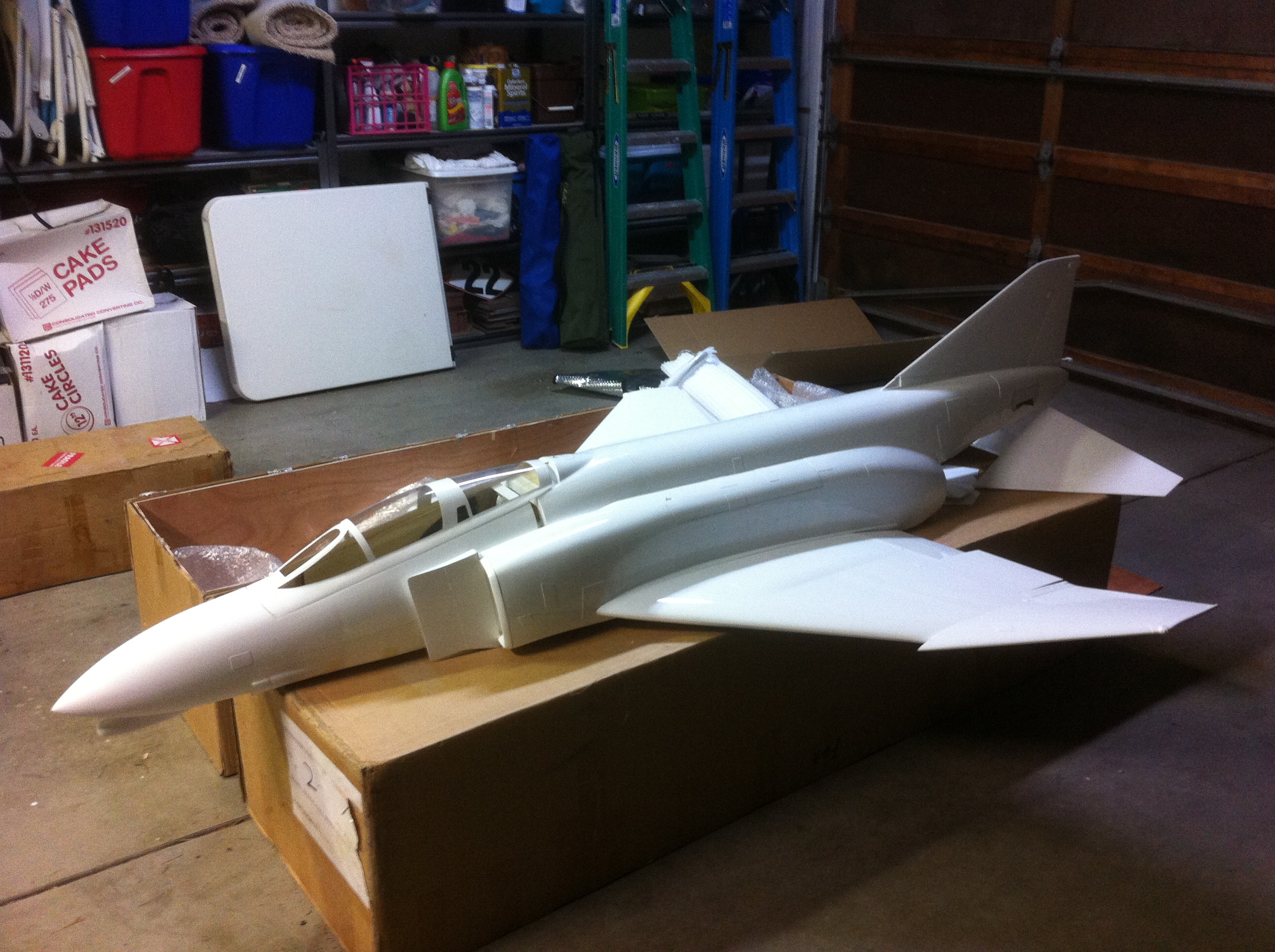

I focused on the nose section specifically to see the proportion of the nose in relation to the barge boards and intakes. You can see there is a certain distance from the leading edge of the board to the windshield hoop. There is enough space for the width of a man and the ladder lets say. On the SM F-4, now in both sizes, the LE of the board is too close to the windshield hoop. In the photo of the smaller 1/7.75 kit I owned you can see how I pulled the nose forward to see how it looks. The result is pretty obvious, it looks better.
http://www.rcuniverse.com/forum/atta...mentid=2209041
Centered on middle canopy frame
http://www.rcuniverse.com/forum/atta...mentid=2209042
Centered on front windshield hoop
http://www.rcuniverse.com/forum/atta...mentid=2209046
Centered on back canopy edge

SM kit - moved nose section forward
http://www.rcuniverse.com/forum/atta...mentid=2209048
So it may be insignificant to most but it kills it for me! Its like all I see when I look at the model so its not something Im willing to fix for the expense I think it should be correct out of the box.
Chris Nicastro 04-09-2017 01:57 PM
In any case this was the most obvious thing that was out of scale. I remember I opened the box to inspect it and about as fast as I was excited to see it I was disappointed but couldn't put my finger on what was wrong. Then I pulled out the books and it became obvious what I was looking at. There are other details that let this cool plane down too but I just wanted to show you guys what I was talking about.

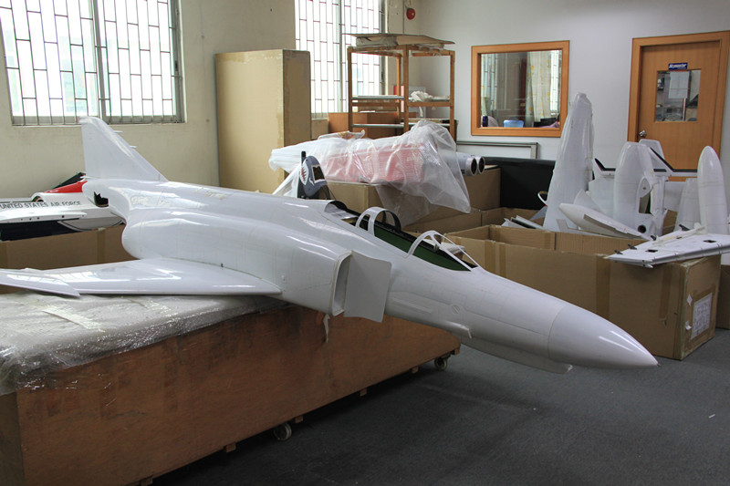

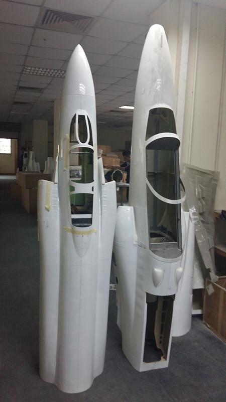

Here are the two new versions of the big F-4 so you can see what I'm talking about.
http://www.rcuniverse.com/forum/atta...mentid=2209370 http://www.rcuniverse.com/forum/atta...mentid=2209371

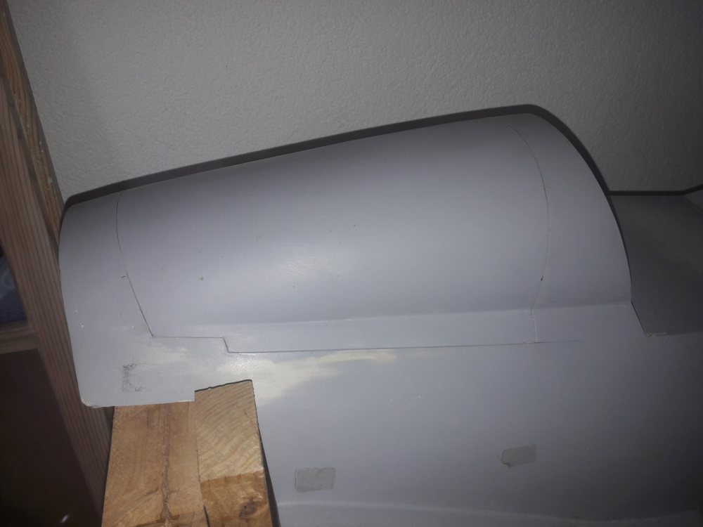

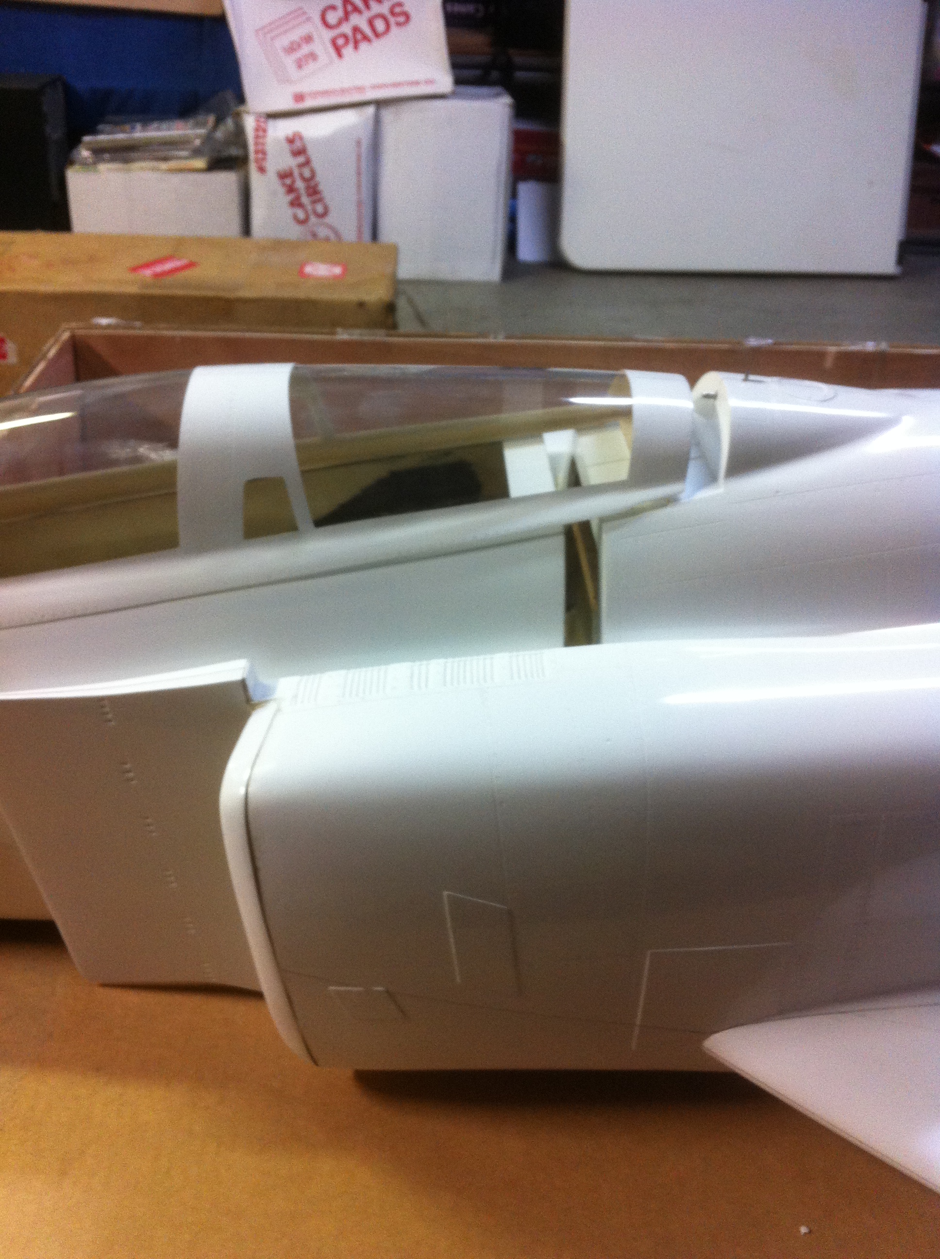

Looking better here?
http://www.rcuniverse.com/forum/atta...mentid=2209605

Id have to see it in relation to the other parts of the intake.
What did you work on in this picture?
Miniflyer 04-15-2017 10:35 AM
Ohh sorry i misread your issues. I thought you were criticising the proportions of the canopys....they are off too in my opinion (have the 1/7.5).
The pic is of my WIP plug of a museum scale 1/6 F-4E/F built from factory drawings.
