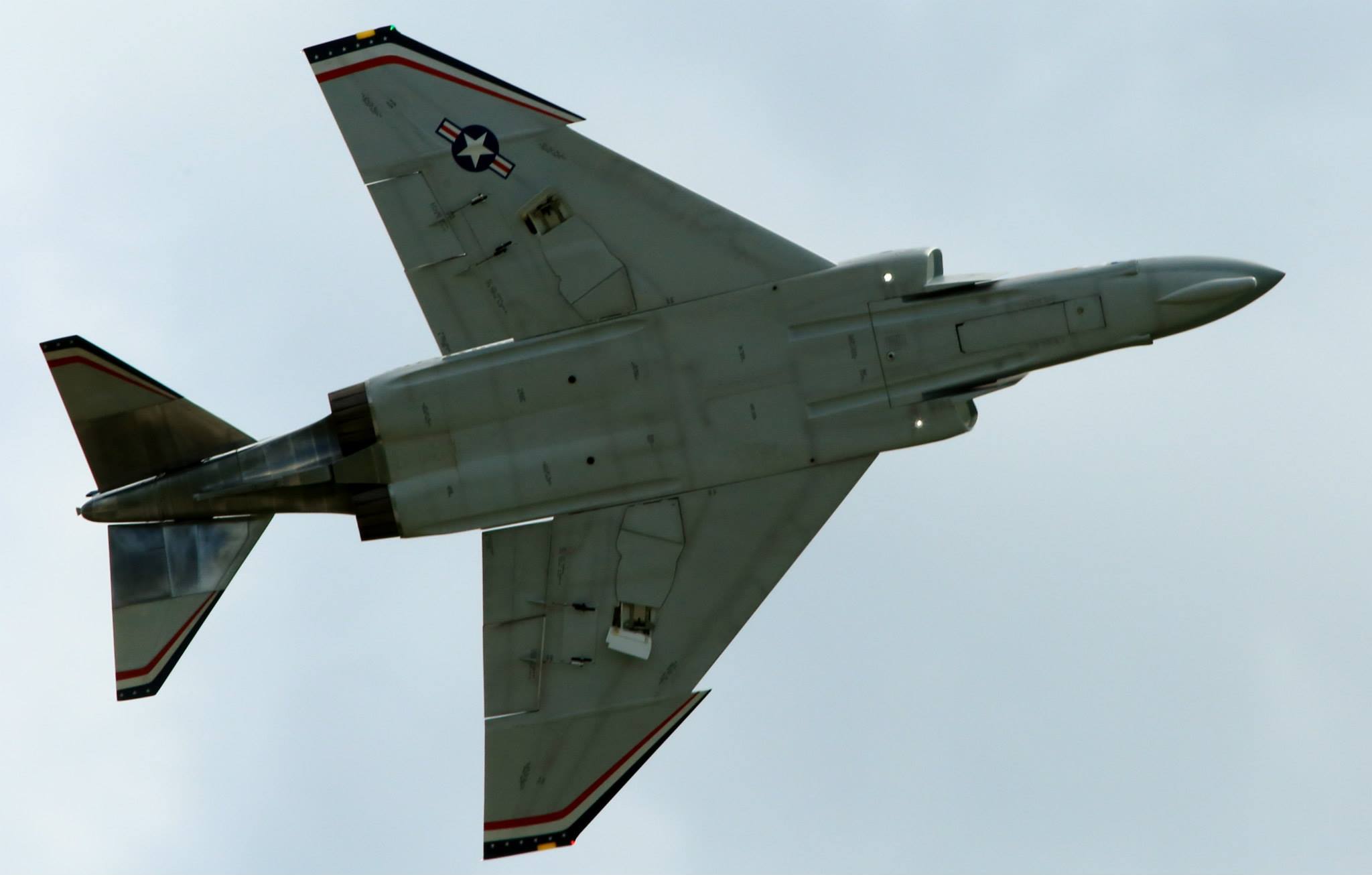

The SM F-4 is very reliable and flies great. I've had two. The first has over 100 flights. The second has one irritating issue and that's the nose door cylinder. It needs to be moved for better leverage. Better to address this before your first flight, otherwise you'll be landing with the nose gear up. If you move the CG to the rear most range you'll have no problems with it.

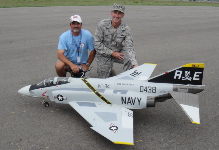

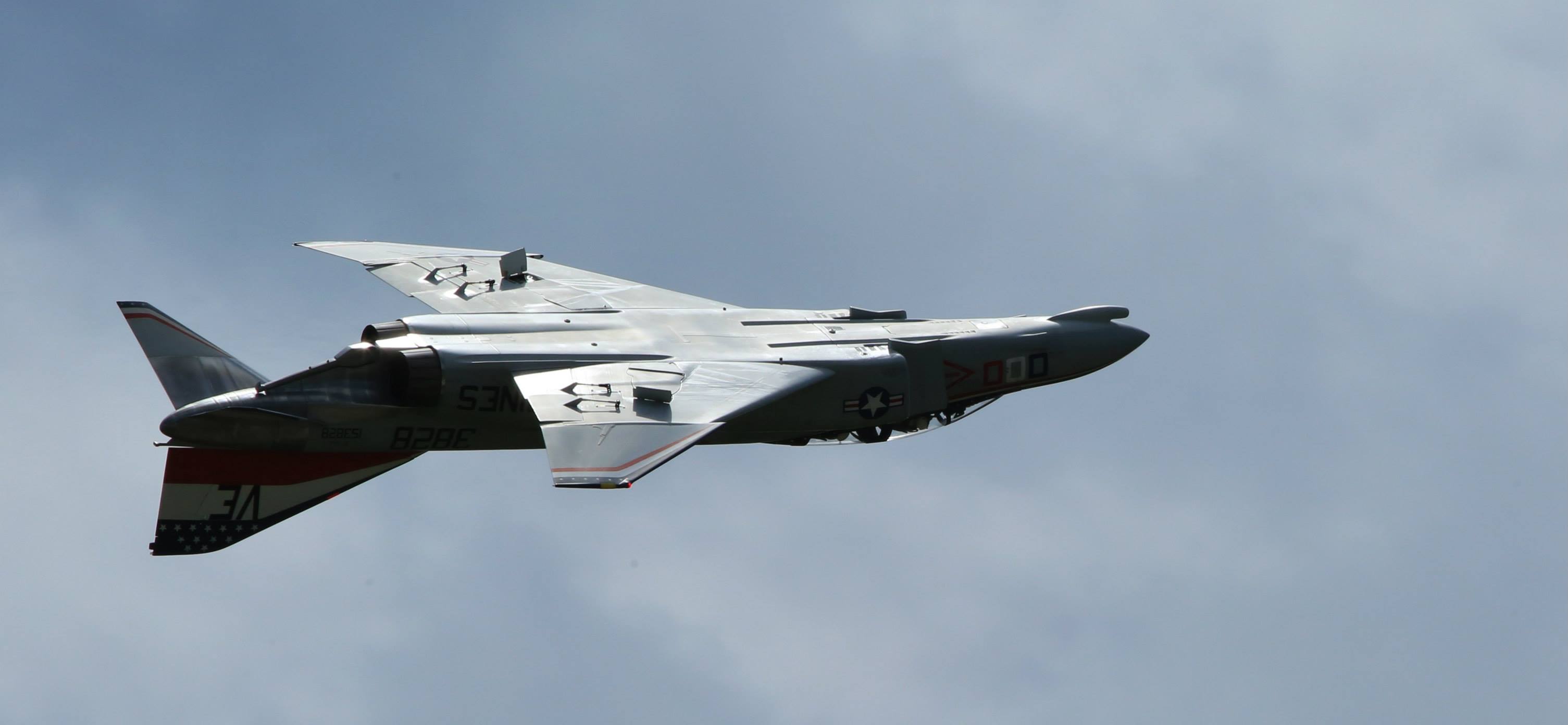

Best jet I've ever flown! A real man's plane!!LOL Sent you a PM regarding the one that failed in contrails.

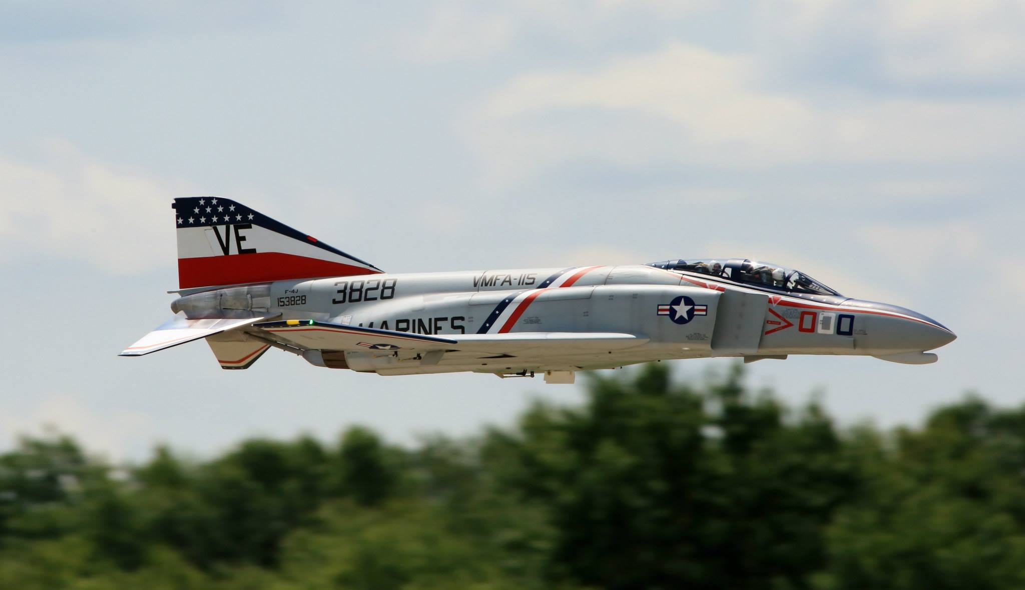

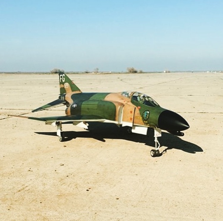

A couple more As you can see ( and a couple of guys mentioned) the small gear doors which are spring loaded will not stay closed in flight. Pat, sent you the PM too. I have a Behotec 190 in it. Also, Tam's bifurcated pipe.
