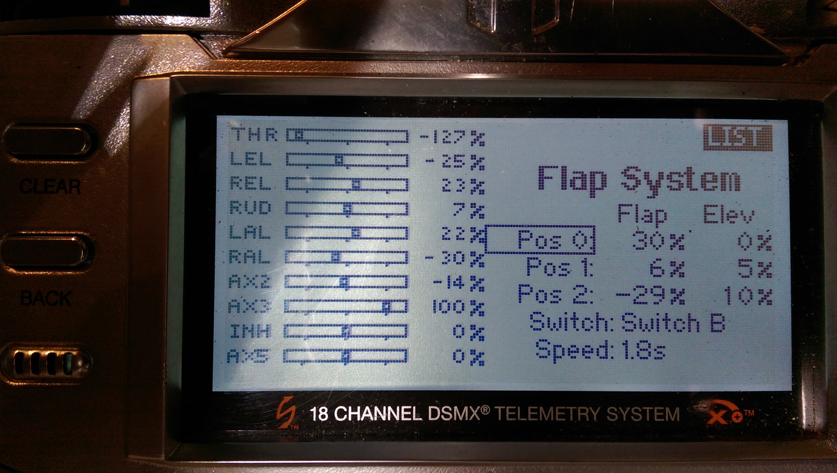

I set it up with an igyro. It has flaps and dual ailerons and dual elevators. All I did was this simple mix. For my flaps I use switch B so change that to what ever you use for flaps. Also have a mix going to gyro gain that increases the gain when flaps are down. I cant remember what settings I had in the Igyro. I think I have tailerons on it but not sure cant remember.

Rex here is a pic of the mix I did on my F15. Its set up same way other then sepperate flaps. This one has a cortex. I prefer the cortex for these setups.

No problem Rex. I don't reduce the ailerons/flaaperons with flaps down since they are what the gyro controls roll with reducing the ailerons/flapperons would make the gyro less effective.
Also if you reduce aileron the gyro won't see your roll commands and when you use the tailerons only the gyro will fight you and not let you roll. I know from experience lol scared the crap out of me.
By increasing or decreasing the 20% in that mix I posted will give you more tailerons movement. I only like them for high alpha and added roll when flapperons are down.
