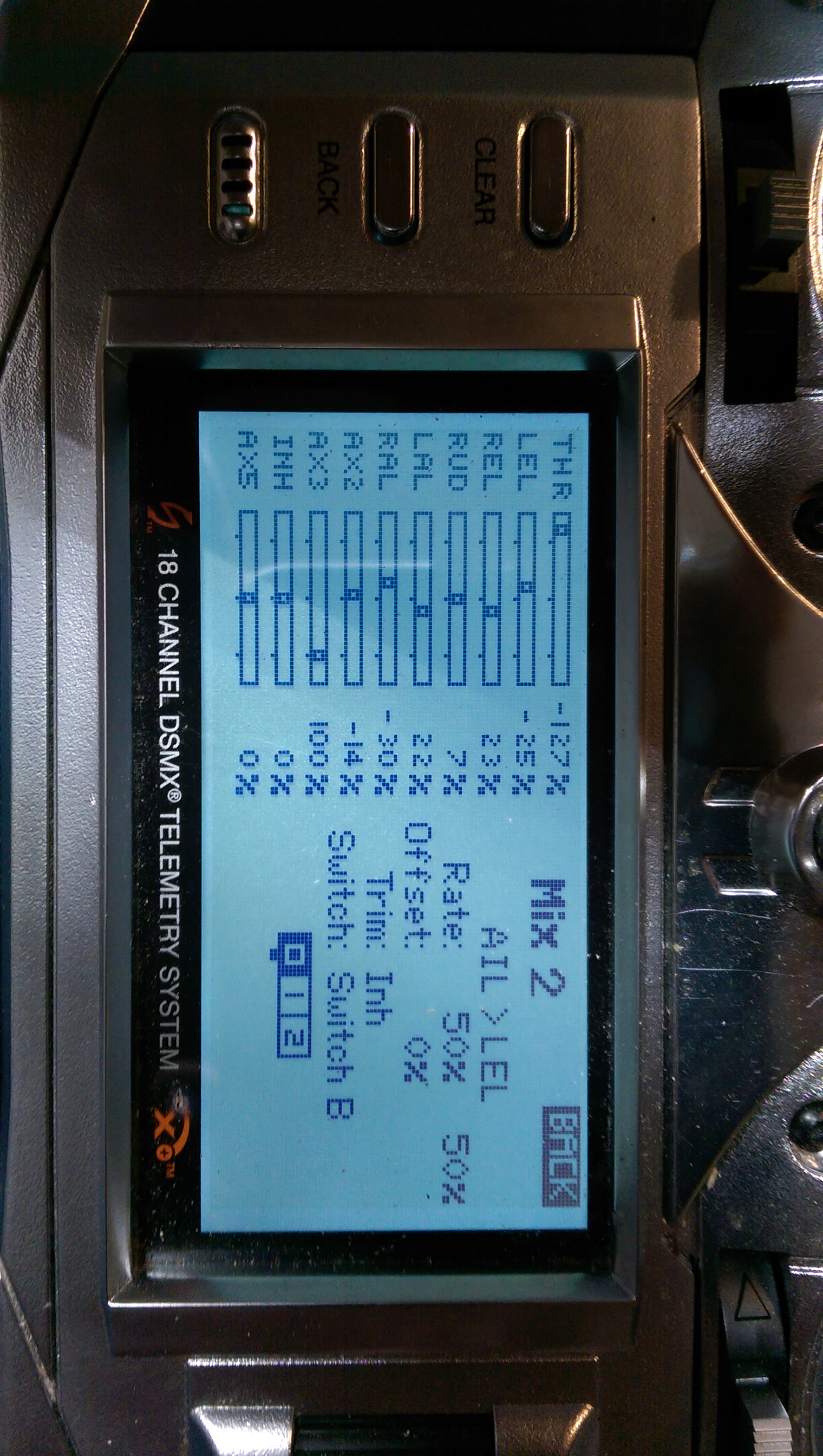

I am setting up a new 1/5 F-16 Skymaster and want to set it up for Flaperons and Elevons. I want to be able to dial down the Flaperon movement during regular flight but keep it in play to "clean up" the Elevons and make the turns more sharp and less "cork screw" as they typically create and higher speeds. Plus I want to do clean segmented rolls.
I have selected Flaperons for the wings and two elevators for the tail. I created another model to work on this, I tried putting "V-Tail B" as the tail and still get no mixed movement between the Flaperons and Elevons.
Is there a way to mix the two elevators (leaving them as elevators) to be Elevons, into the Flaperons?
But scratch all that...what would be the best way to set this bird up for Elevons and Flaperons together? I can start over if need be!!!

Rex I set up a bvm F16 with flapperons and elevons with flaps down the conventional set up with flaps up on a dx18. Is this what you want?

I set it up with an igyro. It has flaps and dual ailerons and dual elevators. All I did was this simple mix. For my flaps I use switch B so change that to what ever you use for flaps. Also have a mix going to gyro gain that increases the gain when flaps are down. I cant remember what settings I had in the Igyro. I think I have tailerons on it but not sure cant remember.

The setup you have should work fine for flaperons. To create elevons, you should be able to mix Aileron to LEL. The DX18 uses that concept of Normal or Back mixes. Normal mixes or mixes to the right side of a control surface cause that surface to move as it normally would. For example both elevator halves would move up or down. A back mix or a mix to the Left Elevator half will cause one elevator to move up and the other to move down. What you need for Elevons is a back mix of Aileron to Left Elevator which depending on your control surface assignments will most likely be RAL (Right Aileron) to LEL (Left Elevator). You can then use a switch to enable or disable the mix and check off the trim box to allow the trim tab to affect the mix or not..
If you want the Cortex to use Elevons, perform the setup procedure with the Elevon mix enabled.
If you don't want the Cortex to use Elevons simpy perform the setup procedure with the Elevon mix disabled..
It will be up to you to decide what flight modes you want which function enabled and whether or not you want the Cortex active in that mode.
Hope this helps.

Rex here is a pic of the mix I did on my F15. Its set up same way other then sepperate flaps. This one has a cortex. I prefer the cortex for these setups.

Wayne, thank you! This is extremely helpful...the normal or back mixing is where I was missing it all. I tried every which way using RAL and REL as my mix channels...and got nada as far as keeping elevators active and still be elevons. Will give this a try. I am just not strong yet on Gyro programming. We have some great guys in our club that are though. I will bounce this off them too as far as using the Gyro as programming.

No problem Rex. I don't reduce the ailerons/flaaperons with flaps down since they are what the gyro controls roll with reducing the ailerons/flapperons would make the gyro less effective.
Also if you reduce aileron the gyro won't see your roll commands and when you use the tailerons only the gyro will fight you and not let you roll. I know from experience lol scared the crap out of me.
By increasing or decreasing the 20% in that mix I posted will give you more tailerons movement. I only like them for high alpha and added roll when flapperons are down.
