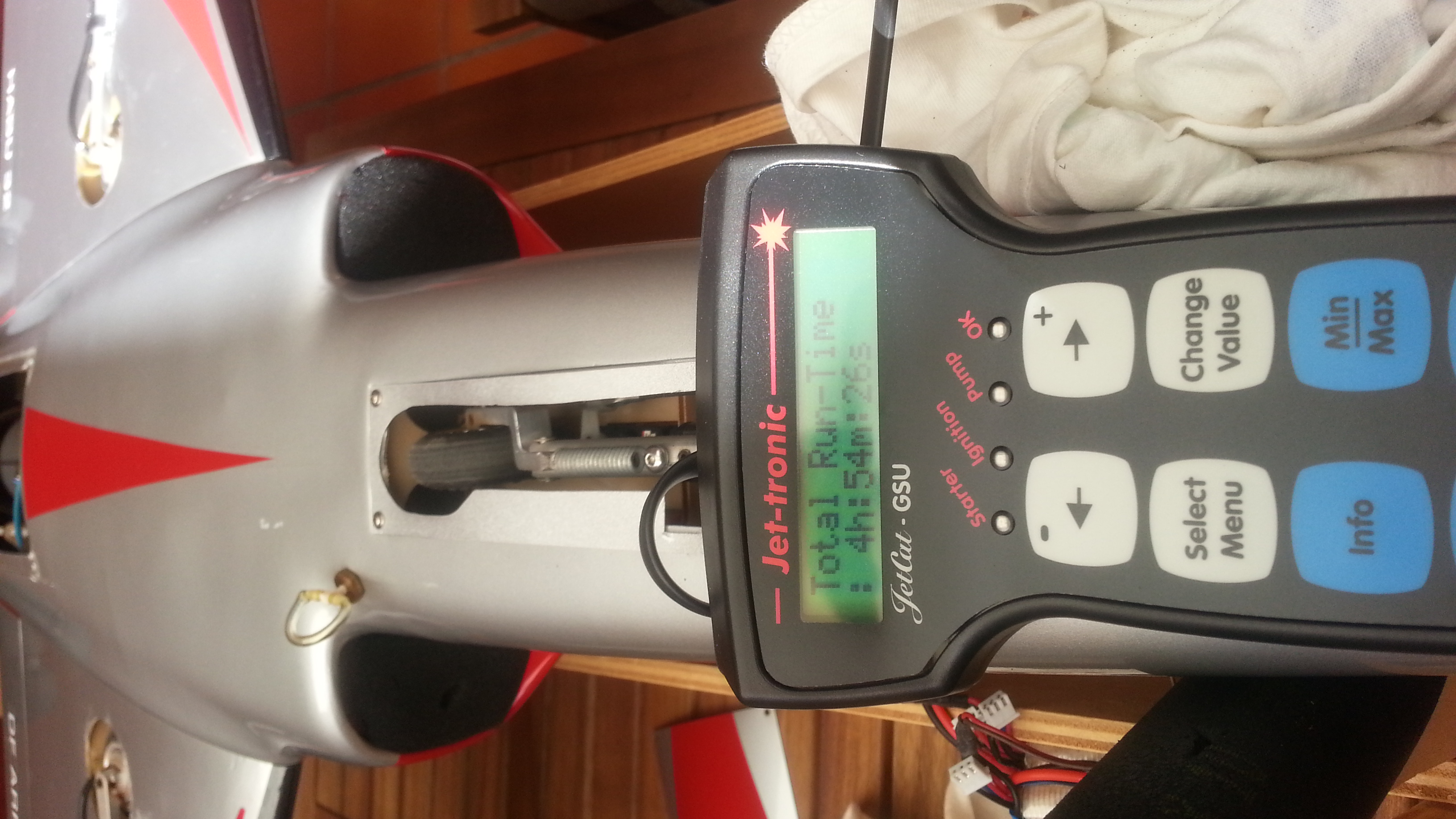

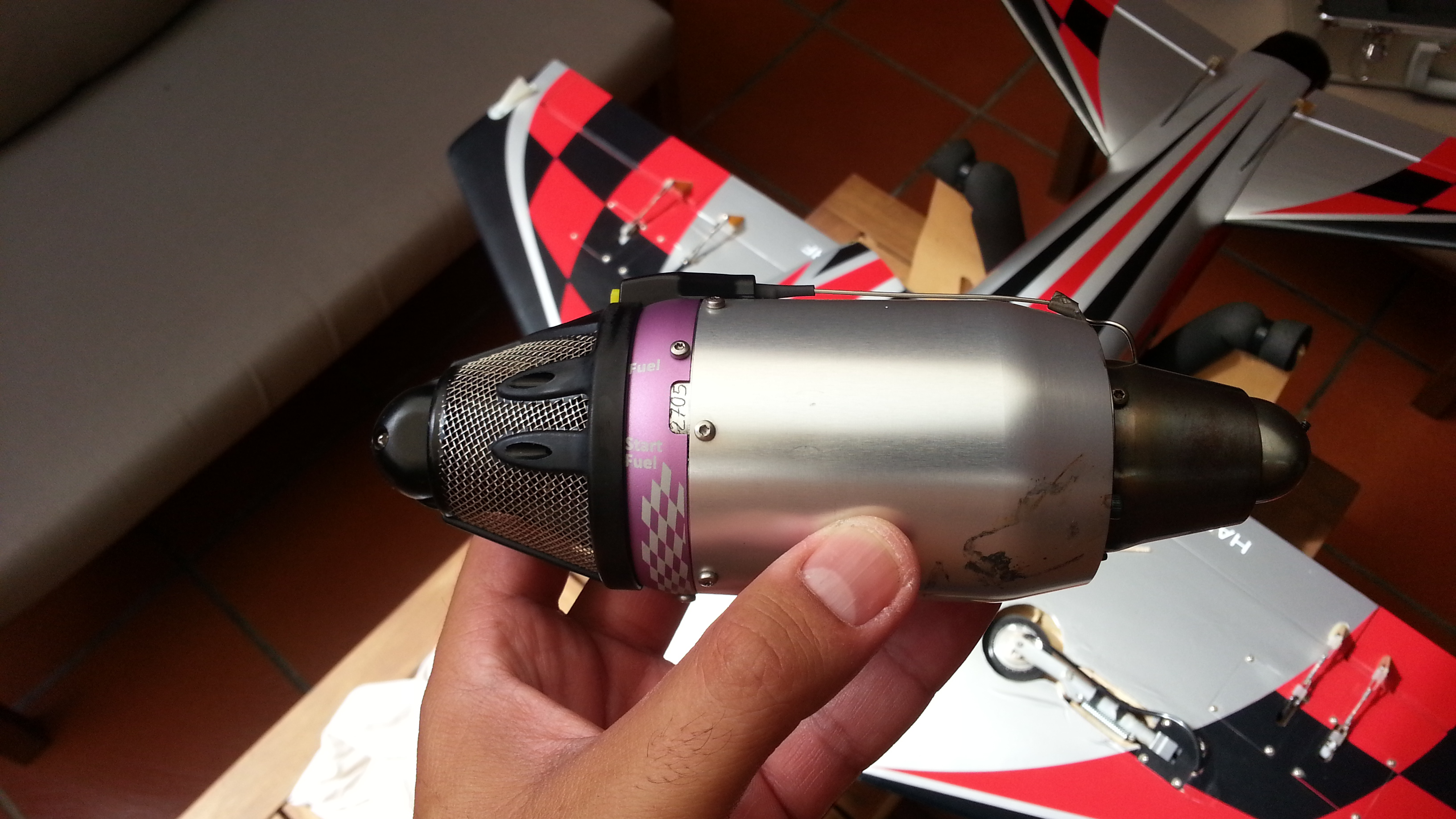

I am going to tell them what is happening to me with the turbines Jetcat a today and in which I am defrauded enough and disappointed by the prestige that I was thinking that I had the brand especially in reliability. First it was my P-20SX, after being in I fly slightly more than three minutes it stopped and with a lot of luck I could land without doing an any scratch to the plane. Not this way the turbine, which dismounted on the back part as vé in the photos that I attach!

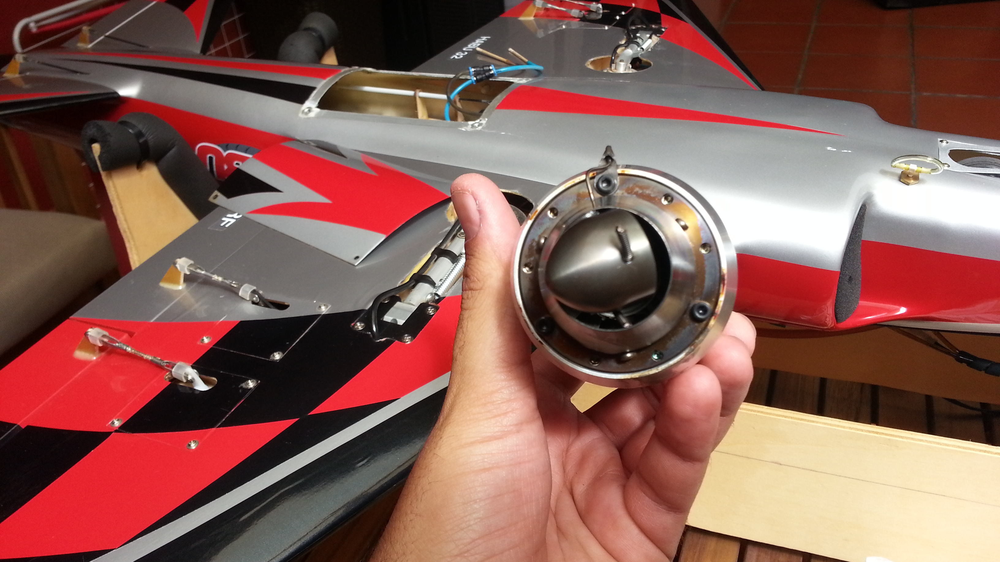

Then immediately afterwards my P100RX, after taking off alone when it was taking approximately 15 meters of height stopped of equal way and of miracle I could land breaking the train and with a small blow in the tail and scratches in the plane. The turbine like enclosure in the photos seems to have been destroyed enough after the stop.
Our track is paved as a road, the fuel that I use and that we use all the members of the club is a paraffin for stove that we buy in a mall, the oil of turbine that I use and use in the club that of the brand is BP and also I use the additive of jetcat antistatically. And to alone today have had problems I and another partner with stops of his turbine but without break of a P-140RX, the only ones that we use Jetcat.
To give more information, I will say that the P-20SX only had 5 hours of use and two years of bought new for me with my invoice and the P-100RX 8 hours and little with three years of bought by new me also with my invoice.

Sorry for your troubles, but I can't understand what problems you are having.
Flameouts after a few hours of use?
JackD 02-11-2016 01:19 PM
So Tenerife is Humid (been there...), was it very hot? hot and humid translates to high density altitude, which not many engines like....

ravill 02-11-2016 02:03 PM
Ah, the pics tell the story.
The compressor blades (on both of your engines) disintegrated?
And since you have pics of a FOD screen, it was not external FOD that caused the failure?
Yup, I'd be "angered" too.
Ruymán 02-11-2016 02:11 PM
Exact Ravill in both turbines I use the Fod as vé in the photos! What strange object did not enter and less still in the air that it were where the stops took place! :(
Dave Wilshere 02-11-2016 02:23 PM
Did you buy both turbines new? Looking at P-20 serial No it looks like a 2013 turbine. When was the P-100Rx made? JetCat offer a 3 year warrantee, I have seen turbines that have only run 2 hours in the 3 years, the warrantee is not hours, its years. Its hard, but they cannot be expected to make the warrantee 4 years or 5 years, just because its not used! Actually I have seen its worse for possible problems little use, bearings can stick with no use, then they slide for the first part of the early re runs...then later bearing failure. Bearing O ring mounts can perish and then like you have the compressor touches.
For sure posting on RCU does little to make them be sympathetic!
No one in this hobby likes anyone in the 'jet family' to have down time and problems, but some things are unavoidable.
