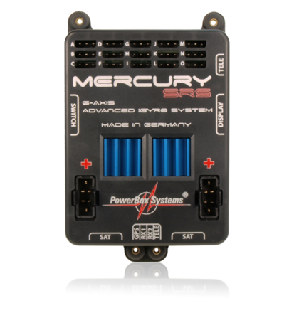

Dave Wilshere 03-04-2016 02:13 AM
New Powerbox Mercury
1 Attachment(s)
http://www.powerbox-systems.com/en/p...rcury-srs.html
This is going to be Jet heaven for installs...
http://www.rcuniverse.com/forum/atta...mentid=2150790
Hertzinator 03-04-2016 03:11 AM
2 questions
how many channels on the door sequencer ?
JR Xbus outtput ??
Mark Vandervelden 03-04-2016 03:42 AM
Spot on :cool:
Dave Wilshere 03-04-2016 03:56 AM
An integral Assistant is also available for setting up the door sequencer. Any modeller who knows how tiresome the adjustment procedure can be with conventional door sequencers will be surprised how quick it can be to set up a retract system including four wheel doors; it takes just a few minutes.
Says 4 doors
Yes, all SRS PB's are Xbus
Dave

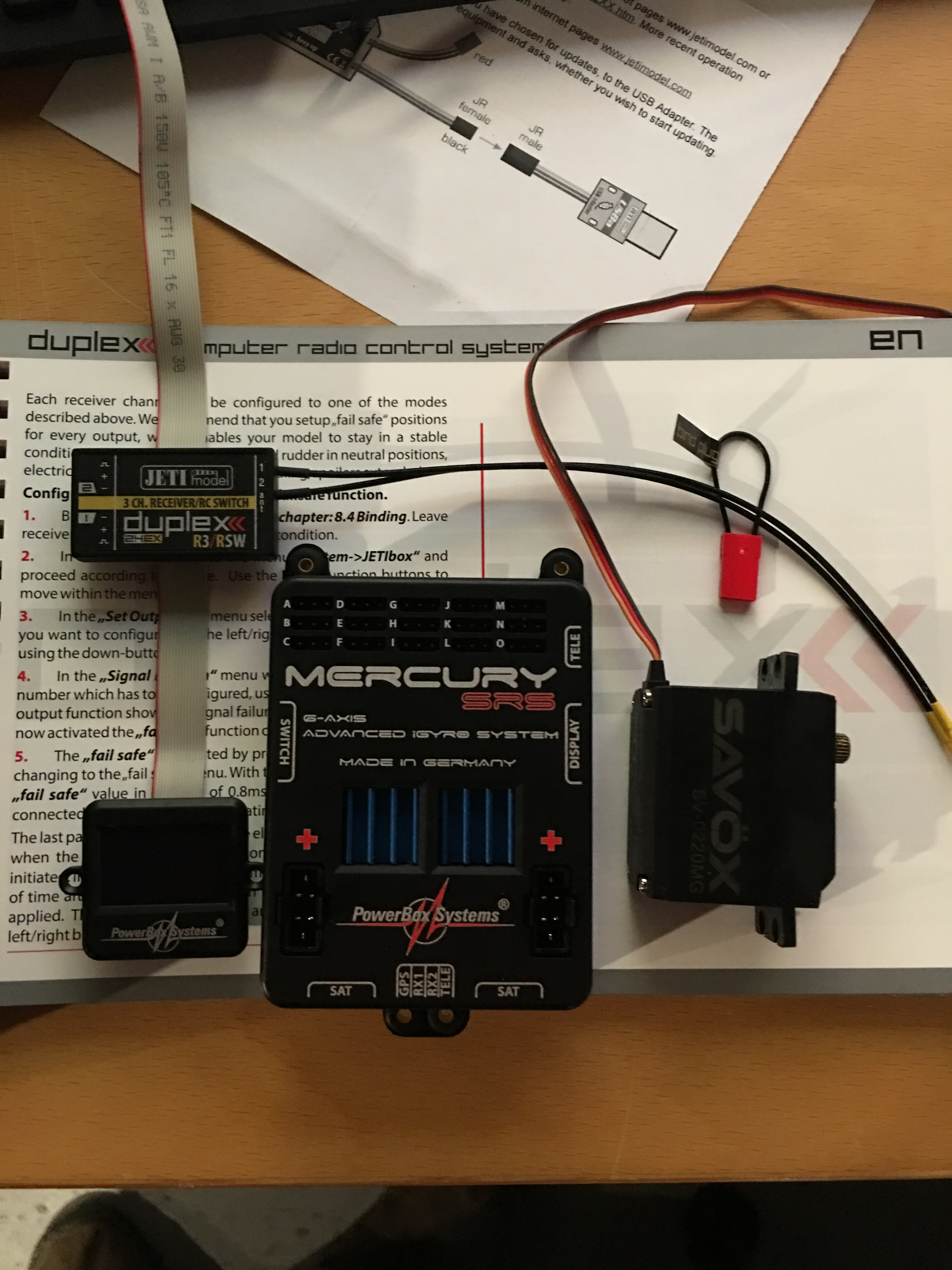

felker14 05-03-2016 05:12 AM
1 Attachment(s)
http://www.rcuniverse.com/forum/atta...mentid=2160638
Showed up yesterday. It's compact for sure. Great for smaller planes. Standard size servo to right.

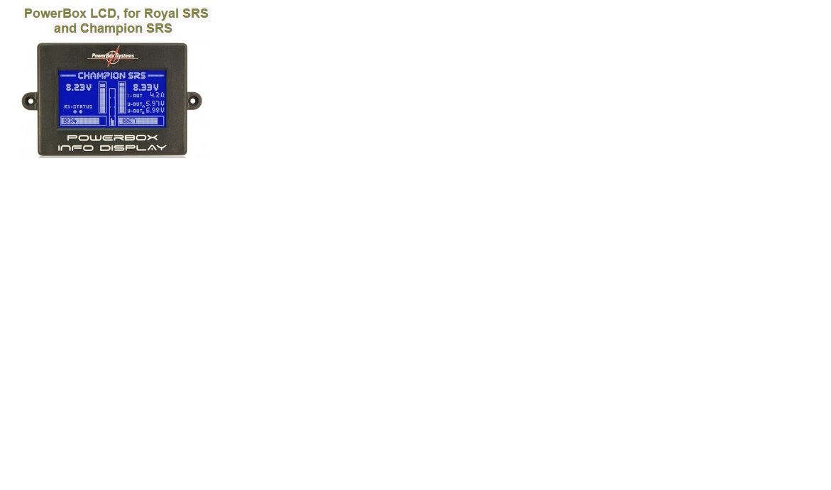

myersflyers 05-03-2016 09:32 AM
1 Attachment(s)
Anyone know if you can use this Powerbox LCD with the MERCURY?
